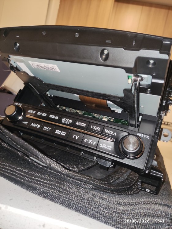

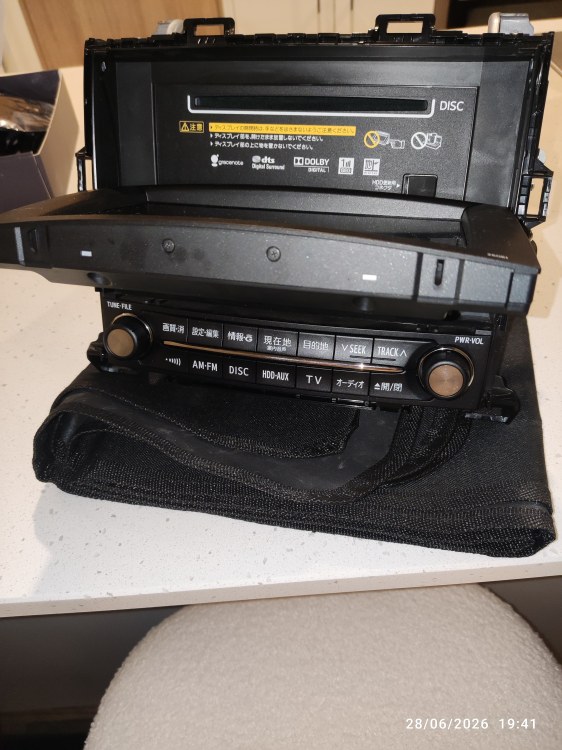

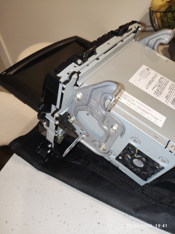

I received the package in good time and now have the head unit removed from the car. The instructions sent to install the ribbon cable don't actually show you how to split the touchscreen and it is showing a different model head unit. So I currently have the head unit/screen removed from the car but I am stuck on what I have to do next in order to remove the screen from the unit and what screws to remove to split it. I just wondered if I post some pictures, whether you may have any advice you could offer Chris? If so it would be much appreciated. Thanks once again for everyones help and hopefully this will help others too.

Good to hear you found them helpful.
I removed the screen by undoing the screws that guide the screen along the runners.
Then just some manual manipulation to get it out of the guide rails mechanism.
Then it's the screws holding the two halves of the screen together.
I will post an image later today, after work.
Once it's open, it starts to become clear where to connect, and then it's routing the new cable ( I'll post photo)

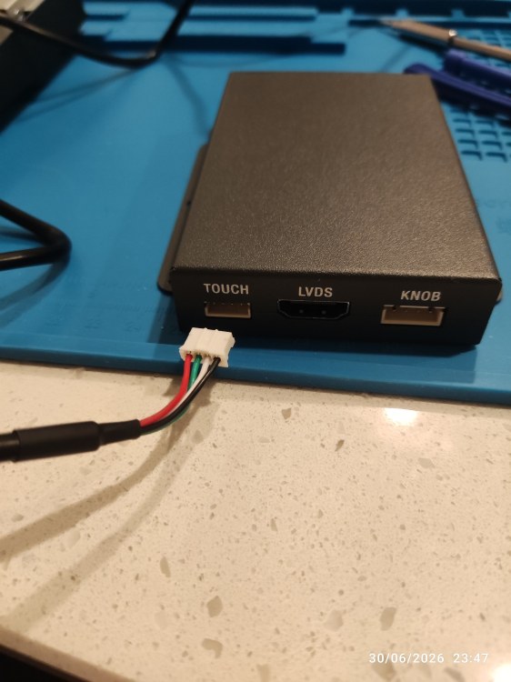

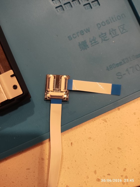

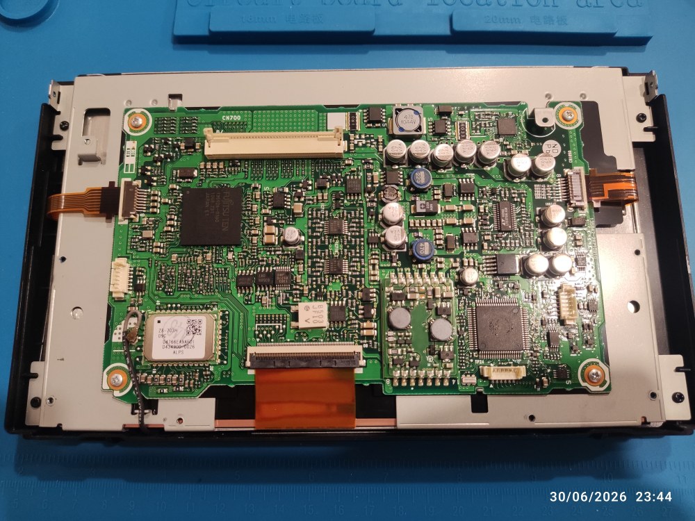

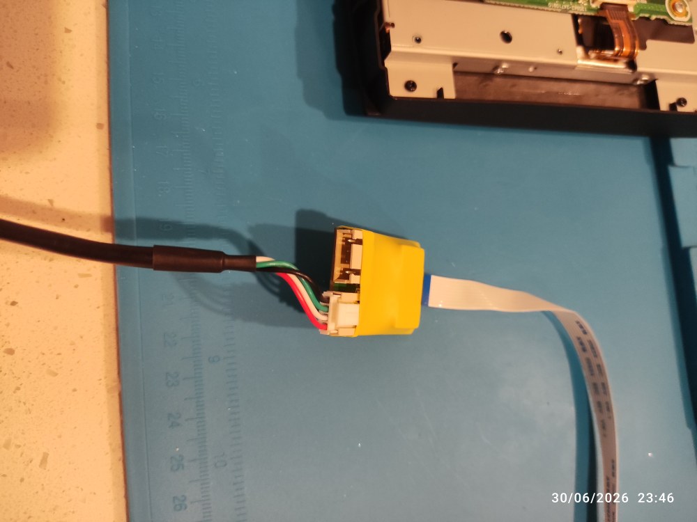

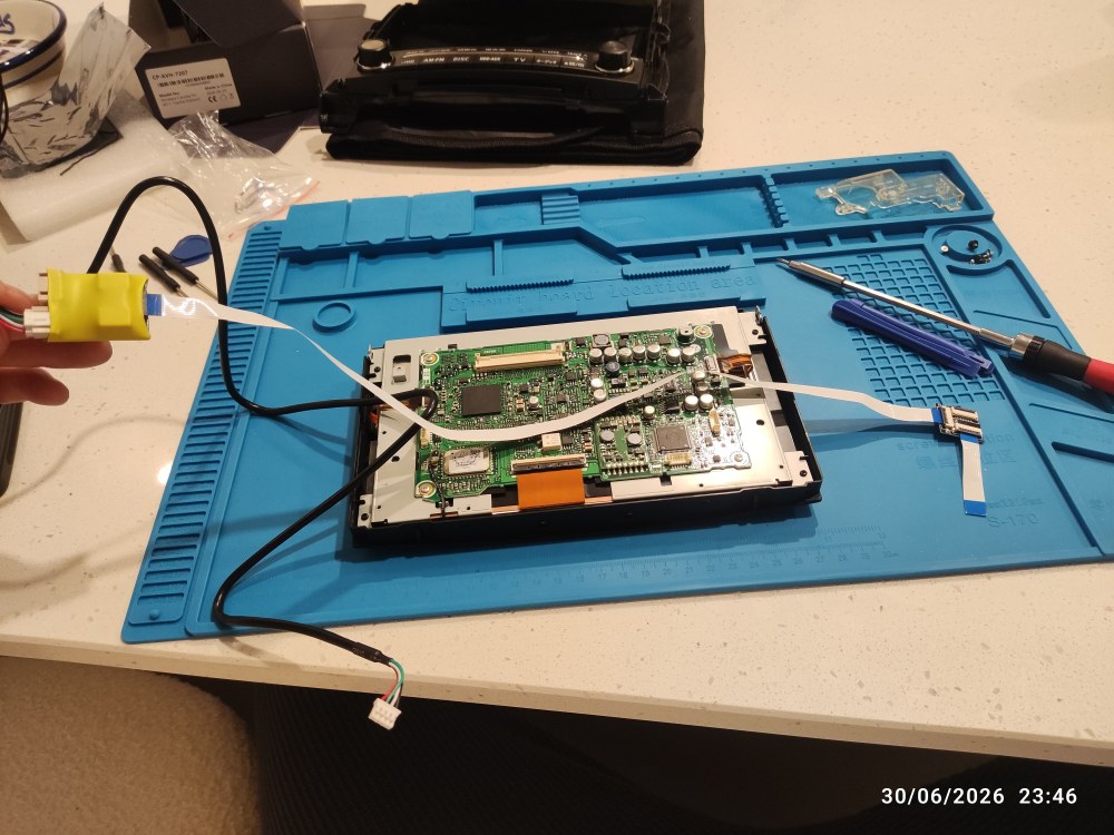

Thanks Chris, I played about and slowly got there with regards to removing the screen. I'm not 100% on how to connect the ribbon cable assembly they have sent me, as the instructions they have sent me appear to be from a slightly different model; however, do show two pictures with one that is meant to be one model and one another. I've attached some pictures as to where I am at!
Not sure if and exactly how I connect it to the small connector on the left of the picture or the right as the document they sent me only has one small connector showing. Also not sure what connection the original ribbon cable has to go in on the small ribbon cable connector they have provided. If it will let me I will upload the document they sent me in case it helps.

One of the onboard flexi goes to the LCD, the other is the touch panel.
I thought I had my electronics screwdrivers on me, but they are at home in Devon.
I believe it's the one on the right of your first image, the one that has pins called TP for touch panel.

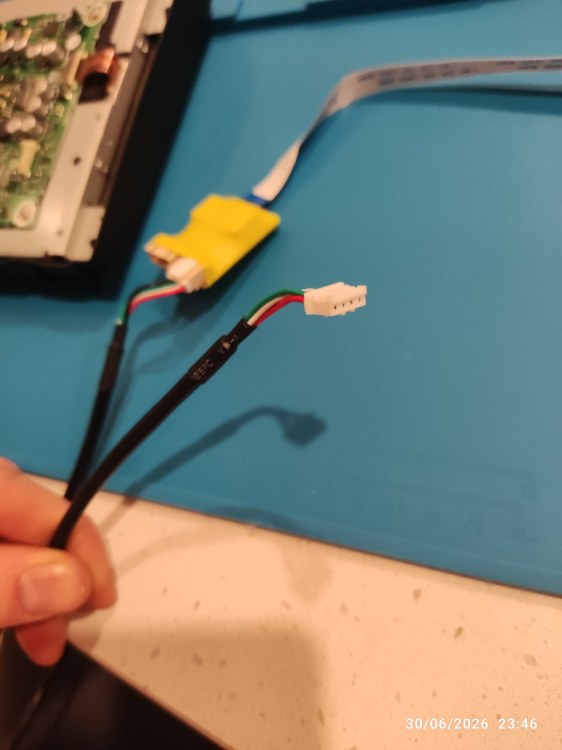

Once again thank you for your help Chris and thanks for uploading some pictures, which help a lot. I'll tackle this and hopefully it all works good. Do you have any idea what the empty female connection on the yellow taped PCB is for? Also the harness that has come with mine has got a usb lead, do you know what this is used for? Can movies or pictures be viewed on the screens from a USB stick or something? I presume people feed that through to the glove box to keep the install neat.
It looks like the setup is that it's a 'man in the middle' of the resistive touch panel. Resistive touch uses 4 wires (X+, X-, Y+, Y-) and it seems like this unit has two sets of 4 wires, one in from the display and one out to the native head unit. That means it can intercept touches when it's showing Android and forward them on when showing a screen from the native head unit. When both are combined on one connector you get 8 wires into the Android unit.
I can't quite work out the wiring from the pictures as to where the 2x4 to 8 combiner is going (is it the small board with top/bottom/left connectors, or the yellow board?) but the empty connector on the yellow board has a different shape, so maybe it's used with a different model of Android unit with different connectors. Often this kind of thing is like a kit of Lego that you build for different vehicles - the bits can often be found on AliExpress as generic adapter boards. Often they include various connectors of different sizes in parallel and you just connect the one you have.
(That was a long way of saying I don't know, but could probably work it out with some clearer pictures. Anyhow, I don't think it's important)
Yeah the extra connector on the PCB is because some head units have a different size Flexi.
The usb is for removable media if you are using the video or MP3 player instead of the carplay
