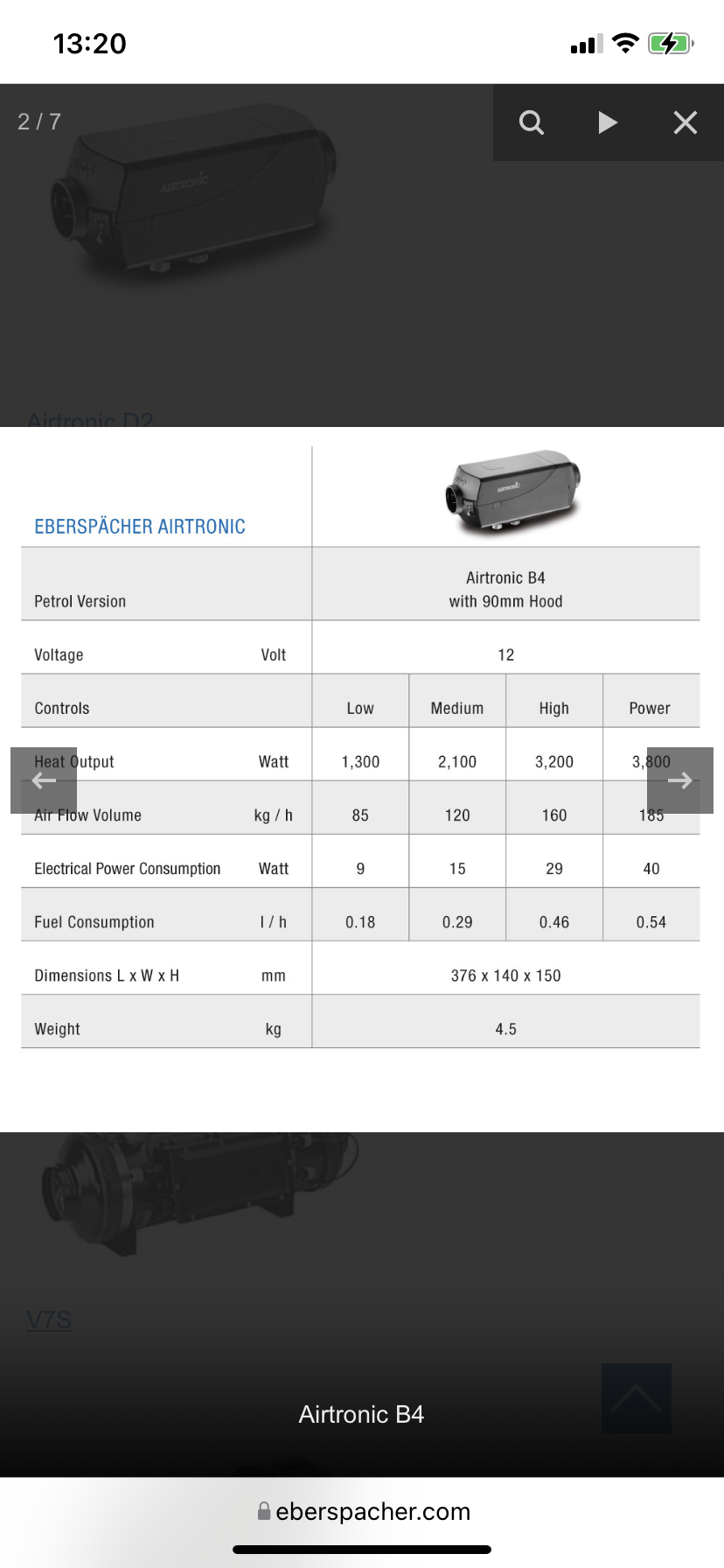

On 1/29/2022 at 7:15 PM, Nick the wanderer said:
Thanks but I will give them a call their blerb only talk's about diesel not petrol.
Yes, they definitely do petrol versions, I used to have a petrol one in my old petrol campervan. You need to poke around the website, see below as an example. Remember petrol is still very common and popular combustion engine in many markets even for bigger vehicles/vans so these things do exist but you might need to
import or make a special order with uk
importer. Good luck.
