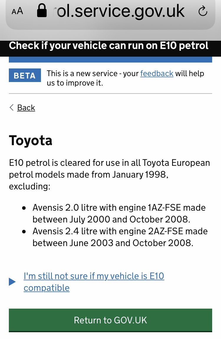

Been running my 2005 2.4 on 95 RON with no problems. It has the 2AZ-FE engine as used in the Avensis and Rav4, shown on the Gov.uk website as OK with E10 petrol (not the 2AZ-FSE which isn’t compatible with E10). I'm in agreement with wjvf, fill up and trust the robustness of Toyota engines.

Government web site says the new fuel is ok for Alphards (so im told )
But it stipulates European Alphards are ok.
Mine is a Jap import, So no government advise for me then 😞
