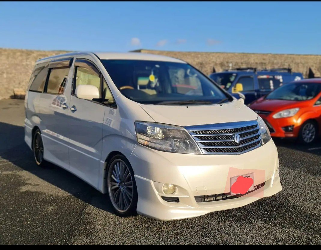

I am adding a photo, i dont think this is not the facelift
The largest external difference between Gen1 and Gen 1 facelift, as far as I am aware, is the rear light clusters.

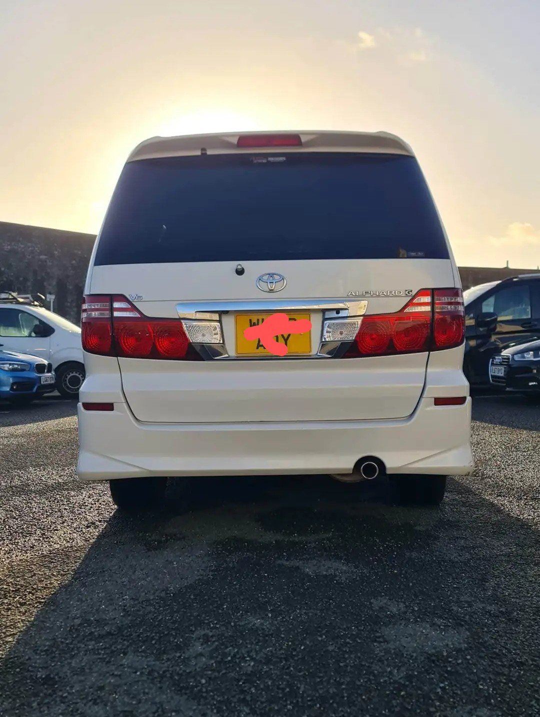

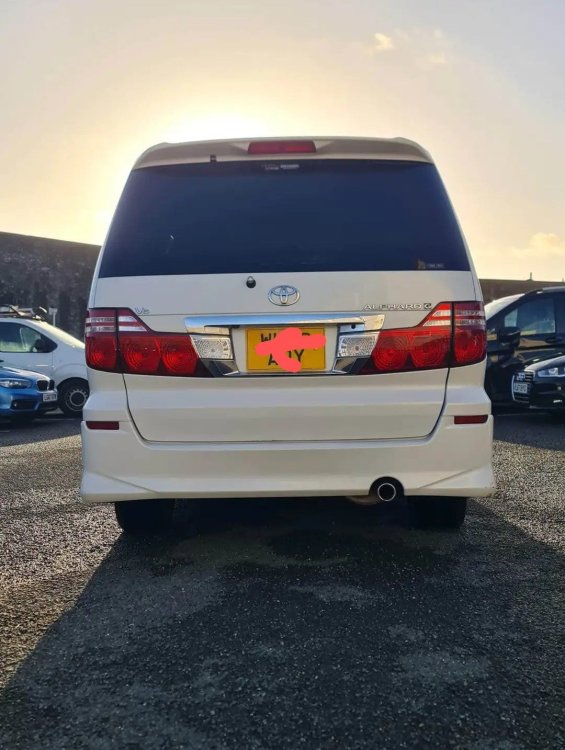

Do you have a photo of the rear ?
Thisnis the rear
Just now, Rojie said:
Facelifted.
How did you see it? I saw that there is front wing mirror too
The rear lights cluster is larger than on the pre-facelift.
Yep - same light clusters as my facelifted one, though you seem to be missing the dual cameras in the front grill (not that they are of any use 🙂 and the rear wiper.
