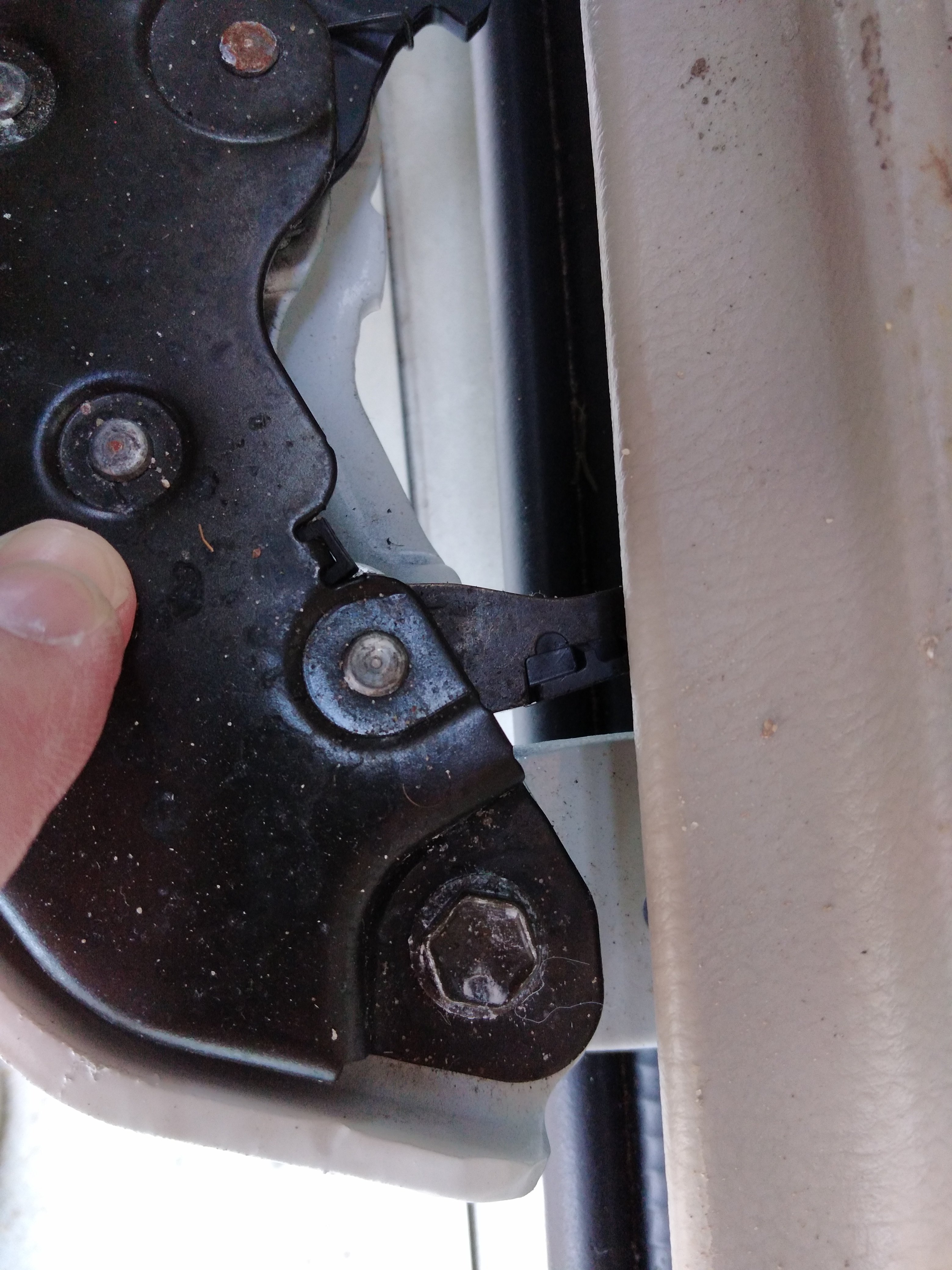

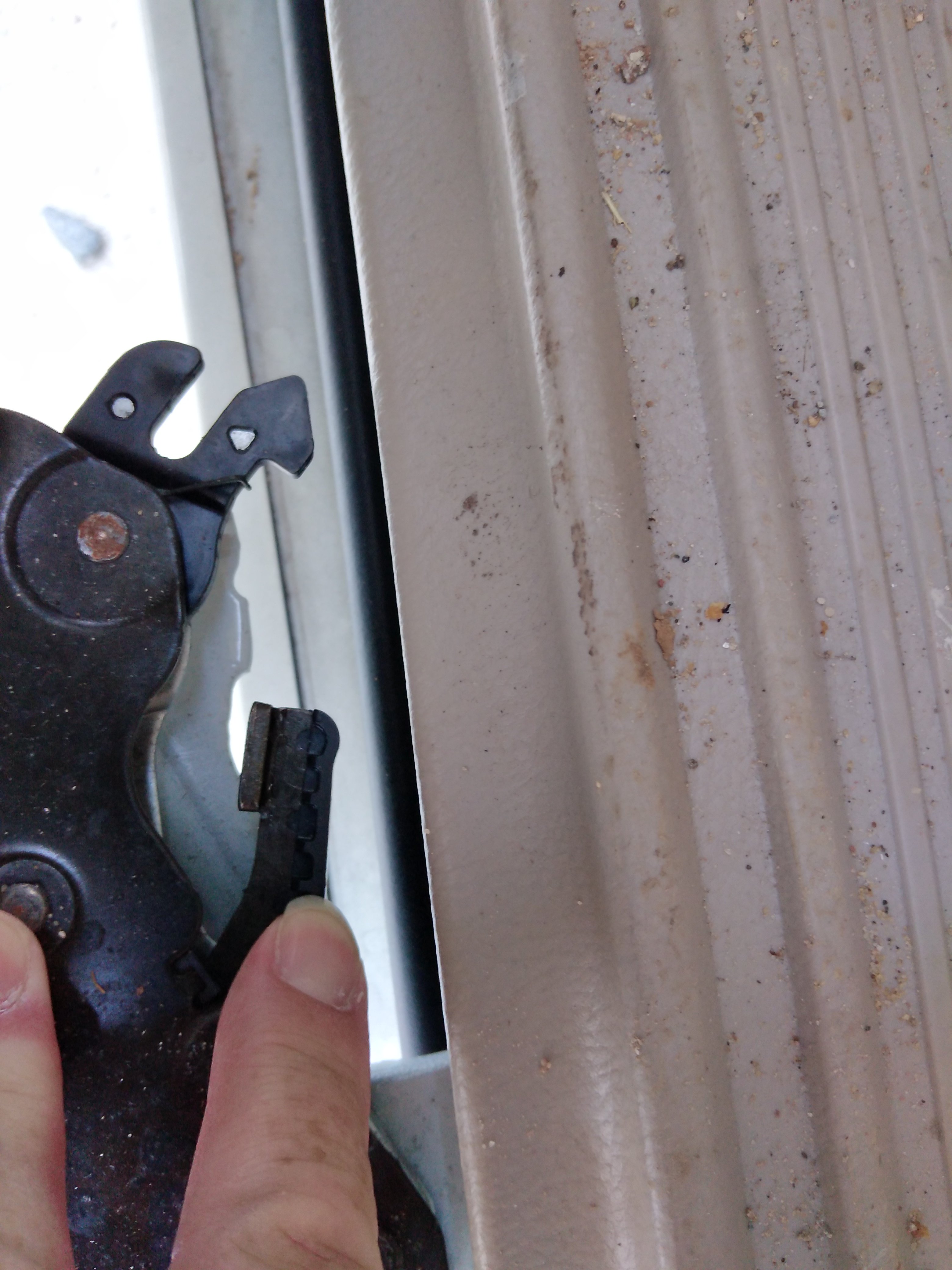

Mike Matts Posted October 3, 2022 Posted October 3, 2022 hi folks has anyone noticed that if the side door windows are open the door opening is restricted not opening fully Mike
Rojie Posted October 3, 2022 Posted October 3, 2022 52 minutes ago, Mike Matts said: hi folks has anyone noticed that if the side door windows are open the door opening is restricted not opening fully Mike Hi Mike, How far do they open ? I am wondering if this is some safety feature. I'll check mine asap; and let you know.
MonsterS Posted October 3, 2022 Posted October 3, 2022 Yes, it's a safety feature. to stop children getting their head stuck in the door.
Mickw Posted October 3, 2022 Posted October 3, 2022 3 hours ago, Mike Matts said: hi folks has anyone noticed that if the side door windows are open the door opening is restricted not opening fully Mike Yes they don't open fully if rear window down past a certain point, it's a safety feature so kids can't get out from back seats when door open, hope that helps
Bob Williams Posted October 3, 2022 Posted October 3, 2022 Hi Mike it is a safety feature, this little lever comes out to stop the door opening. you can over ride by holding it in and push the door all the way open 1 1

dezufo Posted October 4, 2022 Posted October 4, 2022 On 10/3/2022 at 11:35 AM, Mike Matts said: hi folks has anyone noticed that if the side door windows are open the door opening is restricted not opening fully Mike As has been said it is a safety feature also if the fuel flap is open it stops the passenger side door from opening fully 2

Wai Ho Posted October 9, 2022 Posted October 9, 2022 On 10/3/2022 at 6:12 PM, Bob Williams said: Hi Mike it is a safety feature, this little lever comes out to stop the door opening. you can over ride by holding it in and push the door all the way open Thank you Bob for the pictures, It will come in useful. 1
