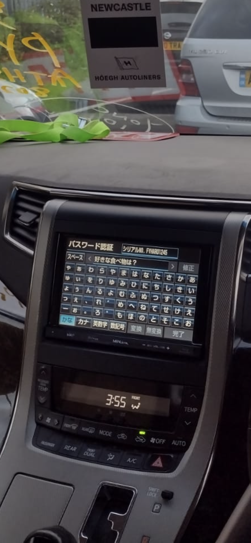

1/Can English language be displayed instead of Japanese ? If so how is it done ?
2/ Does the Nav work in Britain?
3/ My rear camera is currently not displaying on screen when car in reverse. I have read somewhere that the camera should show on the screen,even if nothing else can be achieved, such as the radio and Nav ect ?
4/ Are there any audio garages familiar with these sorts of problems associated with Japanese imported cars? I live in the North of England
Any help much appreciated
I have a very similar radio to yours (NHZN-X62G). Not sure what the difference is, but based on that…
1) No. Use Google Translate on your phone to work out what’s going on.
2) No, it will think you’re in open water. You won’t find map updates for these HDD models online.
3) It will work once you unlock the radio. Check out the thread I linked to in the other thread. You need to reset the unlock code by generating another unlock code, either by using a generator app or by sending £15 to a guy in Malaysia who will (genuinely!) generate a reset code for you.
4) The normal recommendation is a guy called Ben Hau in Birmingham. He can add a CarPlay/Android Auto option to your radio. Or you can replace it with a whole new unit. Both will cost £300-400.

Thanks again for the advice. It’s helped to know that once the screen is unlocked the camera probably works.
Are you sure there isn’t an option somewhere on the unit menu settings to select English language?
I will try to progress with the link and code you gave me
Do you have the contact details for the guy in Malaysia ? Couldn’t help laughing as I wrote this. I feel like it’s chasing the enigma code 😃
Yeah it can feel a lot like that sometimes :D
No, there's no option to switch to English on mine. As i understand it, the option to switch languages was only for export cars (Malaysia/Russia), not JDM cars. Looking at youtube videos for other JDM Toyotas, I think that around 2014 they got language options, but mine's 2012.
This is how you get to the ERC code menu. Hold the map button while flashing the car lights a few times.
When you get to the right option it will show you a code (which sometimes changes, I'm not sure how often) and a keypad underneath. You need THAT code to generate a correct ERC code.
So to generate the code either you can try this app that that threepot posted here...
...or contact Shareef at http://www.navigationdiskjp.com. His WhatsApp details are on the site. He'll ask for the radio model and that code that was displayed on the ERC page of the radio. He sent me a paypal invoice for £15 and he sent me the code a couple of minutes after I paid it (I didn't know about the app at the time). I entered the code on the ERC page and the radio was unlocked.
After unlocking, the radio resets and goes through a setup stage. I really recommend getting Google Translate on your phone so you can see what's going on. If you don't complete setup properly it will prompt you again the next time you start the car. Make sure you set your password to something you remember or you'll have to do it all over again.

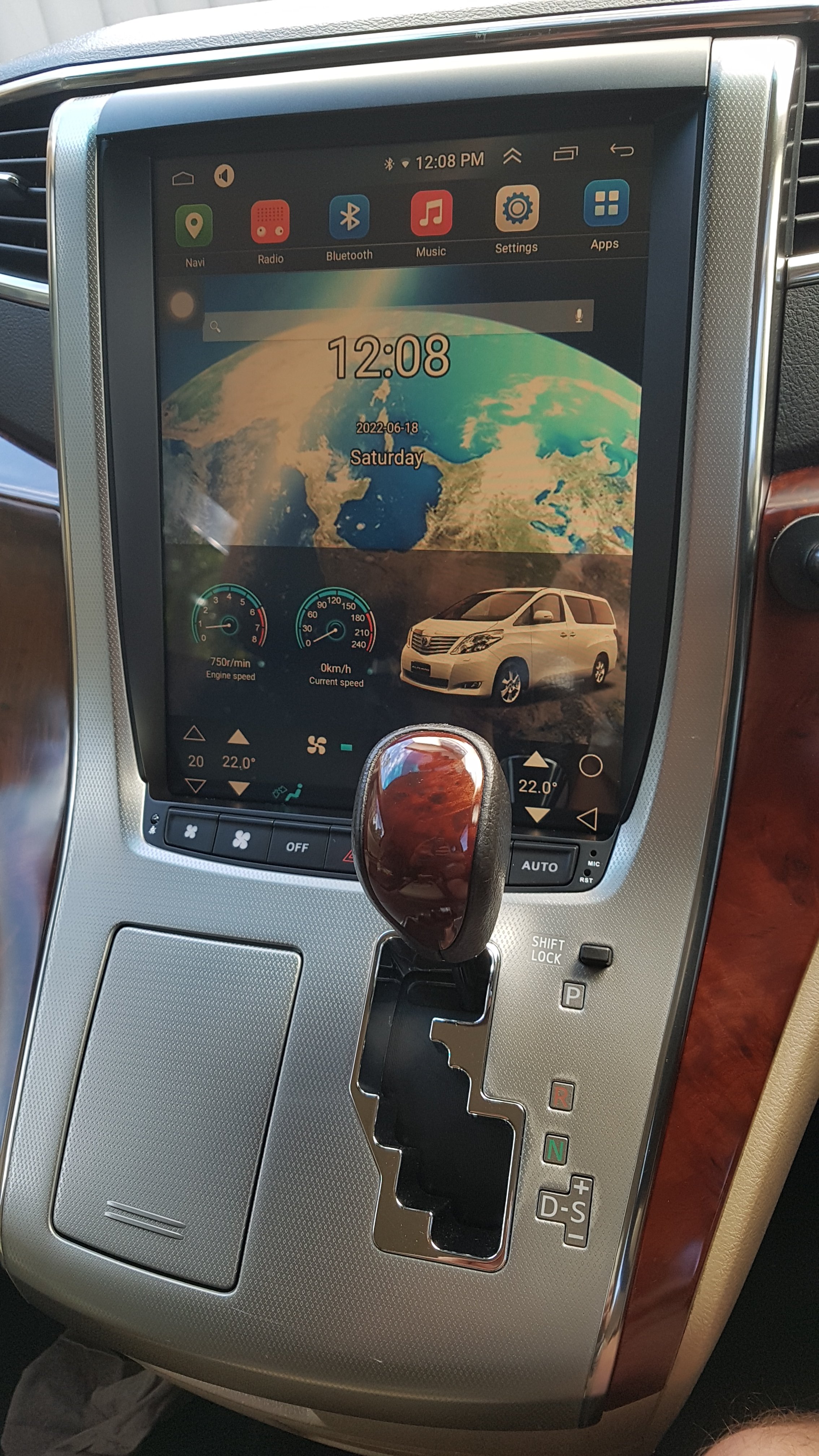

I have been there and tried everything. Nothing but dead ends so I bought a 12.1 inch Tesla style head unit from Ali Express with 128gb of ram. It replaces both the standard unit along with the A/C controls. It's not as complicated to install as you might expect. I did it myself and when I ran into problems, the factory engineer helped me via WhatsApp and it works great. It has a proper GPS antenna and a sim card slot so you can essentially use it as you would a Tablet and it has 2 WiFi antennas so your passengers can connect to it too. Cost about $900 AUD inc postage.
That looks a great system.
What model is your Alphard? Mine is 2012 Hybrid. I think the head unit set up is different to yours. Maybe I can get away with just swapping the top half as there looks to be a split between heating and radio/ Nav ?
Mine is a 2009 20 series. I think they're the same.

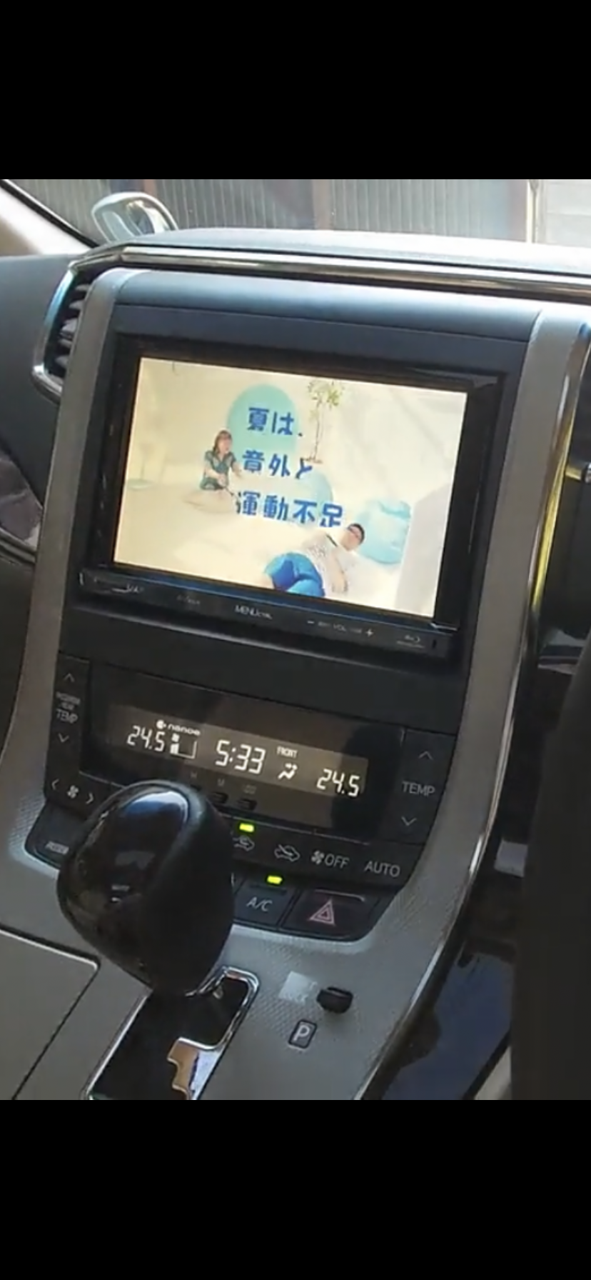

The biggest thing that is stopping me from getting a replacement radio is that I have a roof monitor, and I haven't found a replacement that allows me to show GPS navigation in the front and play a movie in the back at the same time while driving. It's always mirroring exactly what's on the screen in front. The "Ben Hau" carplay retrofit doesn't allow that either, as far as I can tell.
The OEM unit does do that. Although the inbuilt navgation doesn't work, I do have a different display on in the front and can also control volume and stop the movie if I need to. The kids love having a cinema in the back on a long trip.
It sounds like it’s either one way or the other🧐. I can see why you would want the kids watching the DVD whilst your driving following the Sat Nav screen in the front. I’ll be a bit happier when I get the reverse camera and the only radio station, Radio 2😄
Then I’ll be back on to you to find out where the DVD slot is 😄
