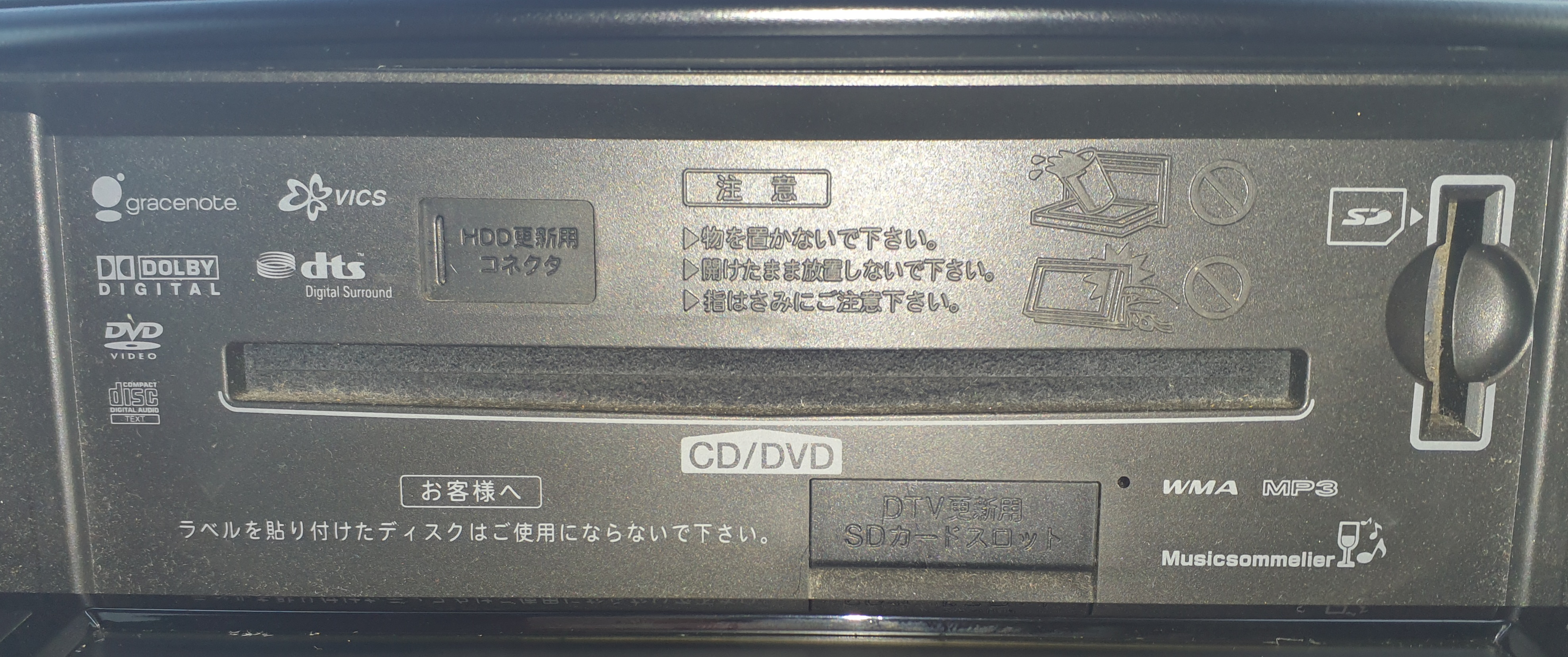

Hello all,
See if i can get any info on this question.

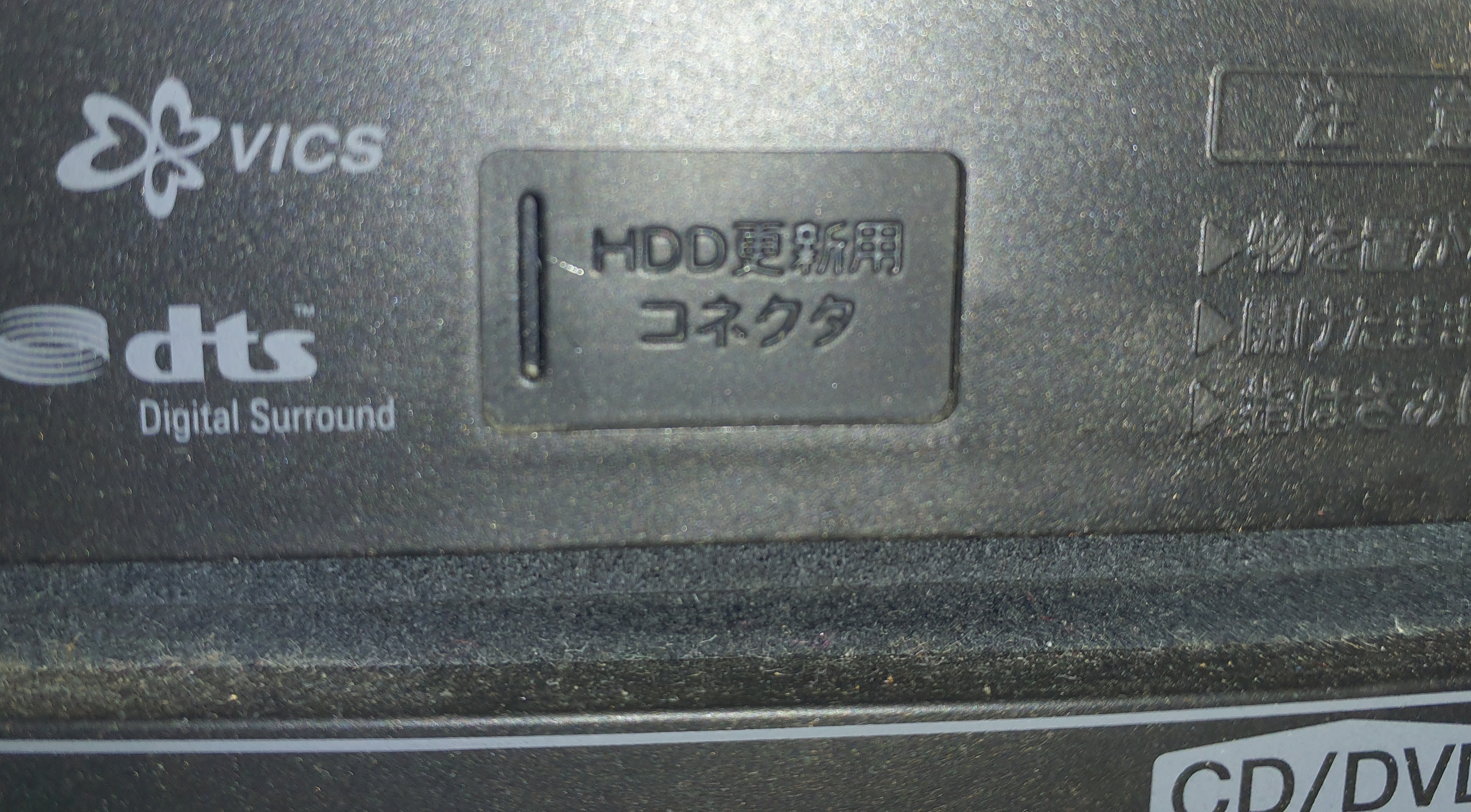

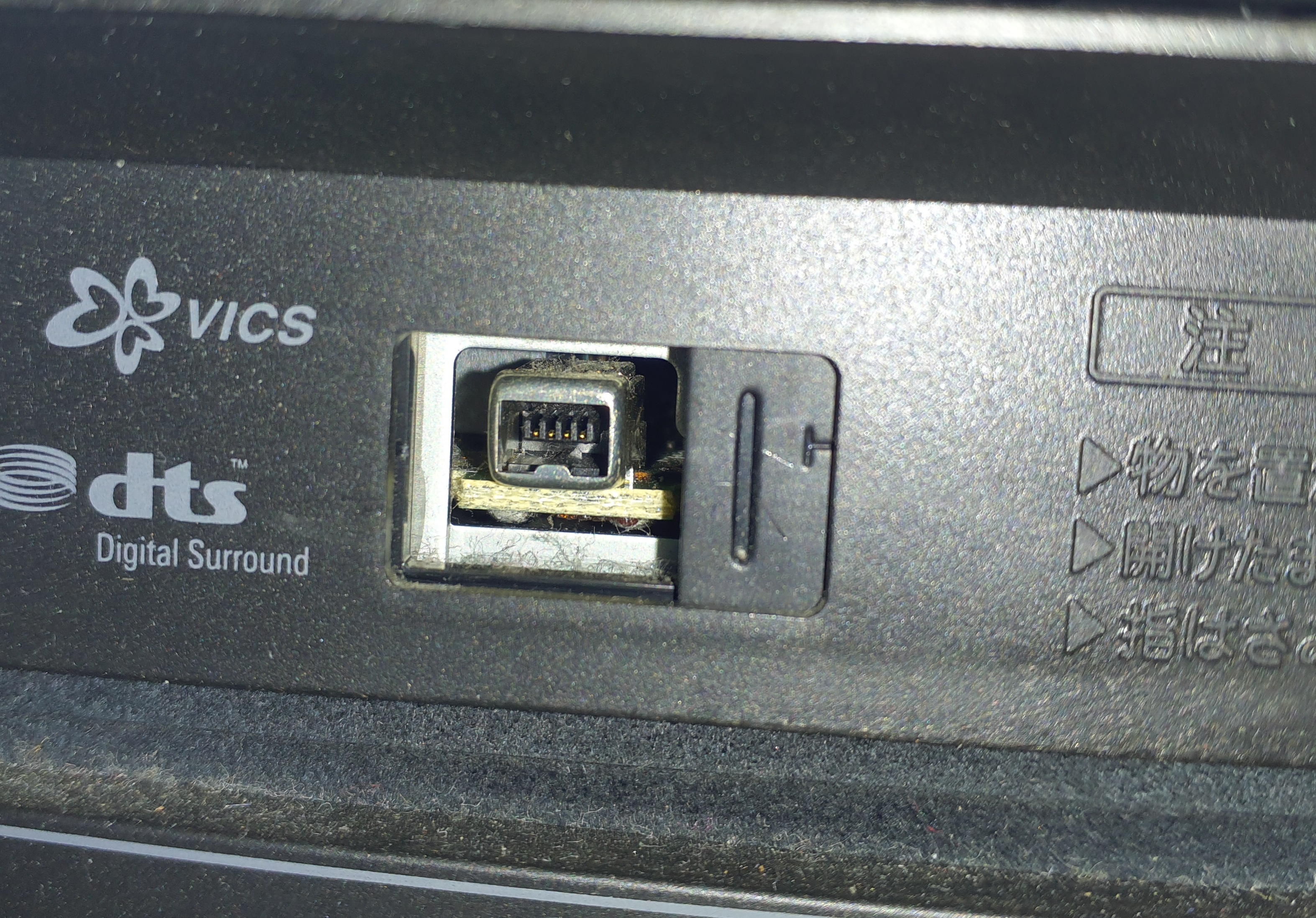

Behind the head unit front facia there is a HDD with a firewire 400 / 4 pin socket.
After much research I bought the firewire to firewire cable.
Firewire socket on the head unit connect to firewire on the laptop.
Also tried firewire socket on head unit to thunderbolt/firewire adapter to macbook thunderbolt.
Tried the Mac Osx desktop and the Windows desktop environments.
(Firewire to usb cables are a con they don't work)
Turned the ignition on to power up head unit (Panasonic nhzn w57)
Can anyone tell me is there is a software program that will recognise the head unit HDD and show it on the computer desktop, like an external drive?

You can't, I've been through the coding on this unit. It's just for firmware upgrades within the OS of the head unit. You can't actually download anything on the hard disk. I feel your pain I was trying to get hold of Toyota Japan and see if i can get the base code for the unit so I can alter it for the UK market. However they won't let saying its protected software. The only way is to remove the hard drive from the unit itself and jack it directly into a pc.

If you press the menu button one next to open and turn lights on three time a menu comes up and one of the pages is IEEE menu if you use google translate it’s the read, download, upload menu
