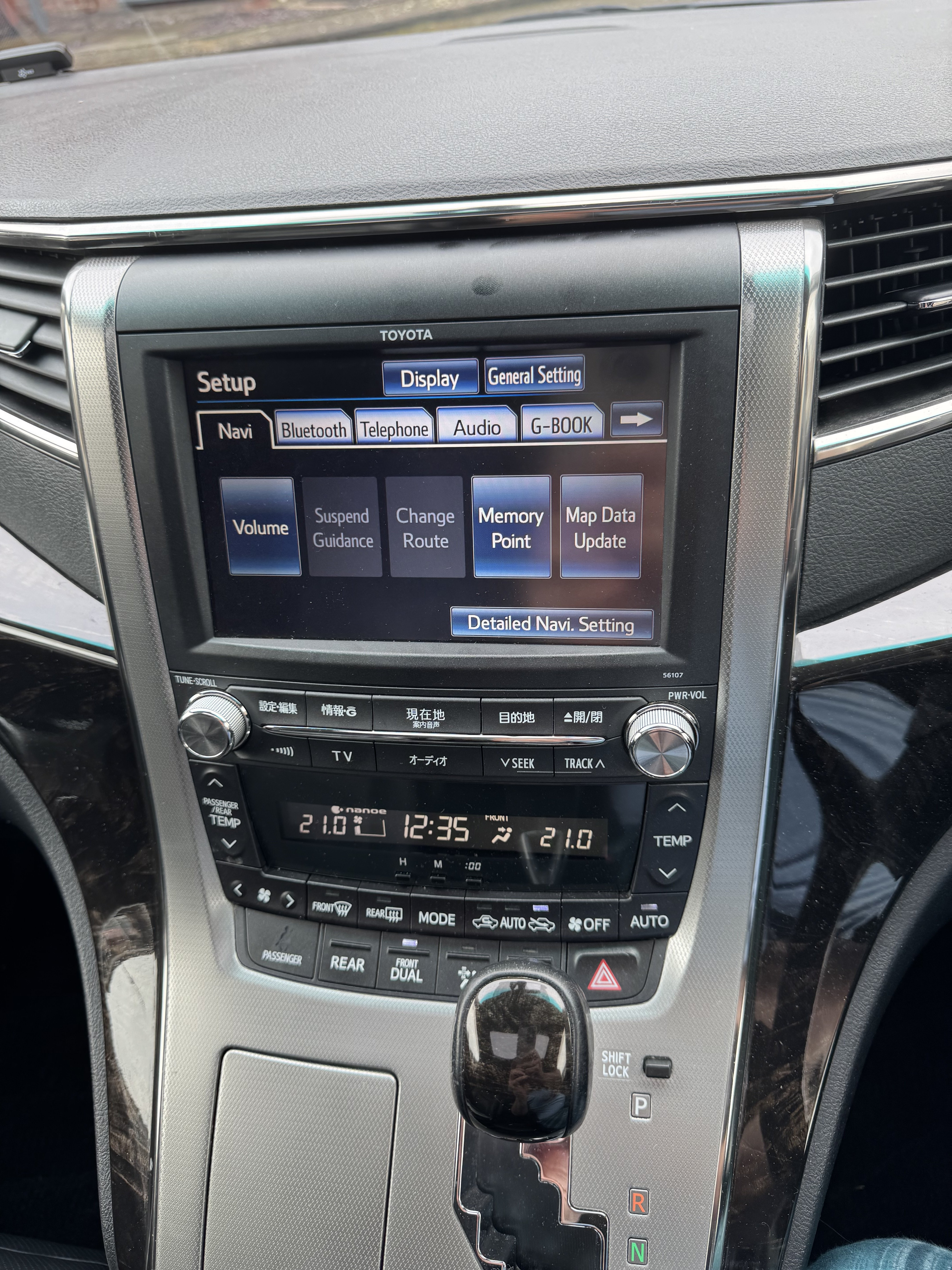

On head unit, press the top left physical button (screen settings)
Then press the middle top onscreen 'button', this will drop down the roof monitor.
The on screen top right 'button' will turn off the headunit screen (turns black), useful if you want less distraction when driving.

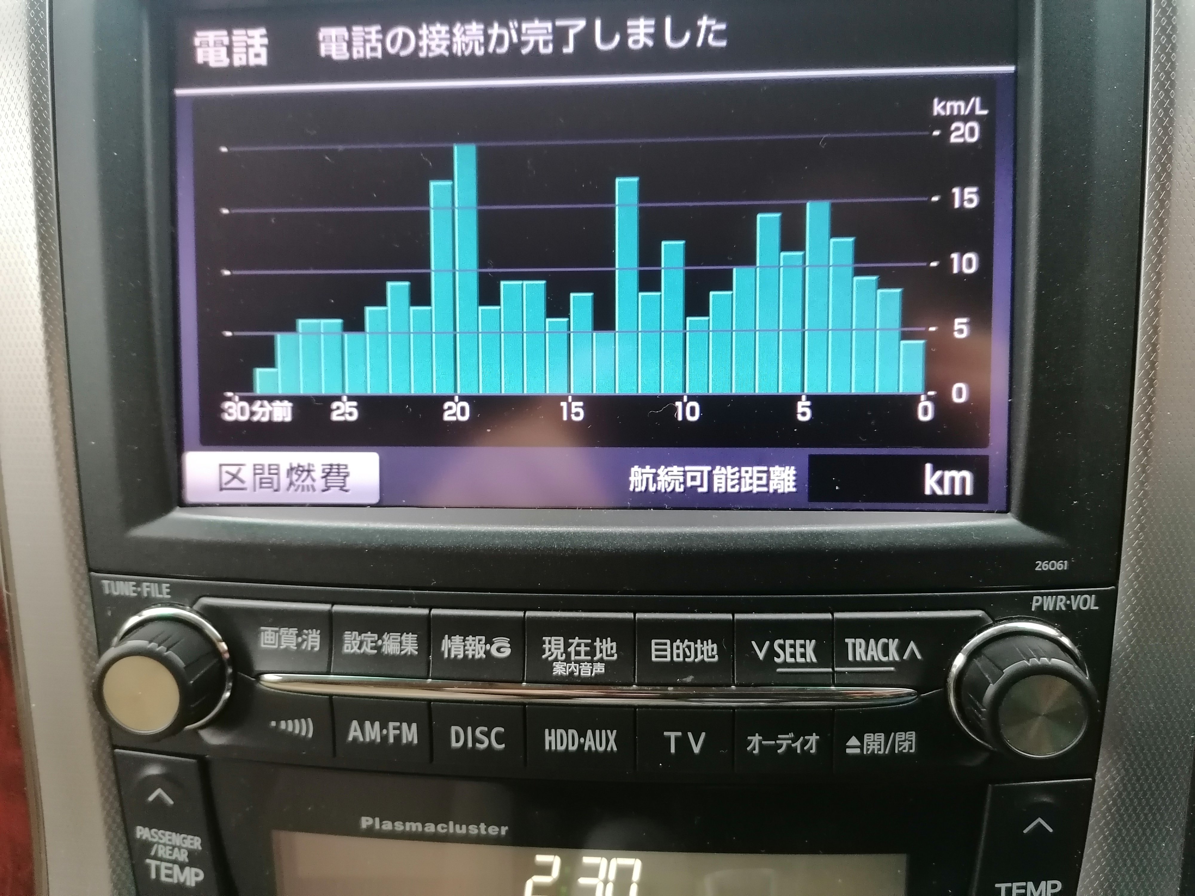

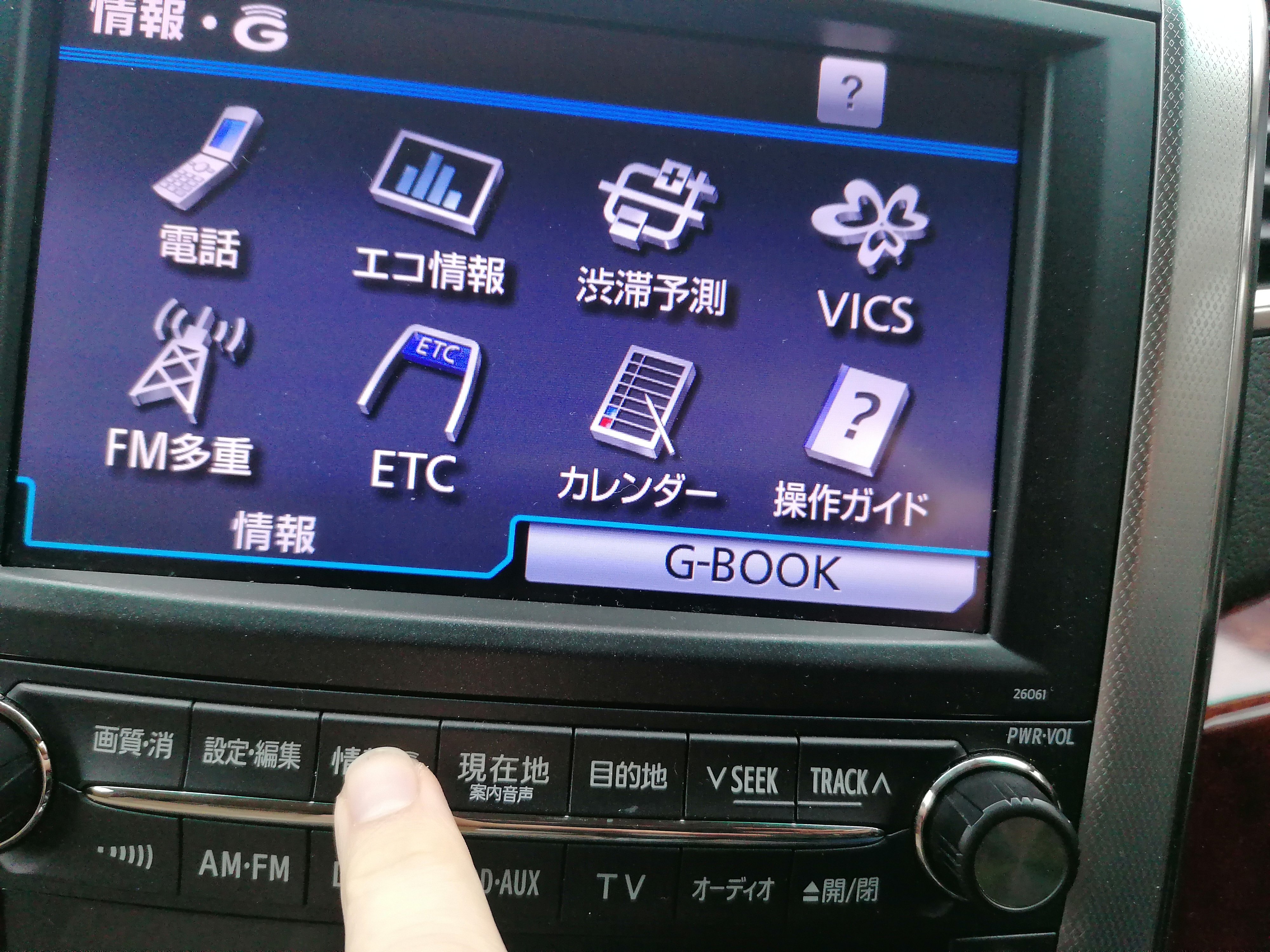

Fuel:
Hit the physical button with large G in the Japanese text, then press on 2nd on screen icon (bargraph)
You will see a chart for each running minute.
If you press the lower left screen button, it will show 'trips' that you update by long pressing the steering wheel 'disp' button while the 'eco graph' is shown on the dashboard screen (you can get to the eco graph by pressing the 'disp button' to cycle through the various screens.
When you long press the 'disp' button, it resets the average fuel use in the dash and transfers it to the headunit memory

Can you go to the 'eco' Disp on your dash (the screen with the little bar graph)
Long press the Disp button on the steering wheel until the reading on the dash zeros.
Now on the headunit, go to the consumption screen and press the lower left screen icon, the last bar on right will be the last average consumption since the Disp button was last long pressed.
In this way, you can transfer your average consumption each time you fill up.
What reading does that show? And is there any previous data bars to compare against? The data may have been lost if the battery was disconnected, I never got the chance to see what the previous japanese owner managed to get as a comparison.

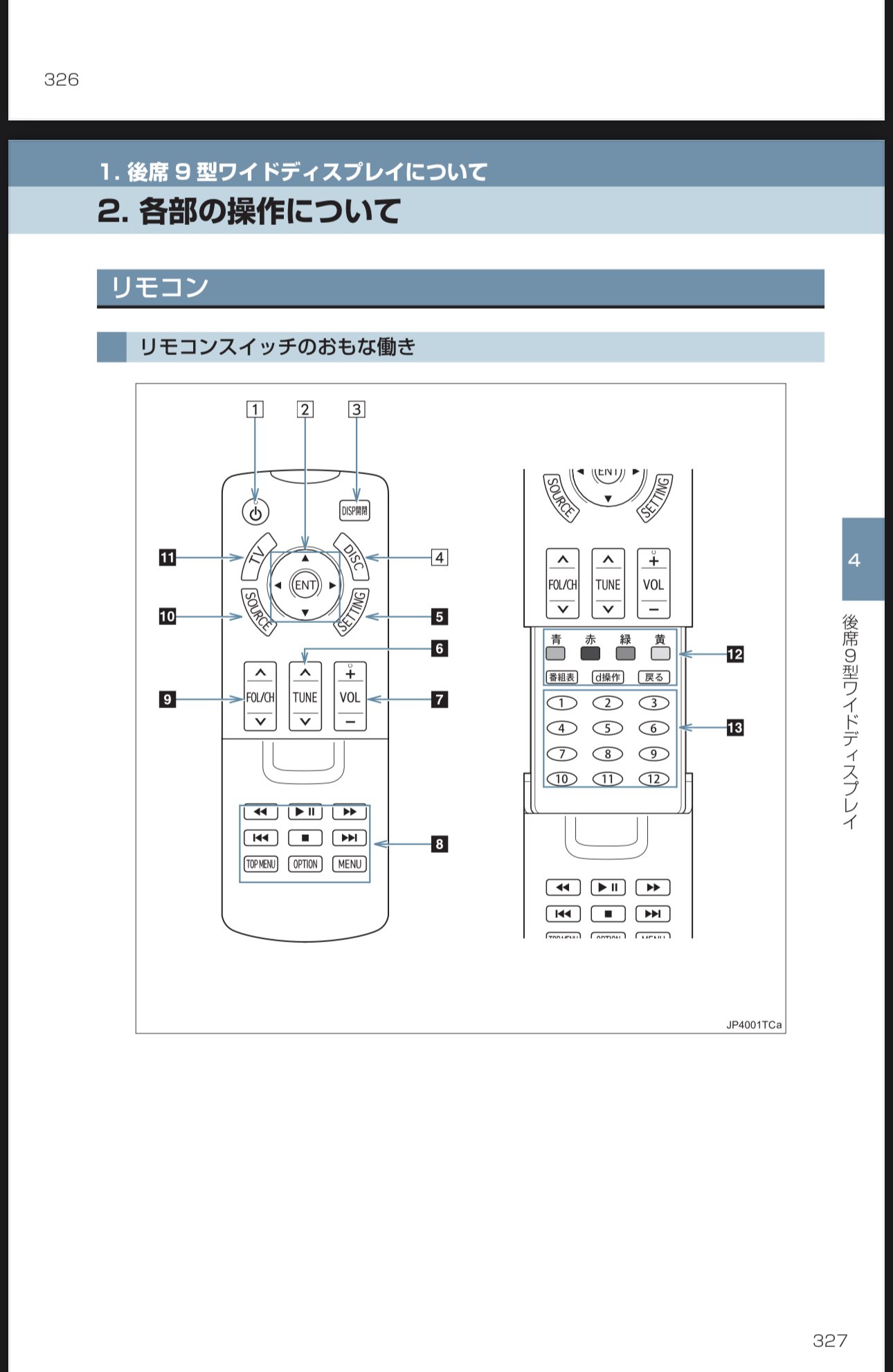

I wonder if anyone could help out. I’m having the same trouble with not being able to open the rear screen. The headunit I have on the 2012 has different options on screen compared to the ones shown in this thread. Also has different buttons to press.
My model number 56107, language can be changed to English for some of the top menu options.
Do I need the TV remote control in order to operate the rear screen? Looking in the Japanese manual for reference to the rear screen only shows a sliding remote control operating it, which of course has gone missing.
