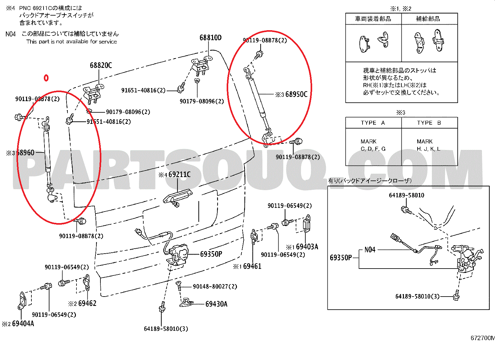

Does the earlier post with parts diagram look useful?

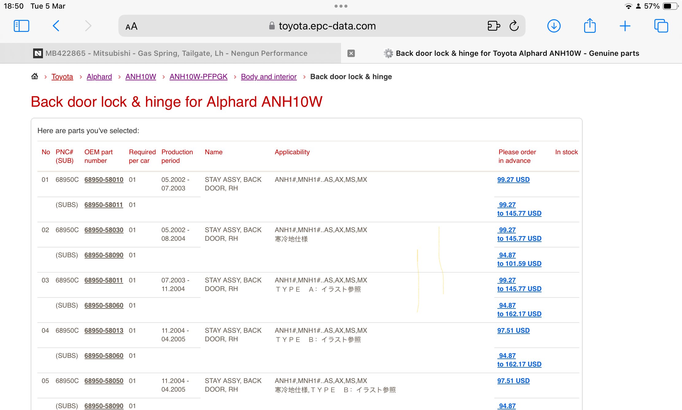

the struts are handed you have 2 different part no.s left and right   6895058010      6896058010  have atatched picture from lookup   and a link where to buy i buy from these guys all the time  need to set a account up    https://www.amayama.com/en/cart
