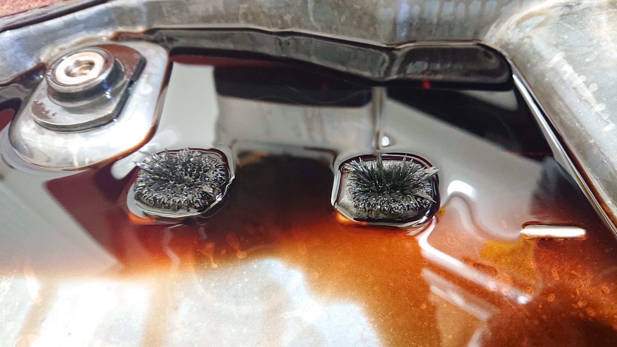

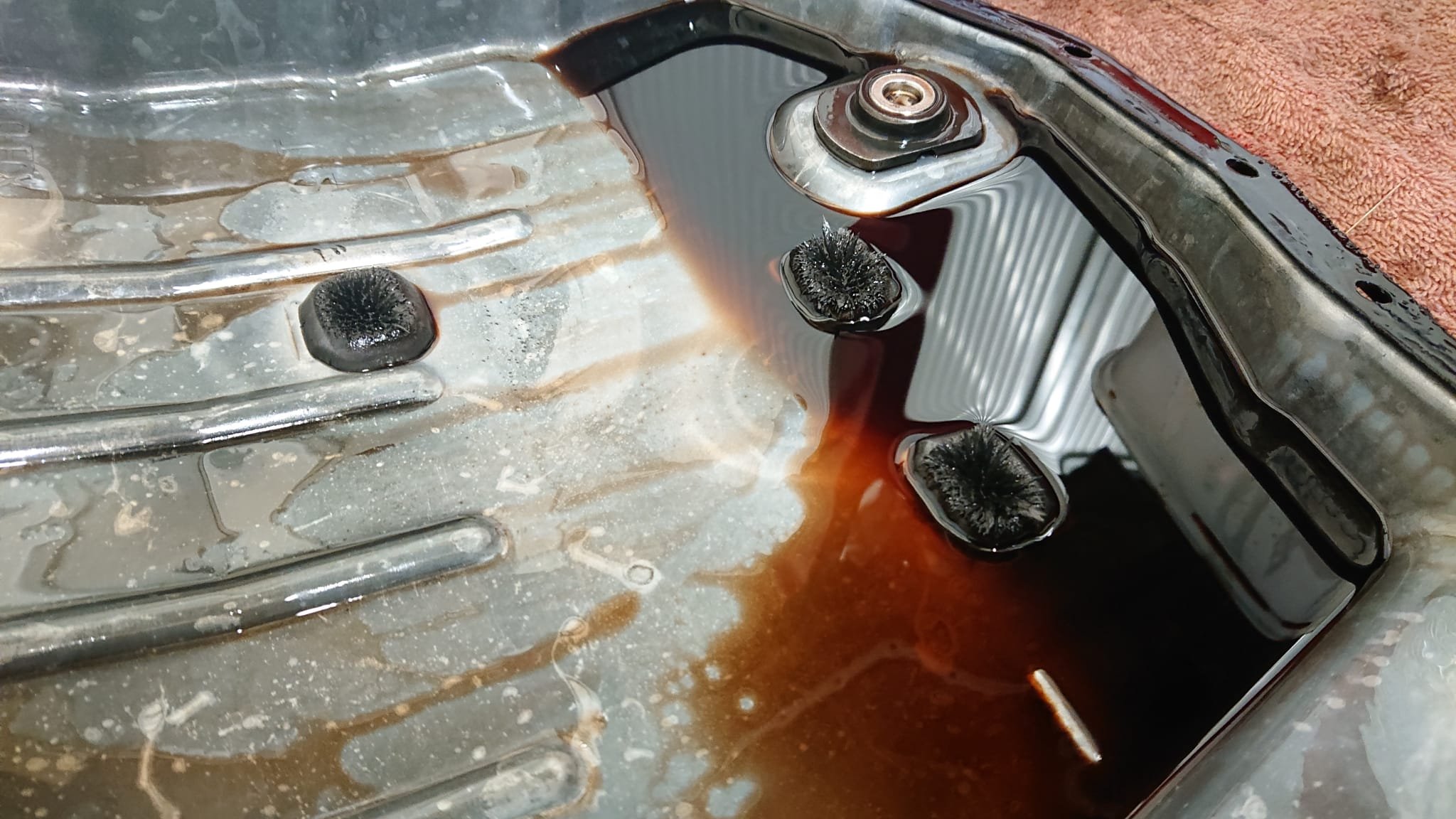

I have just got a replacement gearbox from Japan as my last one failed. Prior to fitting the replacement gearbox i dropped the sump to change the filter and noticed quite a lot of metal shavings on all 3 sump magnets. I believe it is normal to have some metal shavings but not sure if this amount is normal. thanks for any help Martin.

It's normal to get shavings in there that's why there is magnets. Over time the gear box will shave a little.
So only be concerned if you have any gearbox problems such as gears slipping, grinding, problems getting into gears or surging.
Other than that just give the gear box 3 - 4 flushs of fluid, leaving around 30 - 40 miles per flush as half is contained within the gearbox itself.

as above that looks fairly normal. I would be concerned if there were any chucks of metal. Auto gearboxes have clutch packs that produce wear and shavings in operation.
