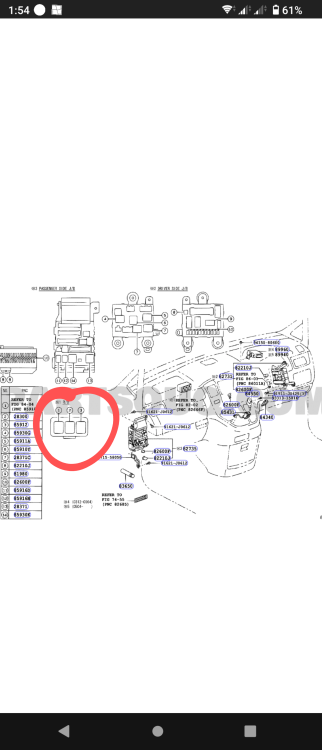

  • start relay fuse is located behind passenger glove box I have attached drawings from lookup system circled in red hope this helps location is 2

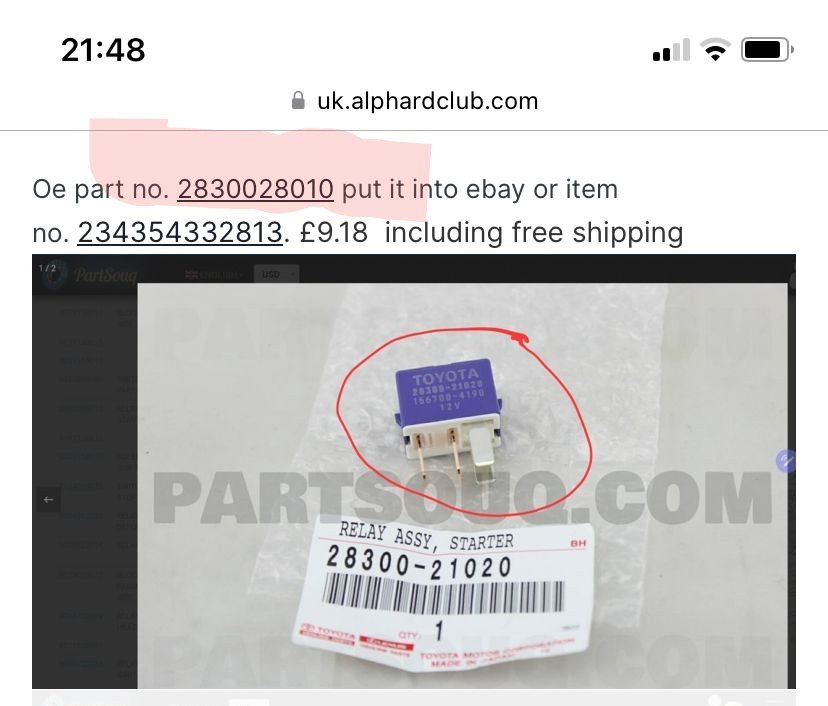

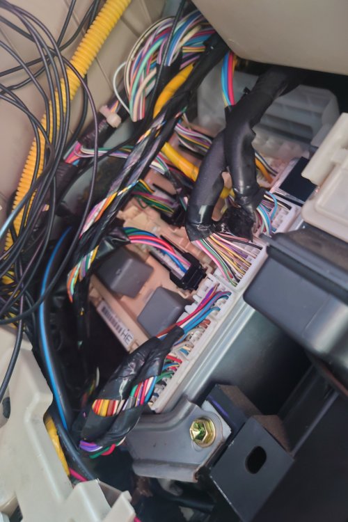

  • Thank you everyone for your help, the love bus is up and running again. It all down to a relay in the passenger footwell
  • Fuse is 7.5A.
