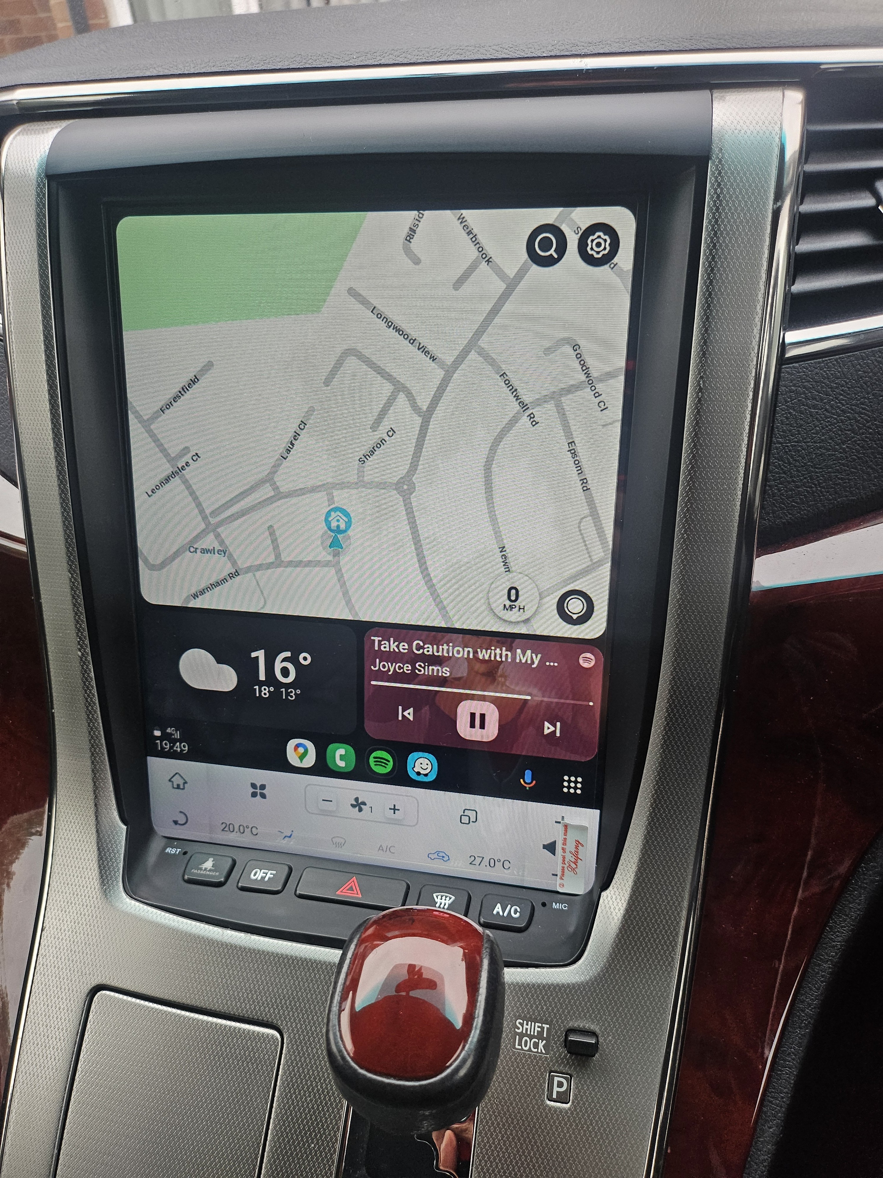

You can easily swap over to Android head units and retain pretty much all the factory features. The chinese sellers offer a MOST converter box like this.... C-TY-24
This adapter box I paid £136.74 on Aliexpress including tax and shipping. And the Android head unit I bought was the TS10 with 4 GB RAM and 32gb storage for £157.44 inc delivery and taxes. I didn't get the great big screen option as I wanted to keep the factory heater controls. Nor do I want a massive screen dazzling me during night driving.
And that makes it all just a plug in affair with the Vellfire/Alphard 20 series vehicles. The reverse camera just works, and the steering wheel controls too. And it retains the multi speaker Toyota system so you get to keep everything pretty normal. I did not have to cut a single wire, everything just plugged in. Literally anyone could do it.
These android head units really are mega as they have proper google maps included, along with USB media support so you can watch all the film and audio rips you'd ever want. Along with being able to stream stuff off your phone too. The bluetooth phone is really good.

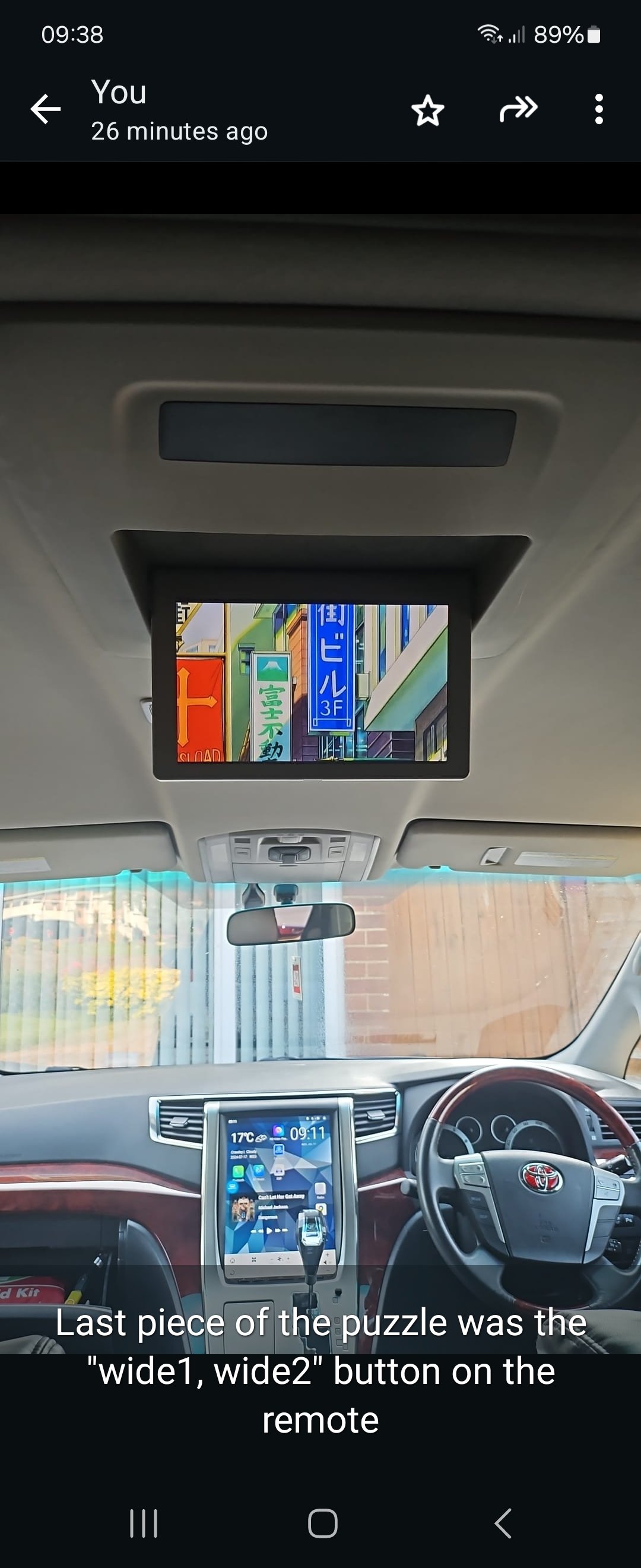

The only bits that doesn't work is the rear flip down monitor, and the front grill camera and the passenger mirror camera. BUT they all can be wired in very easily. The rear monitor is the easiest by far and I've done some posts on it here...

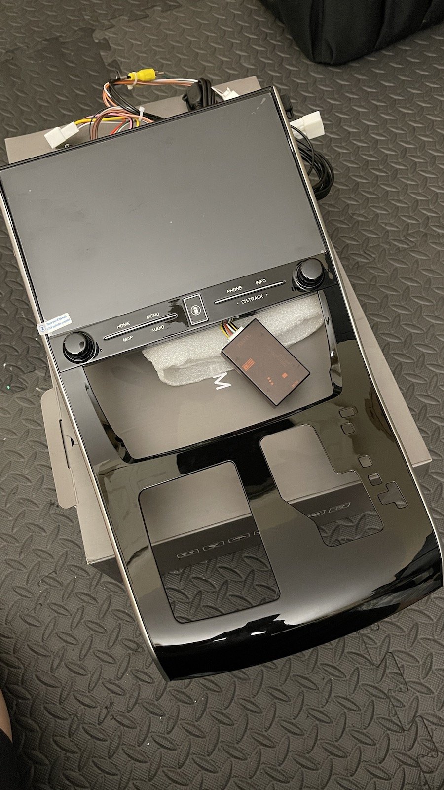

First post here... this is what I got. Only thing doesn't work is the OEM 270 camera, cannot get it show up on the screen whatsoever... probably the small decoder box doesn't compatible. Waiting for another one from the factory to try...
Or, if anyone know there's a trick or something to make it work, please DO let me know!

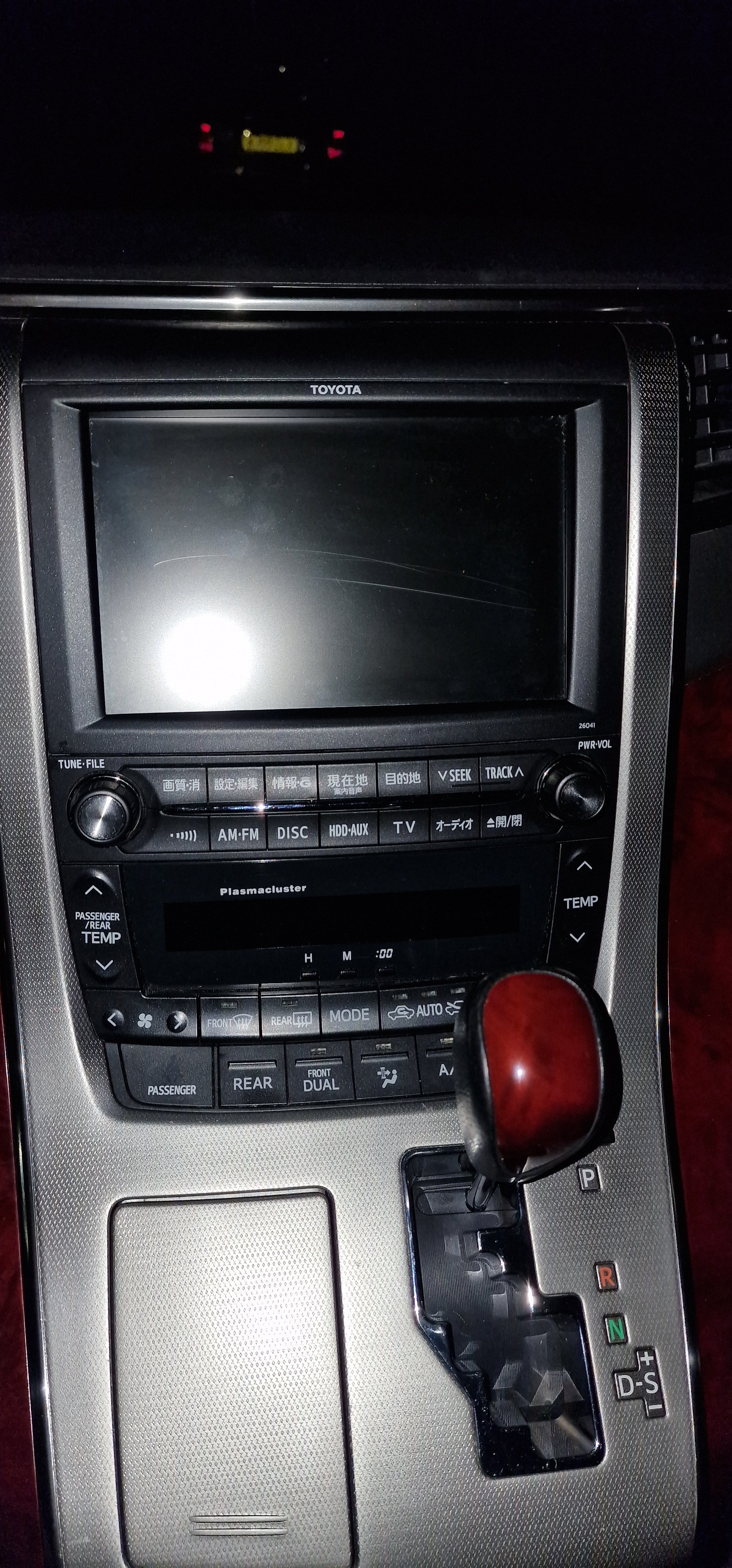

It seems there are number of different original head unit options. My 2011 Alphard had a Panasonic head unit fitted as original and the only rear connector that I have been able to match up with the wiring diagrams or anything else is the FM aerial connector. All the others seem to be unique to that particular unit.
To fit a Pioneer head unit I am having to run new cables and cut wires from the original plugs where I have been able to identify them.
Only rear camera didn't work. Completely plug and play. Ended up at about £560 delivered.
