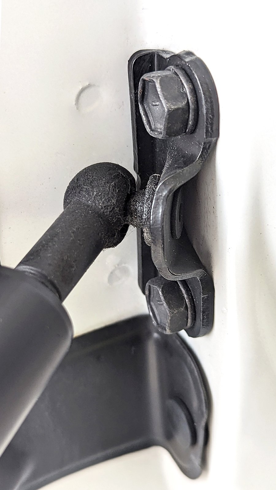

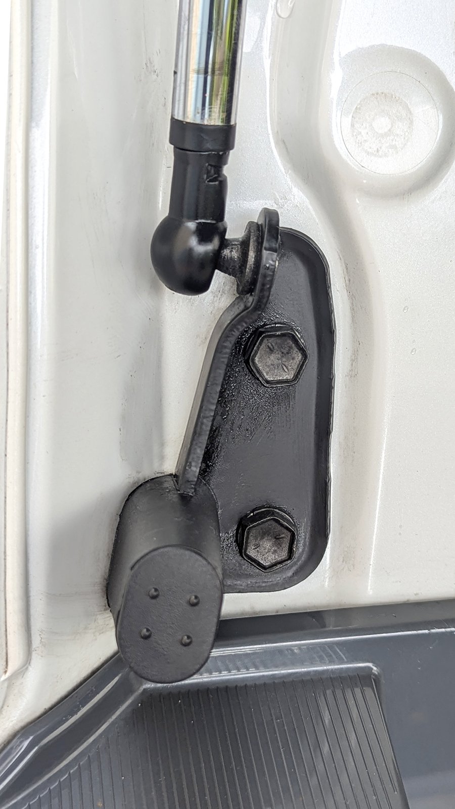

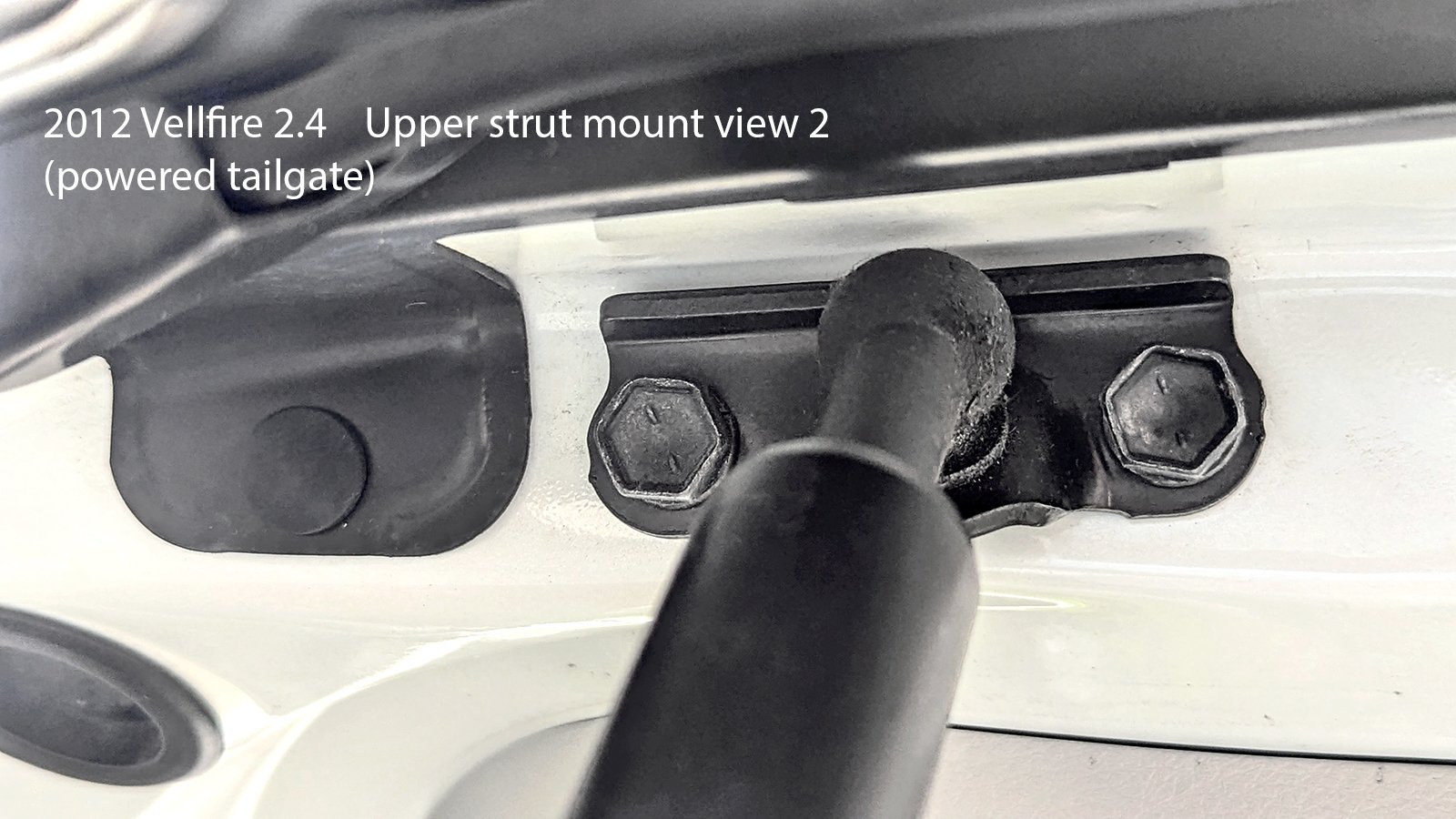

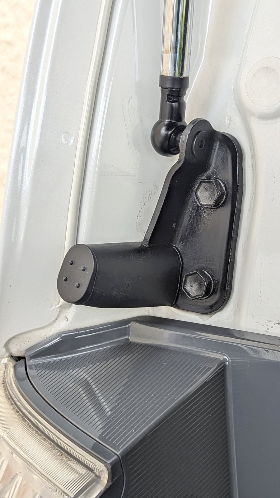

Struts - 2012 2.4 Vellfire Golden Eyes with power tailgate  - hope this helps
Thank you these photos.
They look identical to the Gen 1 facelift, but could be dimensionally different. I doubt that they are different.
However, it has been established that the strut units themselves are different, even the attachment parts are not.
I await a confirmation and quote from Amayama.
The Amayama parts are OEM assembly and a much more sensible cost, unsurprisingly, than the Toyota Direct ones.
