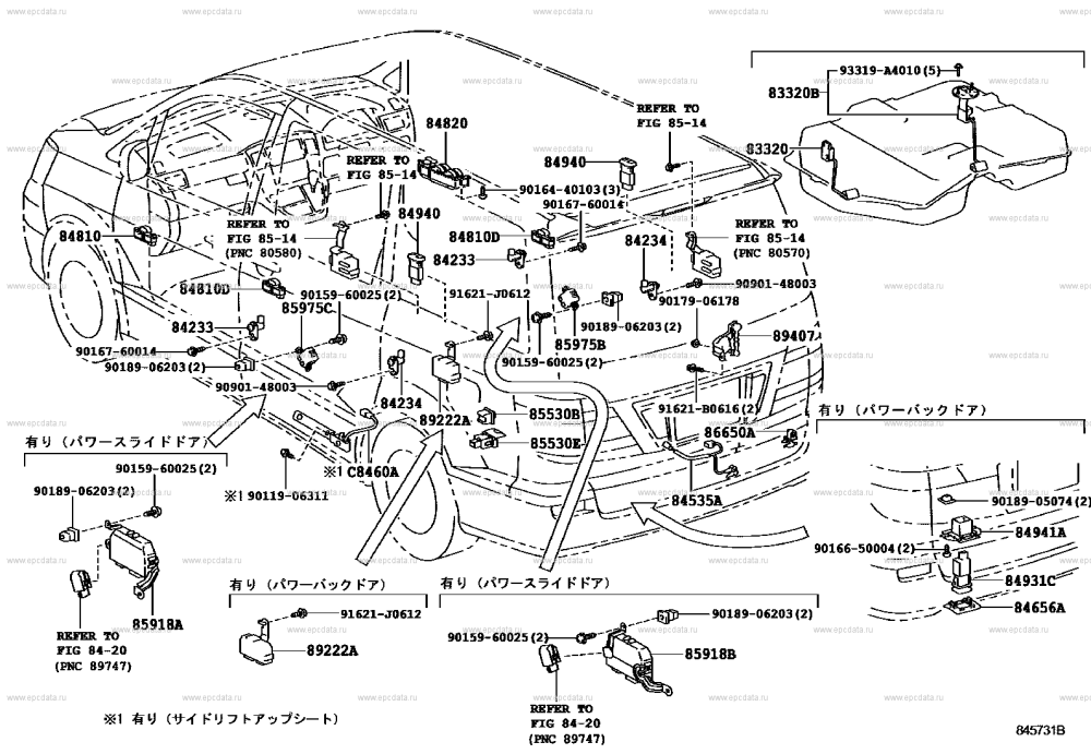

I had the same problem with my 2007, went to the mechanic, and suggested changing the sender (83320), waiting for parts to arrive in Canada, and replacing the part to see if it was the problem.

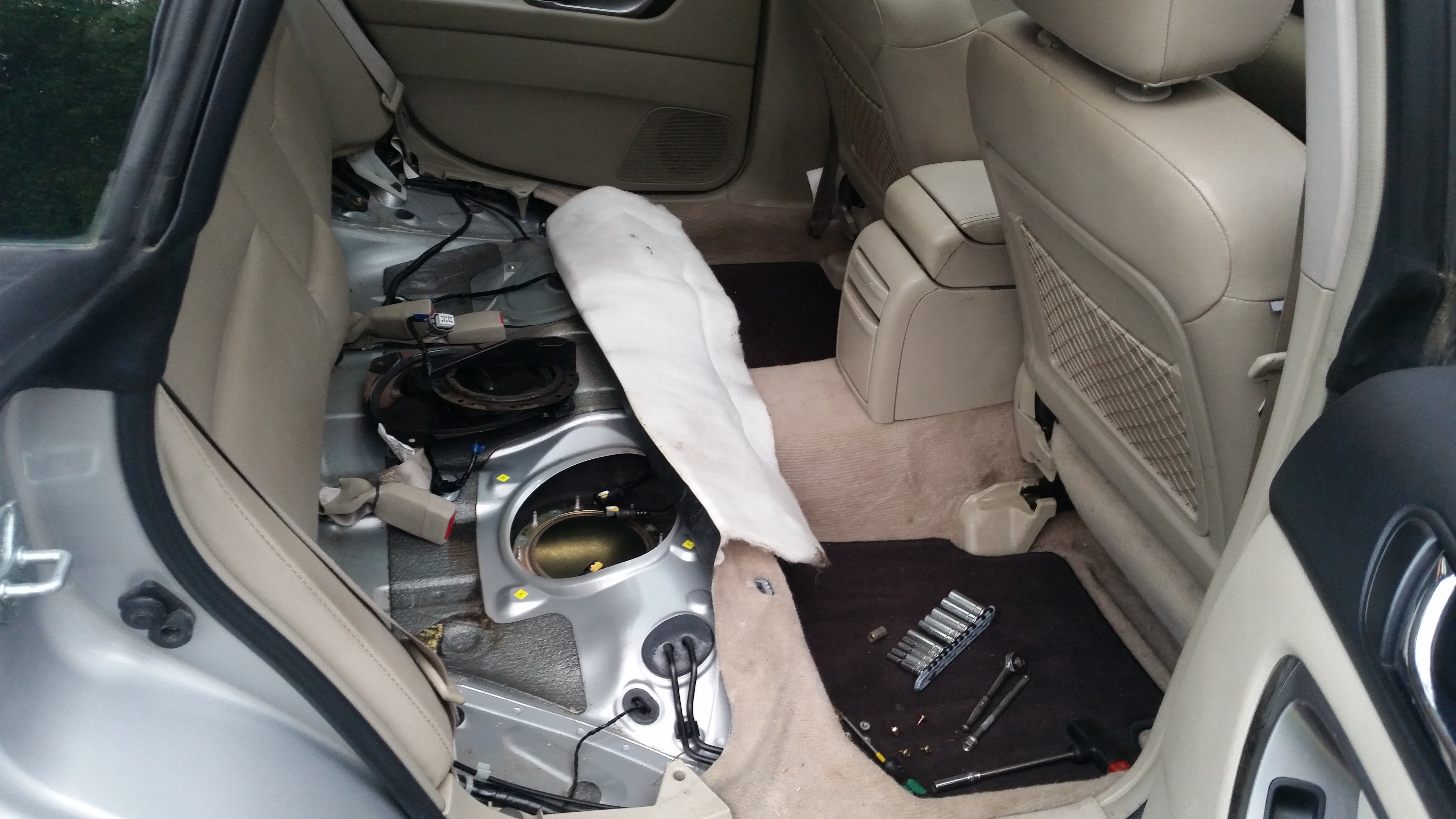

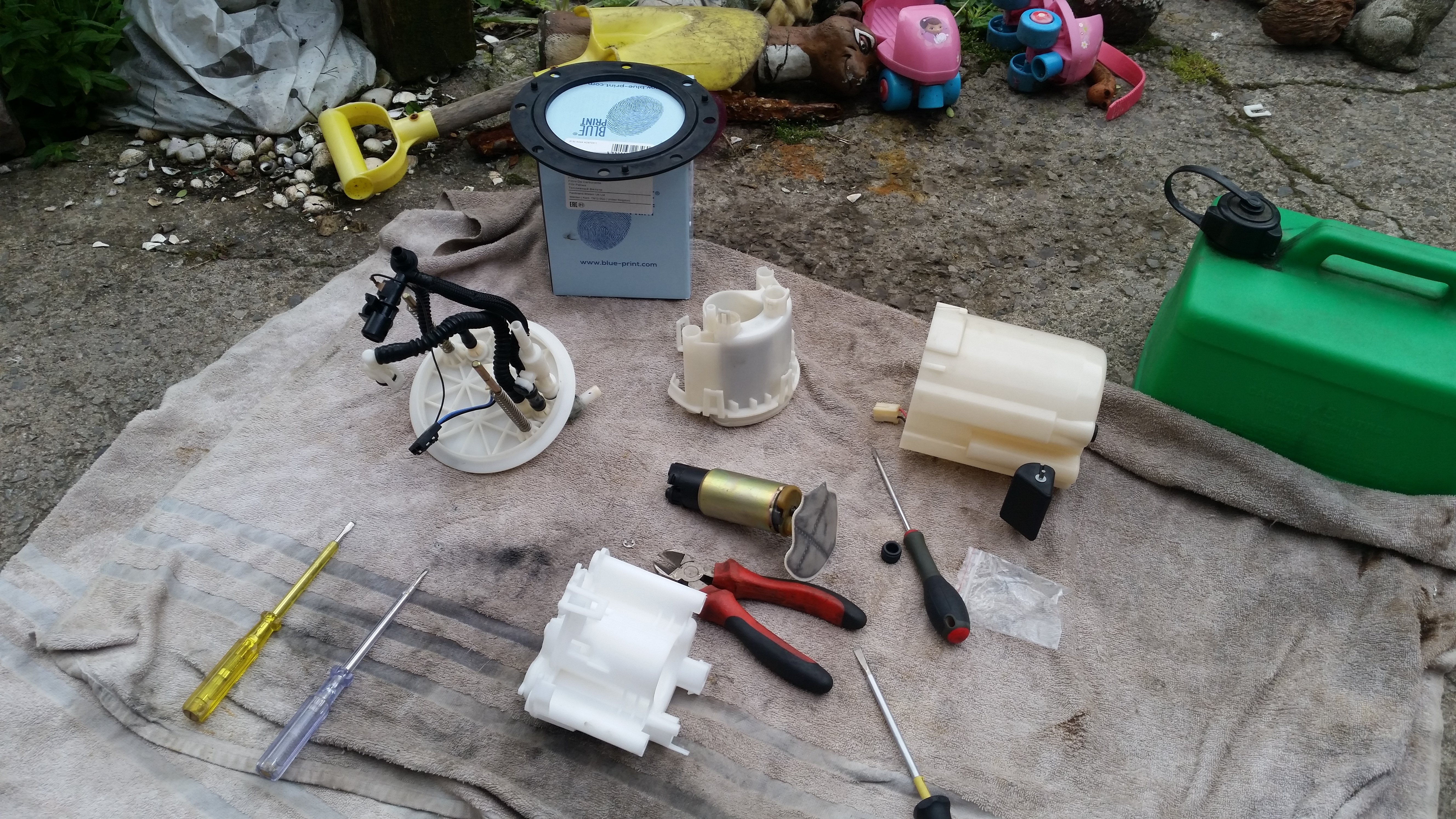

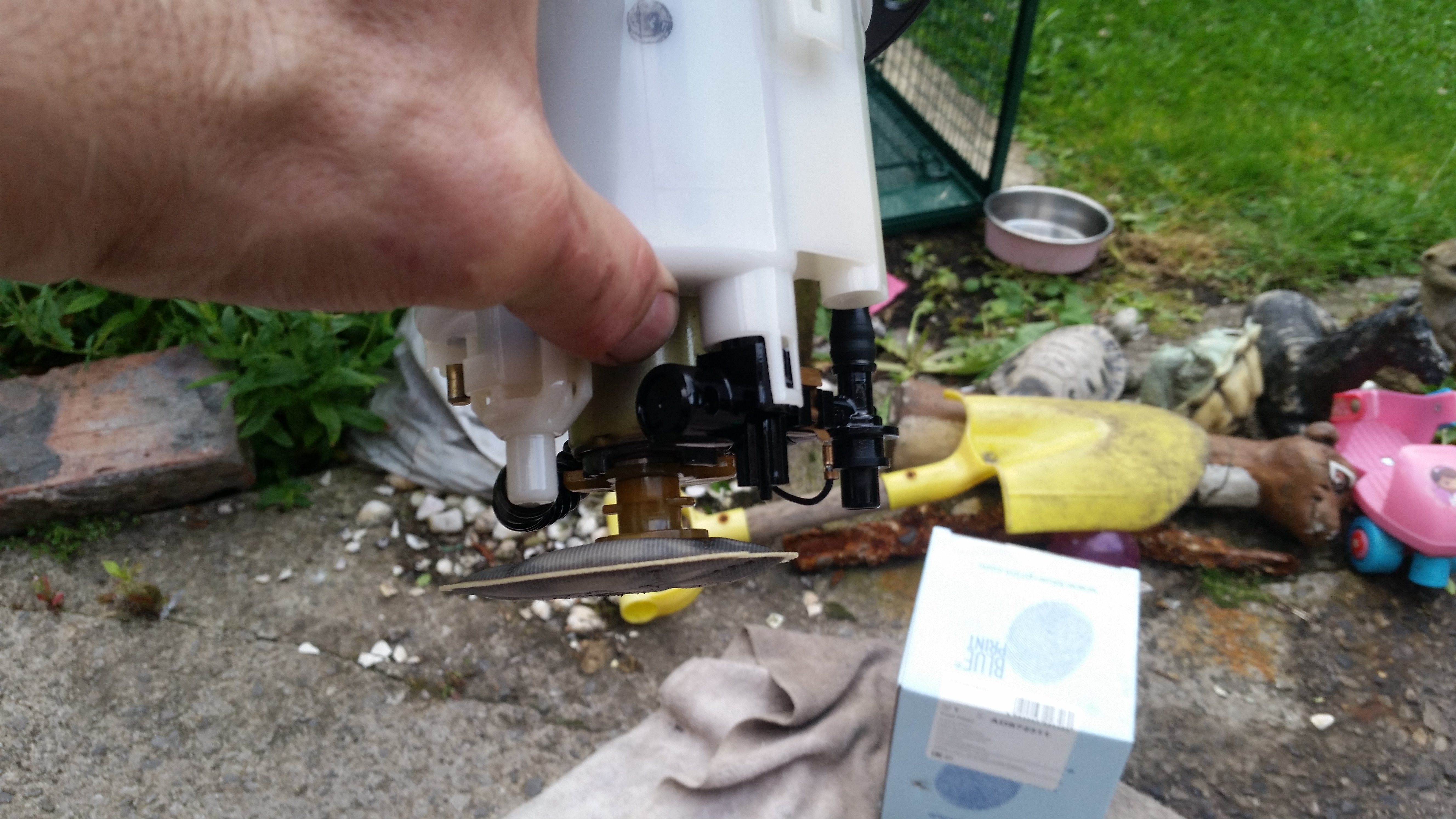

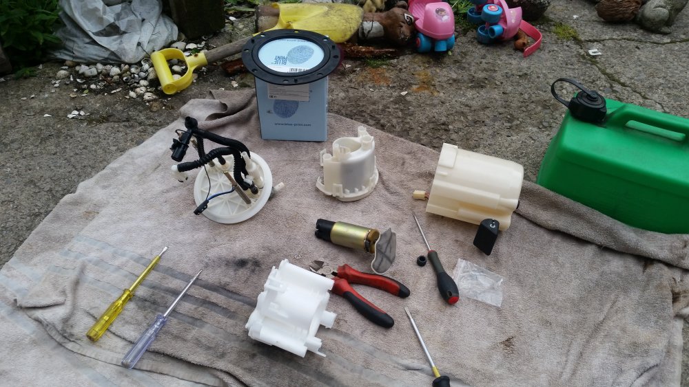

Hiya fellas!
Whilst I can't say from experience on an Alphard, I can on my Subaru Outback.
There was NO DIRT in the bottom of the tank. NOWT.
To change the fuel filter on this, it's on the fuel pump in the tank.
Access is from the top, remove the rear seat, easy, remove an access panel in the seat "floor", easy again, then remove a top panel of the petrol tank to take out the pump and filter assembly. Also easy.
The pump assembly has a mesh strainer on it, but there was no muck in the bottom of the tank on the, at that point, 14 year old 147,000 miles car.
Quite an un-nerving time prising plastic bits apart to swap the filter section though!!
Edited by BigNev
