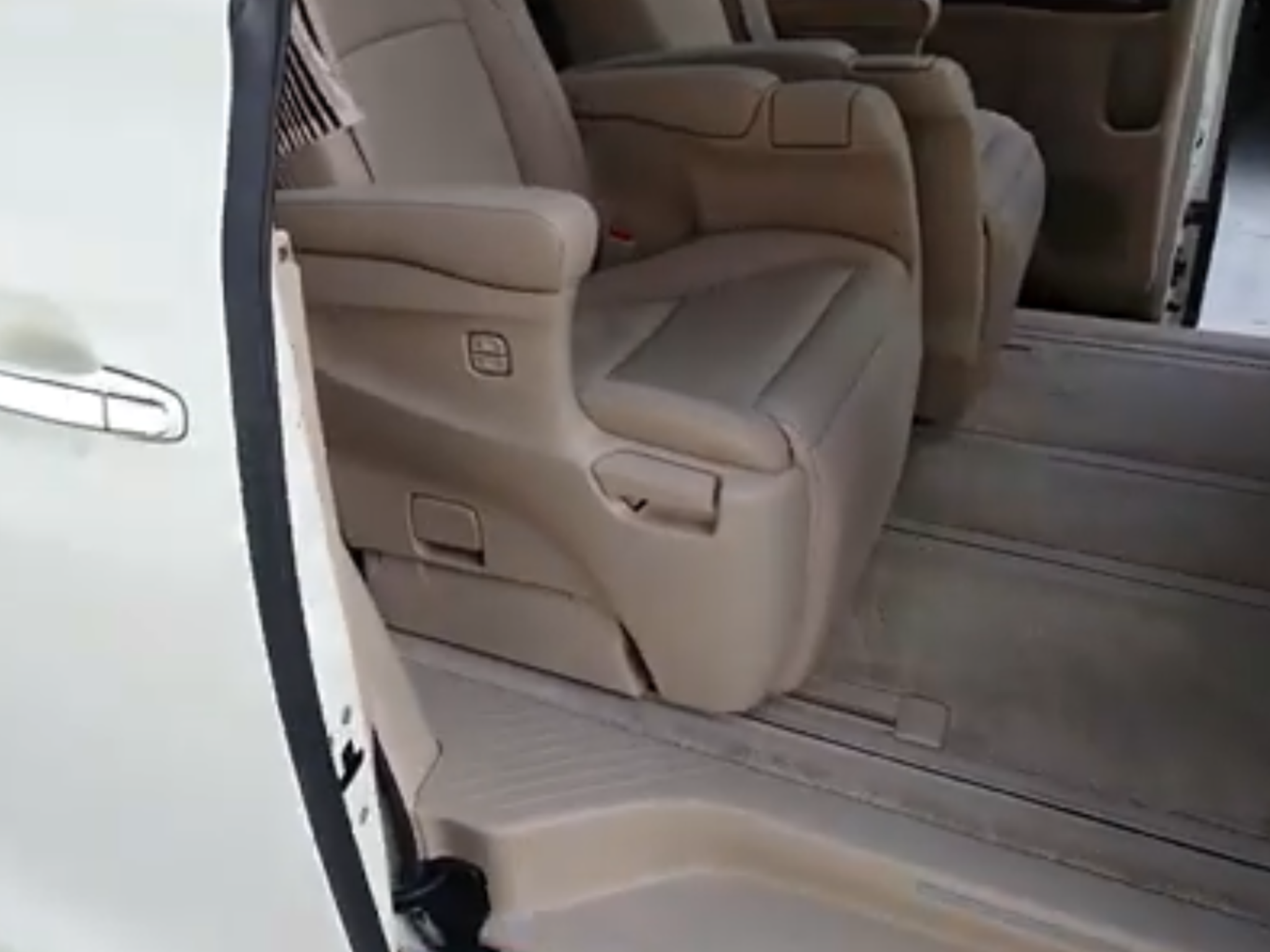

Hi,
(Still!) looking to buy an Alphard/Vellfire and wanted to ask for peoples thoughts on the high-sided captains seats that are found in the more top of the range 7 seaters ? I have seen a Vellfire that is very nice - but it has these big high sided seats (example photo added) and these are slightly putting me off from buying the car.
To me, they look a bit restrictive for general access and even comfort - I am not really sure why the plastic 'sides' are needed or what purpose they serve.
There is a more standard 7 seater version available with armrests - or even an 8 seater bench version, which to me seems to be the most sensible/practical option.
What are peoples general thoughts/experiences with these seats please ?

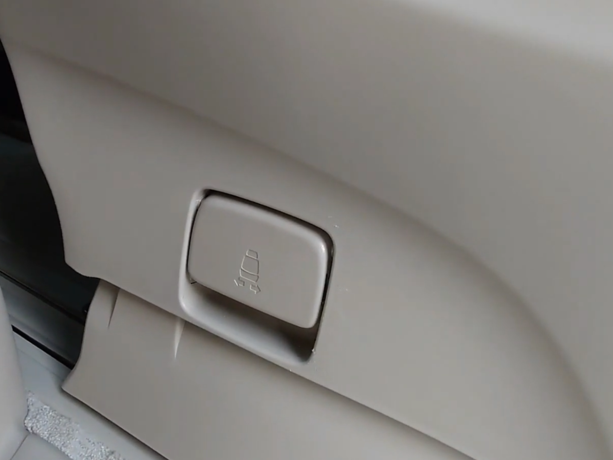

Hi
have had a GL model with these seats passengers love them especially kids with the electric foot rest and recline I’ve fitted levers so seats can be moved from side to side as Toyota did not fit these to these seats just a blanking plate but cable is fitted just not the lever but can be ordered as a spare part from Japan.
Toyota Japan have not given any explanation why these weren’t fitted.
only down side to these seats is if your wanting to move a lot of stuff with the rear seats strapped up.
 I’ve attached a picture of the seat lever fitted not standard in this model with these captains seats’
Thanks @skippy992 much appreciated, also I wasn't aware of the levers on the side. Plus a good point about the space with the rears up I hadn't thought of that, I guess with the other seating ioptions these will push up more towards the front seats.
Those seats certainly look very comfortable and a passenger is nicely cocooned in them.
Hi sumogogg
yes the seats move forward with that front lever and the other lever which is normally blanked out but with the option I talked about before allows seats to be moved from side to side also allowing them to be pushed further Back than would normally be the case due to seats hitting the wheel arches covers.
Other2 switches are for reclining seat and raising and lowering leg rest.
These are great cars I imported mine direct from the auction in Japan over 2 years ago into Australia where I now live but over in the Uk now visiting family hope that info helps you decide.
Few things to think about with them. Access to buckle with child seats is difficult. They don't / can't fold completely flat with the arm rests sticking out and the capitains seats dont really fold up. In saying that I don't find them too difficult to use with a couple of youngish kids and any adults I've taken have thought they were brilliant.

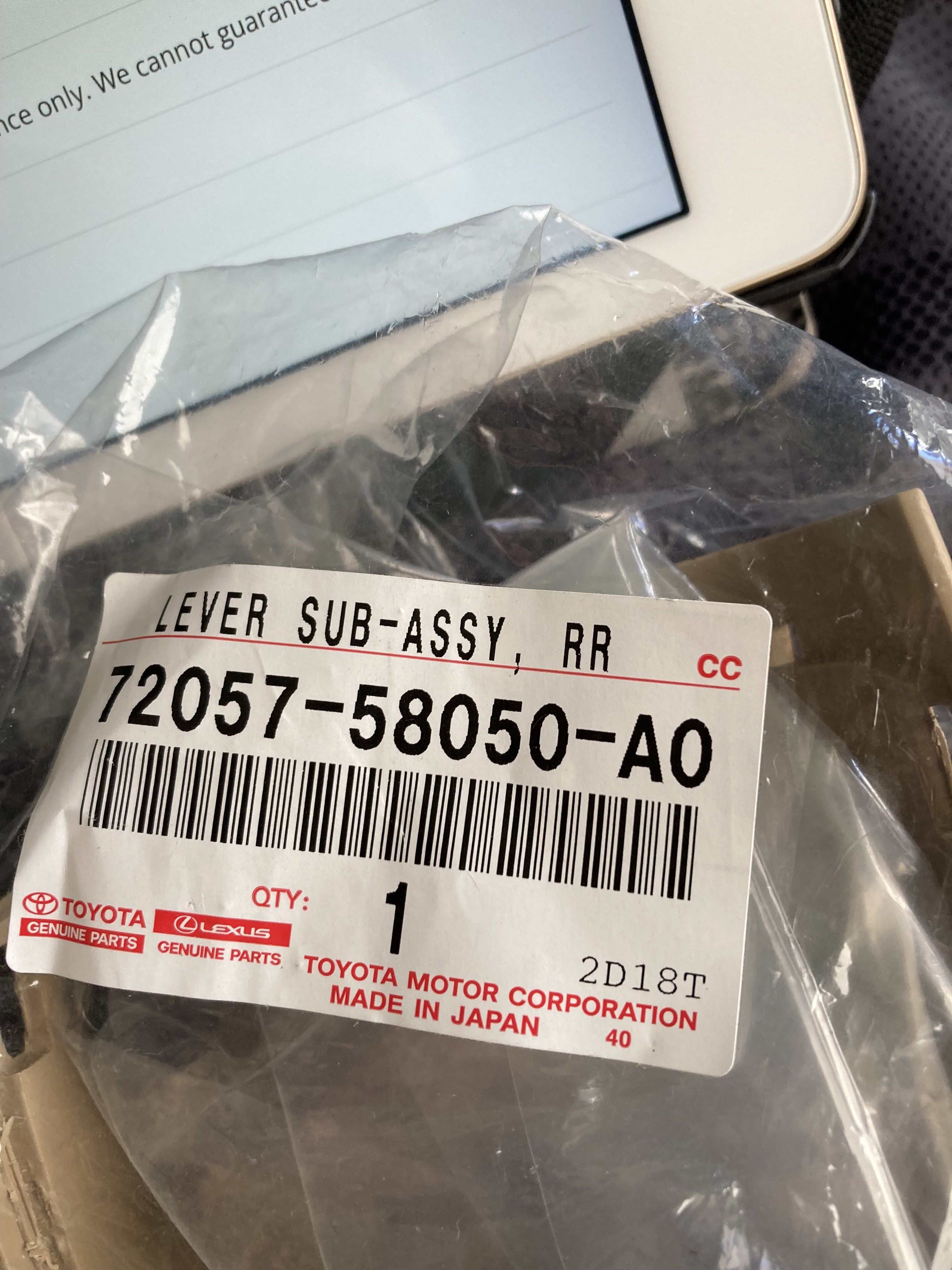

Hi bigNev
The parts are called lever sub assembly left  72058-58020-AO
& 72057-58050-AO right sub assembly
AO at the end denotes colour yours is black so would be replaced with CO
I ordered the parts from this company in Japan which I always source for hard to find parts specific for the alphard
JP CAR PARTS these parts are not readily available I had to wait about 2 months for them to be made to order cost was about 3500 yen each plus shipping but you could check with them if you include your chassis no they will confirm they are the correct part very good company to deal with hope this helps please feel free to contact me for any other info you need.
These part nos are difficult to find too me a while to track them down from the parts catalog if you search under your car they will not be shown as not fitted they are only shown with cars without the captains seats.
Regards

Wow, found them, listed on Amayama! Same price as you managed to get them for!
Just before I go and press the button to but them, were you as confused as me on the many variations on the last 2 digits for what appear to be the same part!!
Like I said you have to search a base Alphard as this is the only parts map it will show up on and is difficult to find.
just explain when you order and send them a photo of the part you should be able to google an image but that is definitely the part nos as I’ve still got the Toyota rappers for mine.
just confirm they are the black ones if you say they have them in stock that’s great perhaps because mine were cream that’s why I had to wait.
The parts have different nos as they are for left and right and are different.
cheers
Really appreciate your help on this, as otherwise I'd be totally bewildered by the little variation in numbers on the Amayama site.
Sadly JP Car Parts said no stock.
So, I've ordered them up, because if you've still got the wrappers with those numbers you can't give me any better confidence!!
I'll post some pics on here when I get them and fit them, with full credit going to you for the research! May help some others along the way hey!
Thanks again pal!
Hi BigNev
Thats ok always glad to share information here is a photo of one of the rappers just to reassure you.

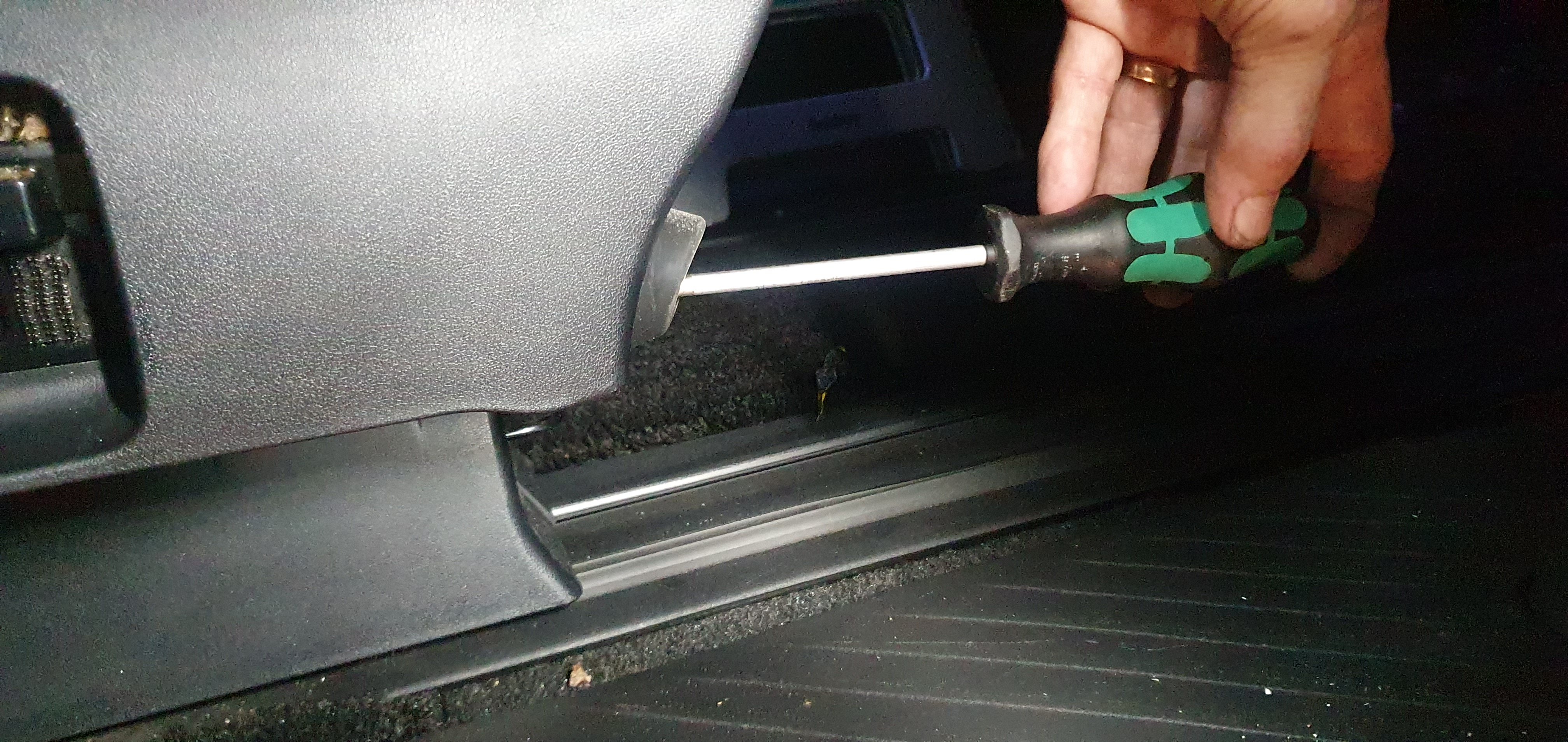

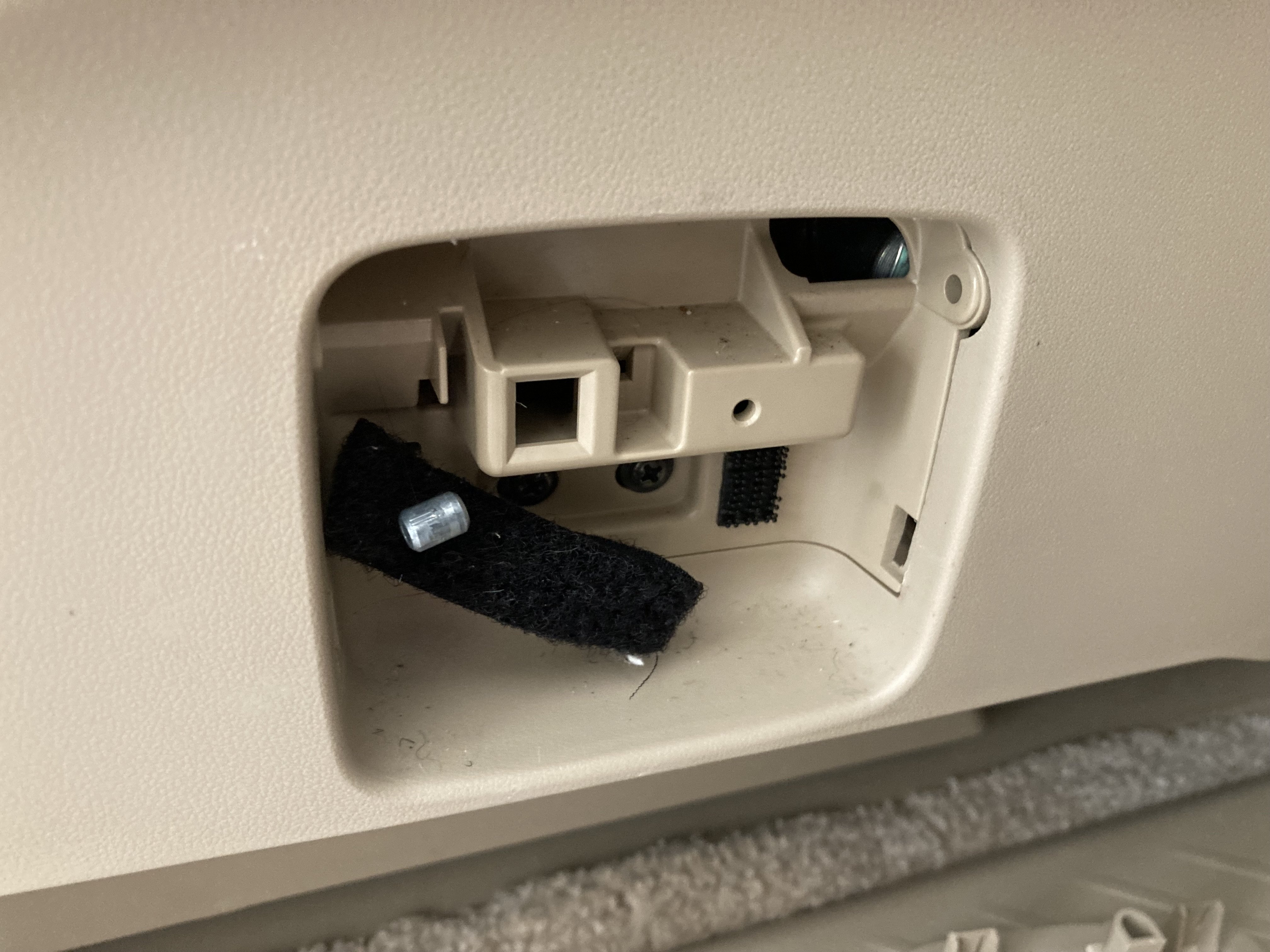

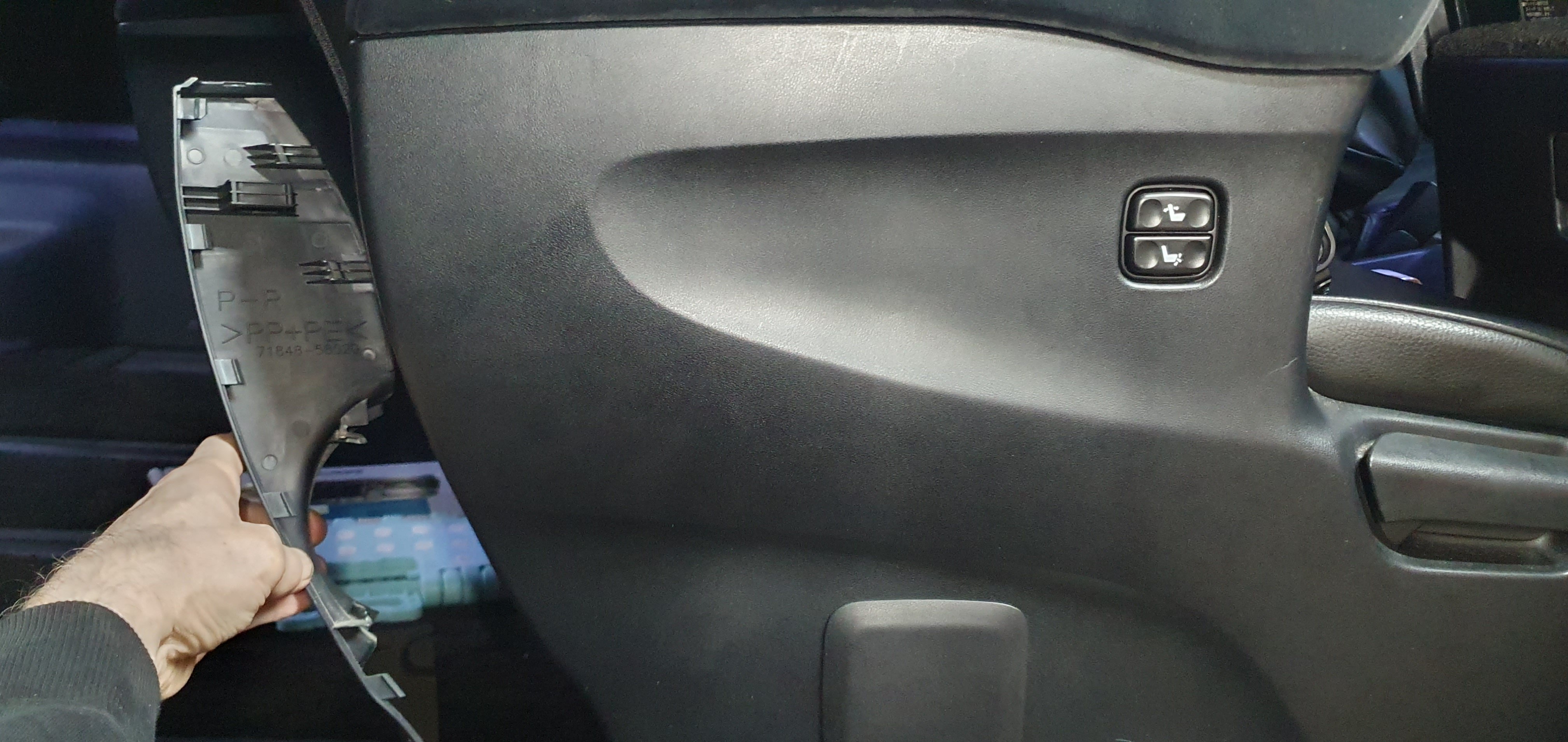

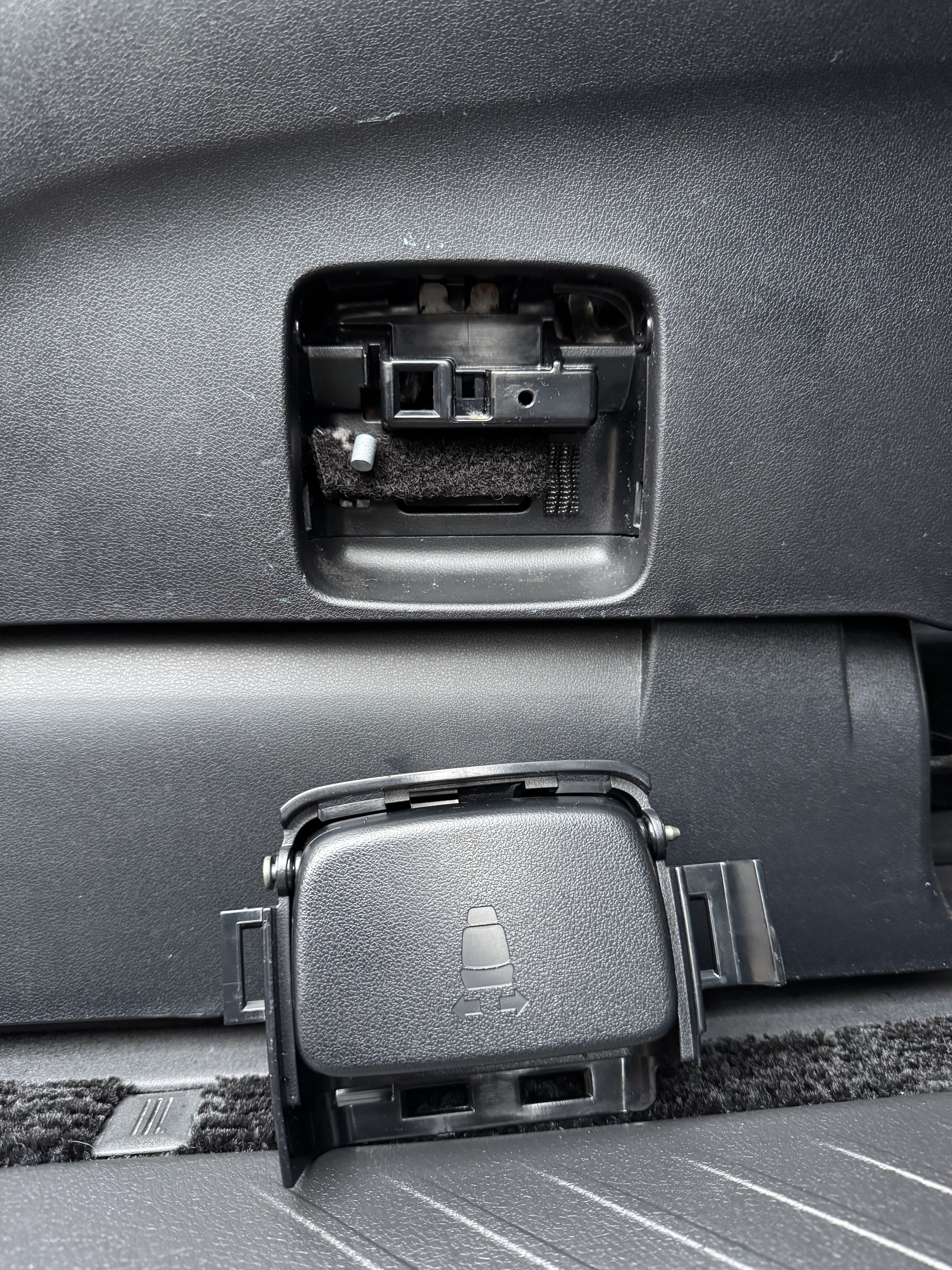

Hi guys!!!
Happy New Year!
So full credit to @skippy992 for the research to get these parts!!
First off, remove the 2 screws behind the plate.
Unhook the cable from the same plate, fingers underneath to do that.
Then - remove the panel at the back of the seat, this helps get more movement on the side panel.
EDIT - VERY IMPORTANT there is a screw holding the bump stop at the bottom, this must be removed too!
My apologies these pics are from the opposite sides of the car!
