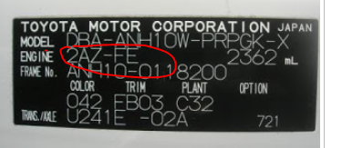

You can find your engine model on the left column of the passenger door label

There is no plate in the position you describe on my 04 Alphard.   Where else might such info be displayed?

Thank you, exactly where you said I would find it. 2AZ-FE So assuming mine is ok.

Under the bonnet.
Thanks.  Found it under the bonnet, above the rhs front wheel.  It confirms the engine type as being compatible.
