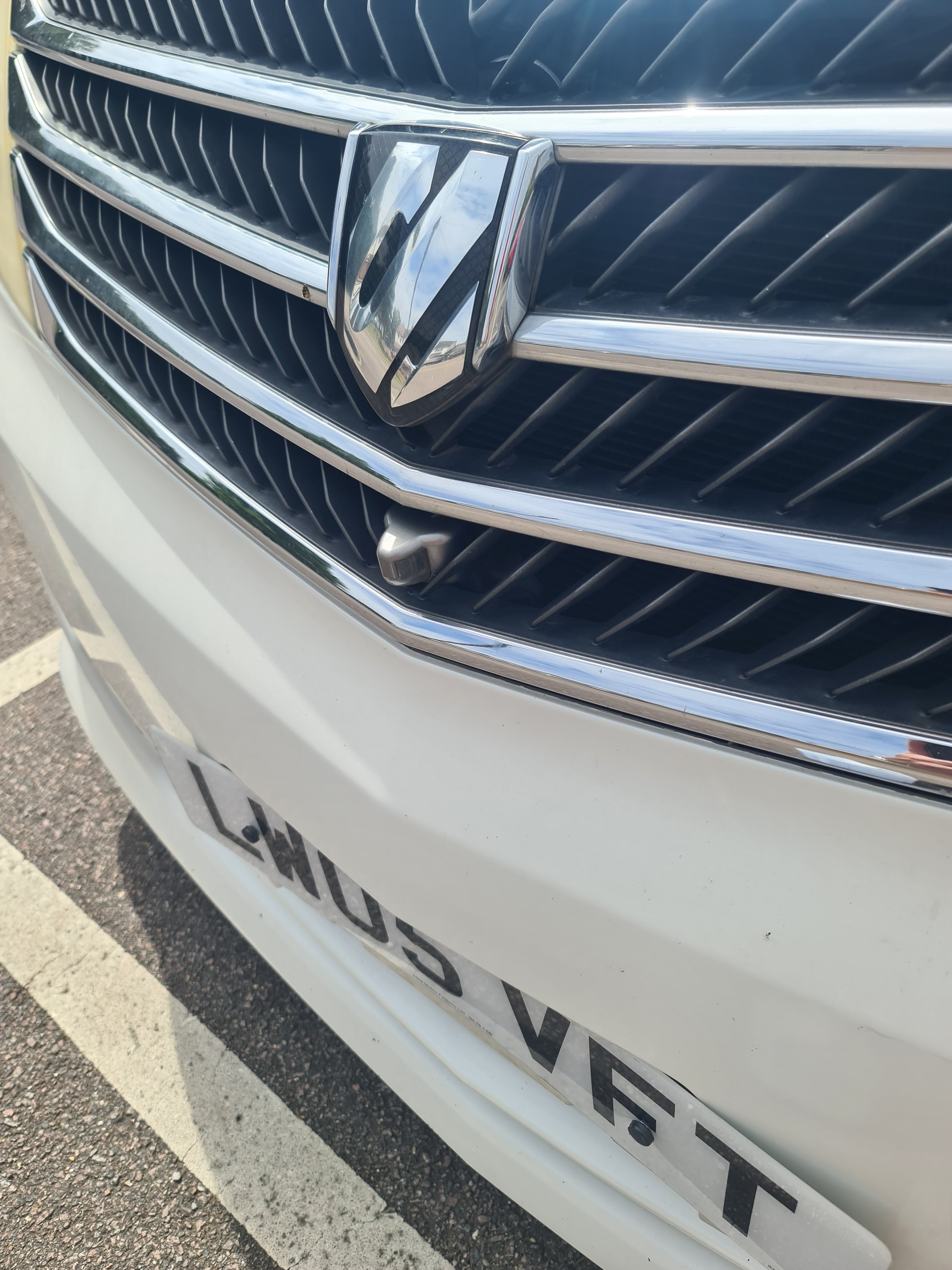

In the grill - mine is just under the badge.

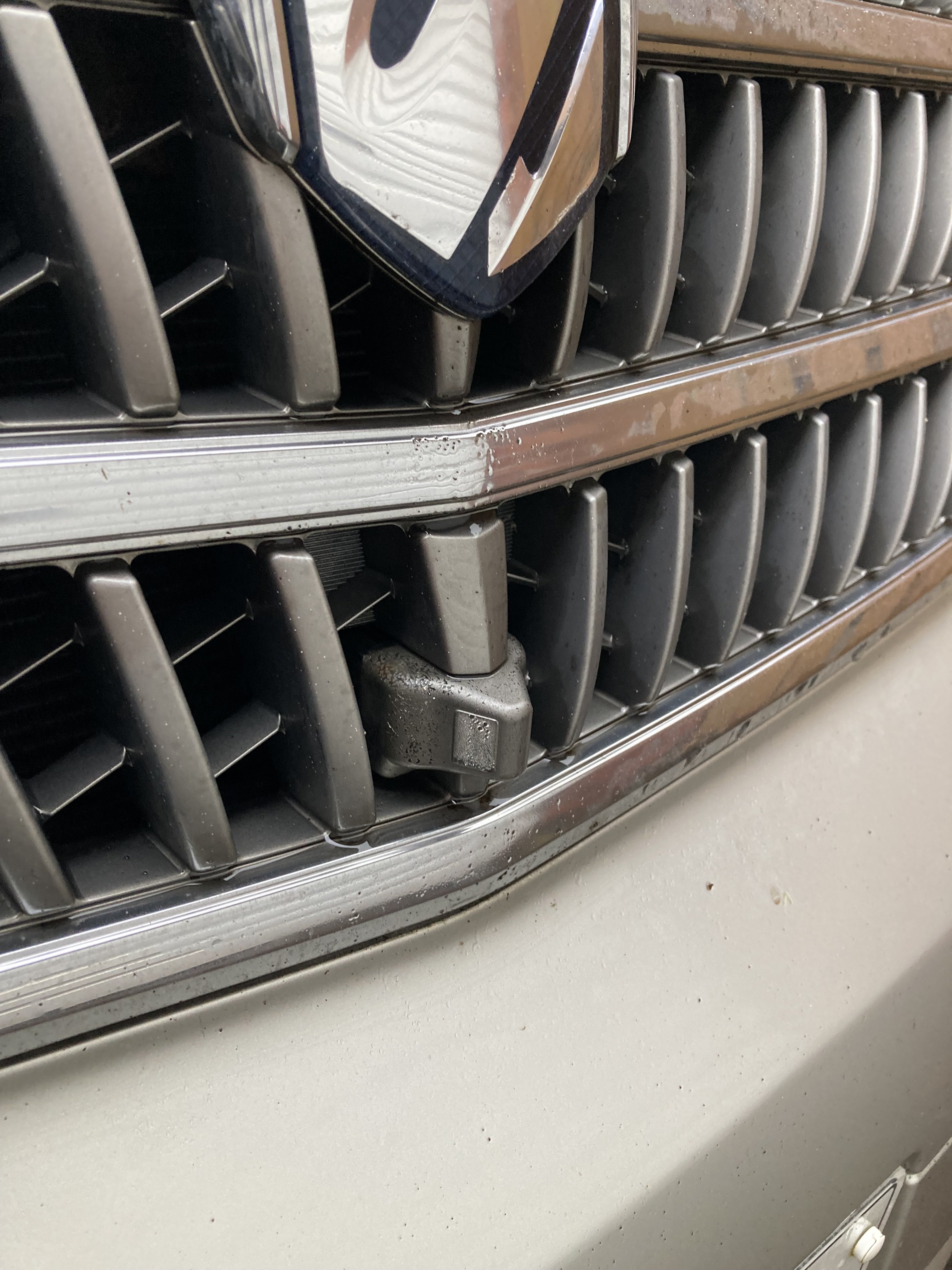

Gamith, thanks. Might be onto something, head unit is displaying two separate grey sections, never seen this before, maybe camera display.
On the right side switch panel behind steering wheel I have a few unmarked push switches, investigations under way 🤓
Look what I found!
Quell embarrassment 🫢🫢🫢
Give them a clean 🙂 apparently they run at a different voltage - 6v from what I remember from a previous post.
