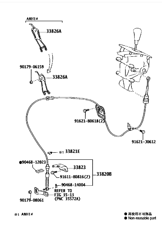

When you move the gear selector is there any sort of resistance - I am wondering whether the link between the selector and the gearbox may have come loose. it looks like there should be a cable connecting the two. (this is for a 2005 model though - yours may be different).
