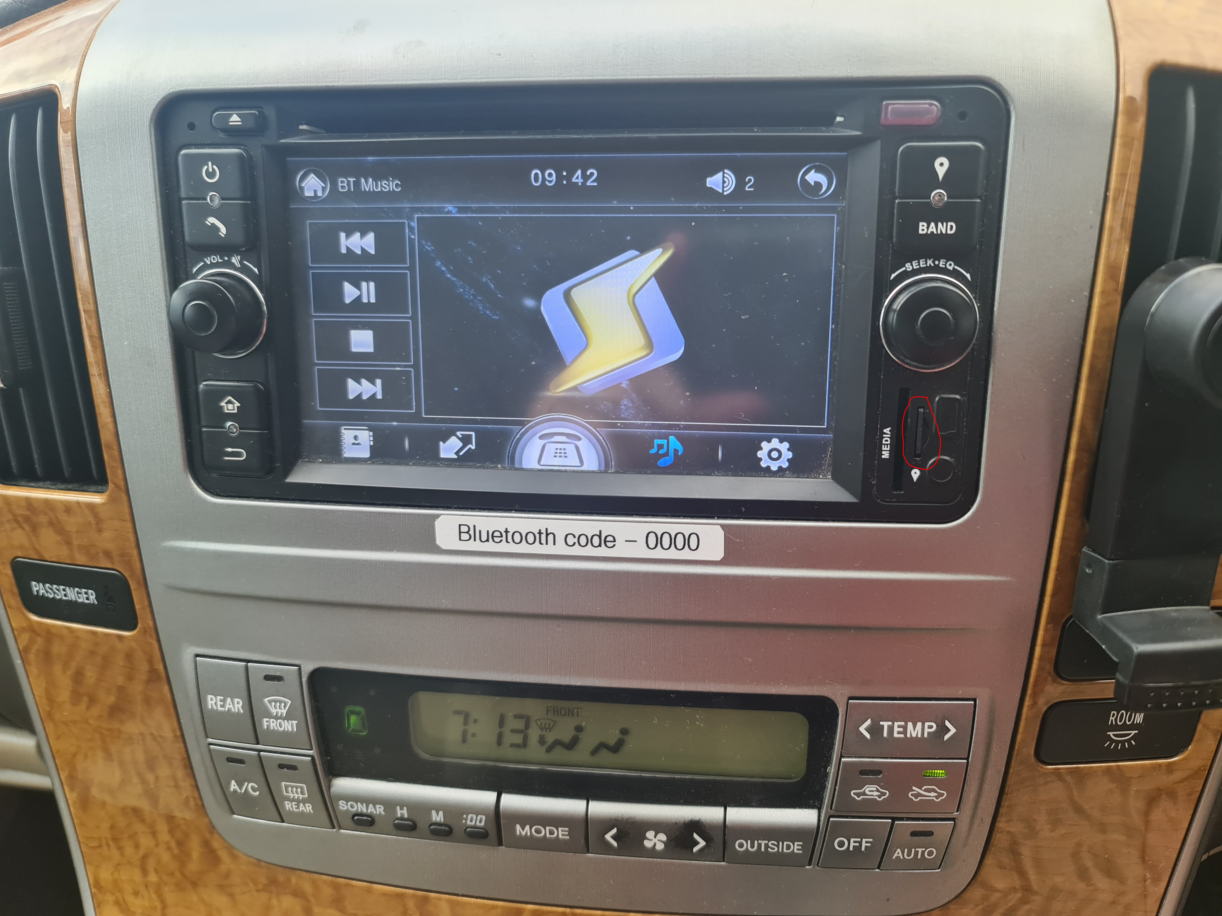

Obviously your system may vary and it very much depends on the head unit - on mine I have circled the microSD card.
Where do you think the SD card might be on my version? The button SD/RST (bottom right) is just a cover. I prised it off and it is just connected by a bit of plastic.
You can see the default message on the screen. When I press reset, it just fades out and reverts to the general menu.

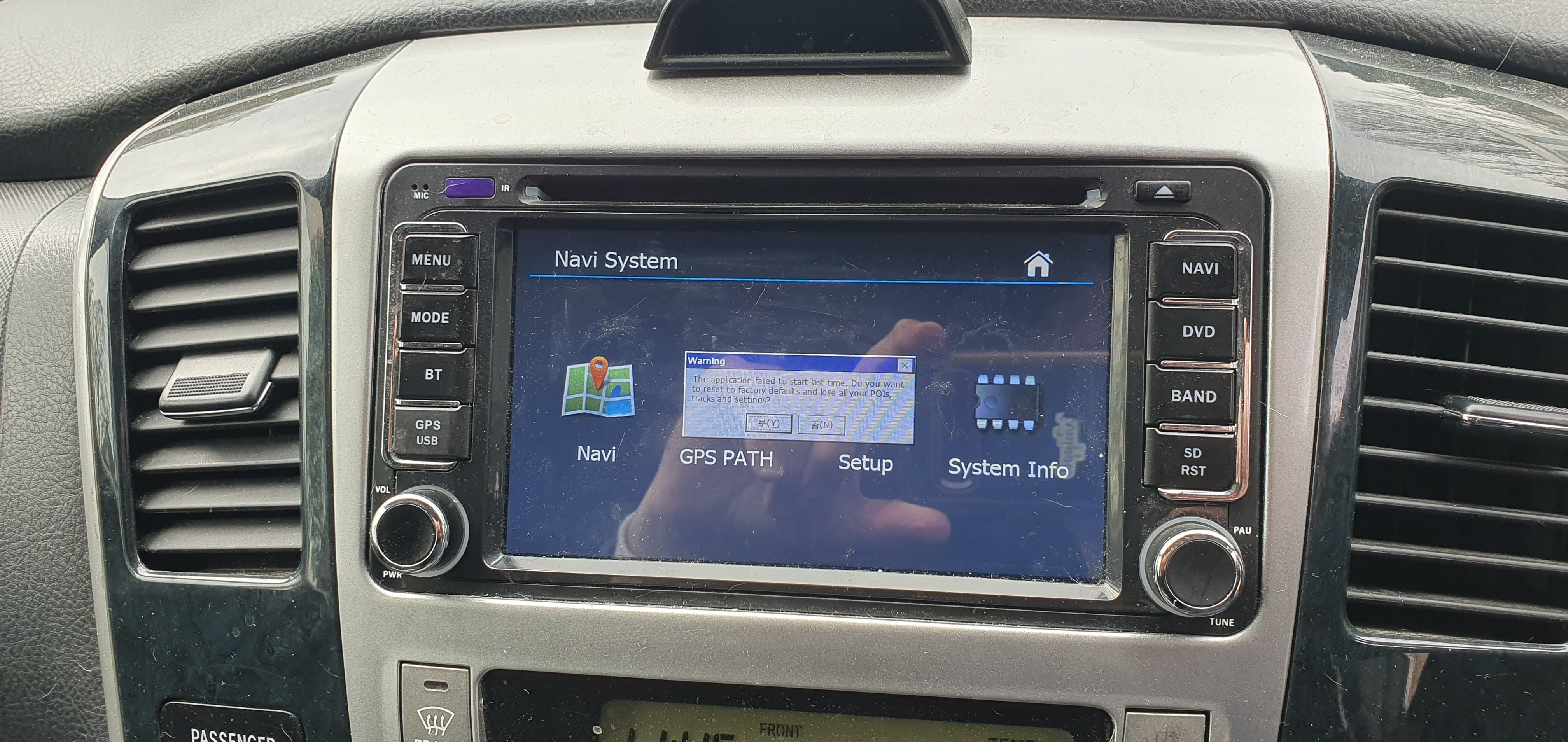

So, after a bit more prising, I have discovered the SD card and the USB port behind the GPS/USB button. Not really that surprising, but thanks fo the suggestion. It is a small SD card (8GB)
When I take out the SD card, I was able to progress a bit further with some other choices (Navi - says check GPS Path; GPS Path - provides some details, but it looks to be searching for the SD card; Set Up - allows me to change the time zone etc; System Info - a list of info), and, when I put it back in, it was clear that something was trying to load (the program appears to be something called iGo with a photo of Hong Kong). It loads about 50%, then greys out and fails to load.
I presume I might just have to buy a new SD card unless anyone has any ideas about what might be the issue. The Warning shown on the photo says "The application failed to start last time". Perhaps it is just defective/corrupted?
