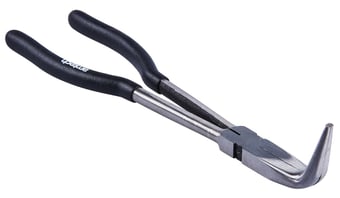

Taking the glove box out may help but I usually end up either upside down with my head where the passengers feet would be or with a flexible mirror.
Whichever way you get access to them a pair of Bent Nose Pliers will help.
Something like this - mine aren't 90 degrees but about 45.
