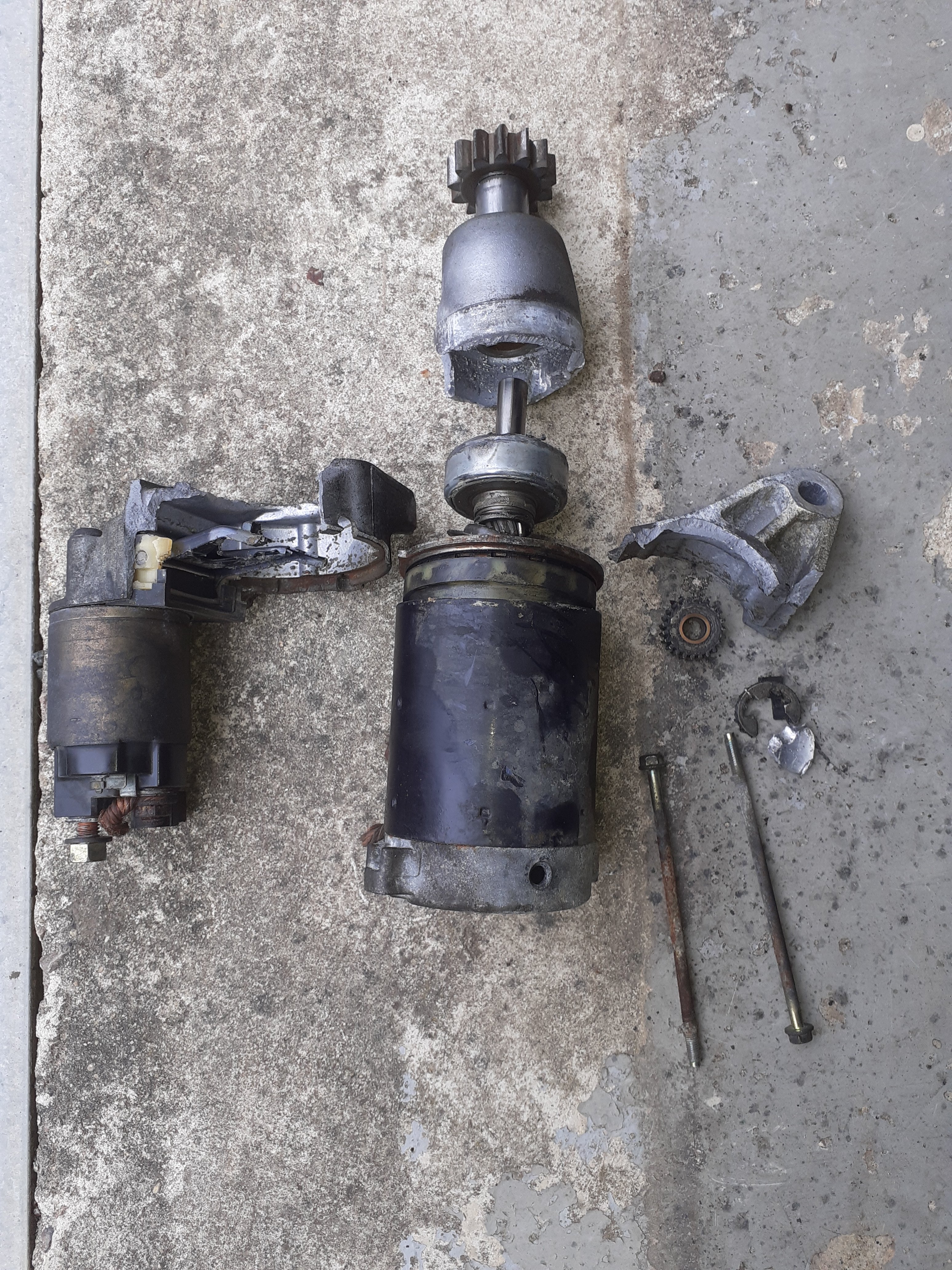

Having watched a couple of YouTube videos of removing the starter from other Toyota models, it proved to be a remarkably straightforward job. Basically the steps are remove the battery, remove the aircleaner assembly and then remove the two bolts securing the starter to the cylinder block. Took me all of 40 minutes. Then hit the most mind boggling snag I have ever encountered, and I mean EVER! The starter motor flange is corroded to the cylinder block and no amount of blows to the flange edge seems to want to break the bond.
Has anyone encountered anything like this before and has anyone got any realstic suggestions about breaking aluminium corrosion, especially where access to the joint is very limited to large tools or objects. I have the new starter and the old one is not needed as a return.

3.0 are known for it they rust them selves in the shoulder of the starter motor is smouth slides in but over time they get stuck in i have known people to brake the starter motor to get it out
Thats how mine is coming out. Current left with the front cone and pinion still stuck in the mounting hole. Cant see a way to collapse the cone without the possibility of it all dropping in to the bellhousing. Have instilled the help of a neighbour who is a commercial vehicle mechanic. So far his chisels have done far more than mine did!
New starter fitted and engine starting without issues. This is how the old one came out. The cone with the front pinion was the real problem area.

That was seriously stuck in there!
Far too happy where it was and wanted to stay!
