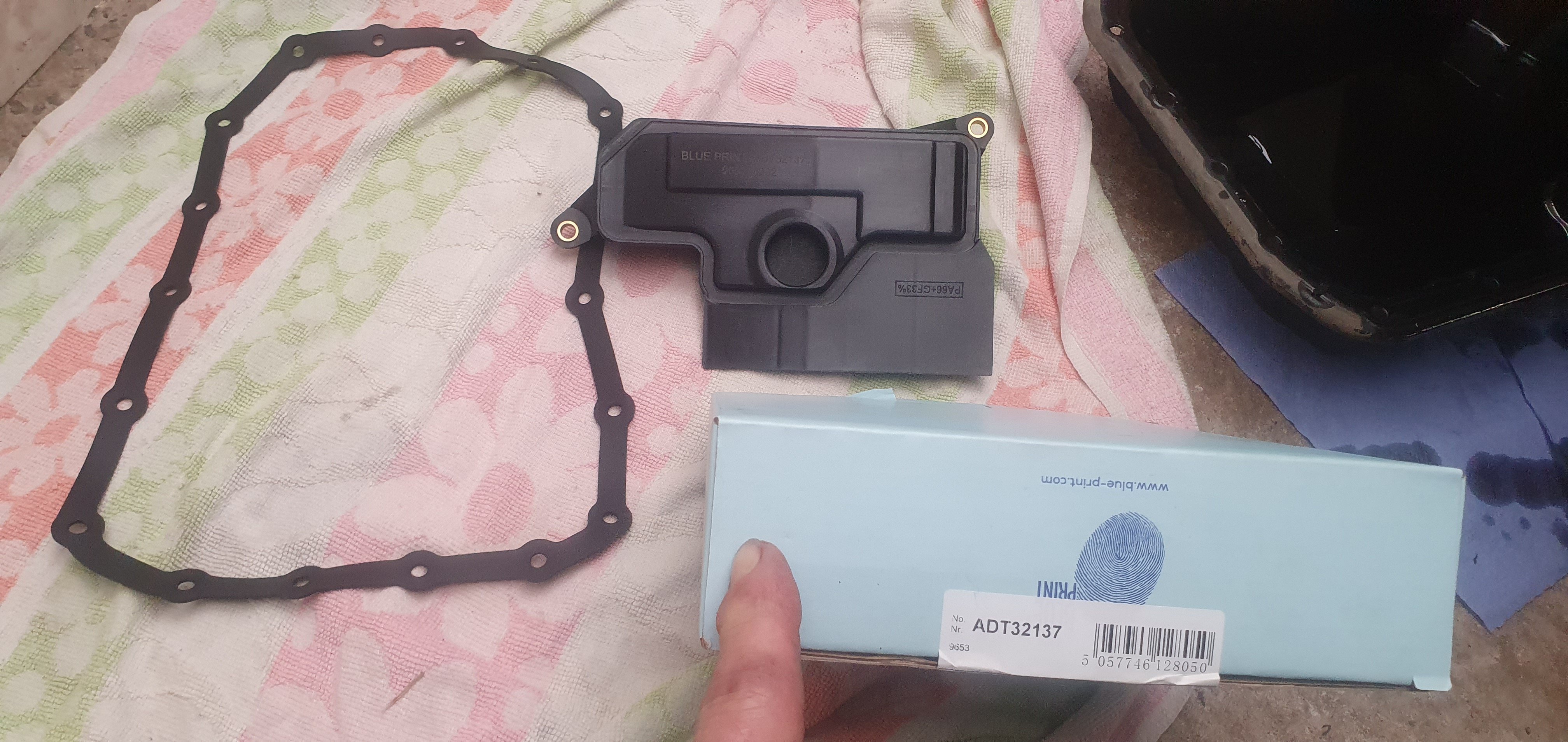

For mine, same engine / transmission as yours, the filter can be this Blueprint option, ADT32137, came with the gasket, or equivalent, and the fluid is the Toyota ATF WS, for World Standard apparently.
Edited by BigNev
hi Nic as bignev says you got blue print  ADT32137 this comes with the gasket and filter blueprint is a good jdm brand or if you want to go genuine toyota only parts buy from partsouq  genuine parts only they in dubia but shipping is very quick no import charges if you use fedex as the courier here is a link added parts to basket you need to buy filter and gasket seperatly https://partsouq.com/en/shop/shoppingCart/view  oe no.s for each item next to each part.

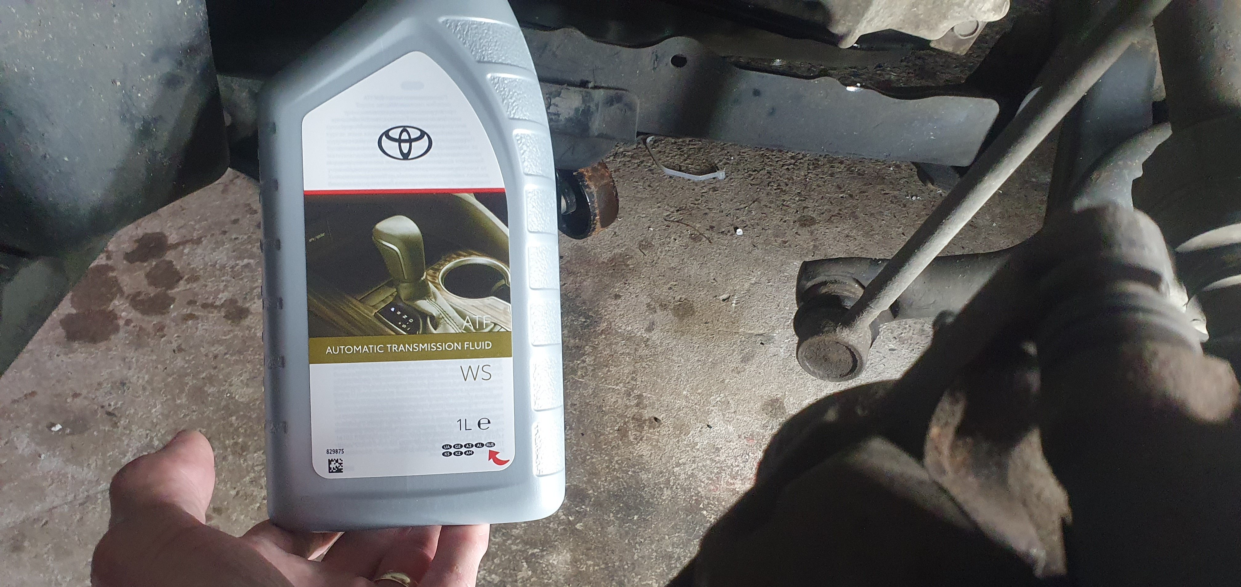

Thanks guys. I've ordered the blueprint part and will order the transmission oil too then I should be good to go
yeah, it seems a little of an unknown as to how much fluid is needed.
I've just ordered 5 litres. So once I get started, I'll take some photos etc to show the process to add to this Forum.

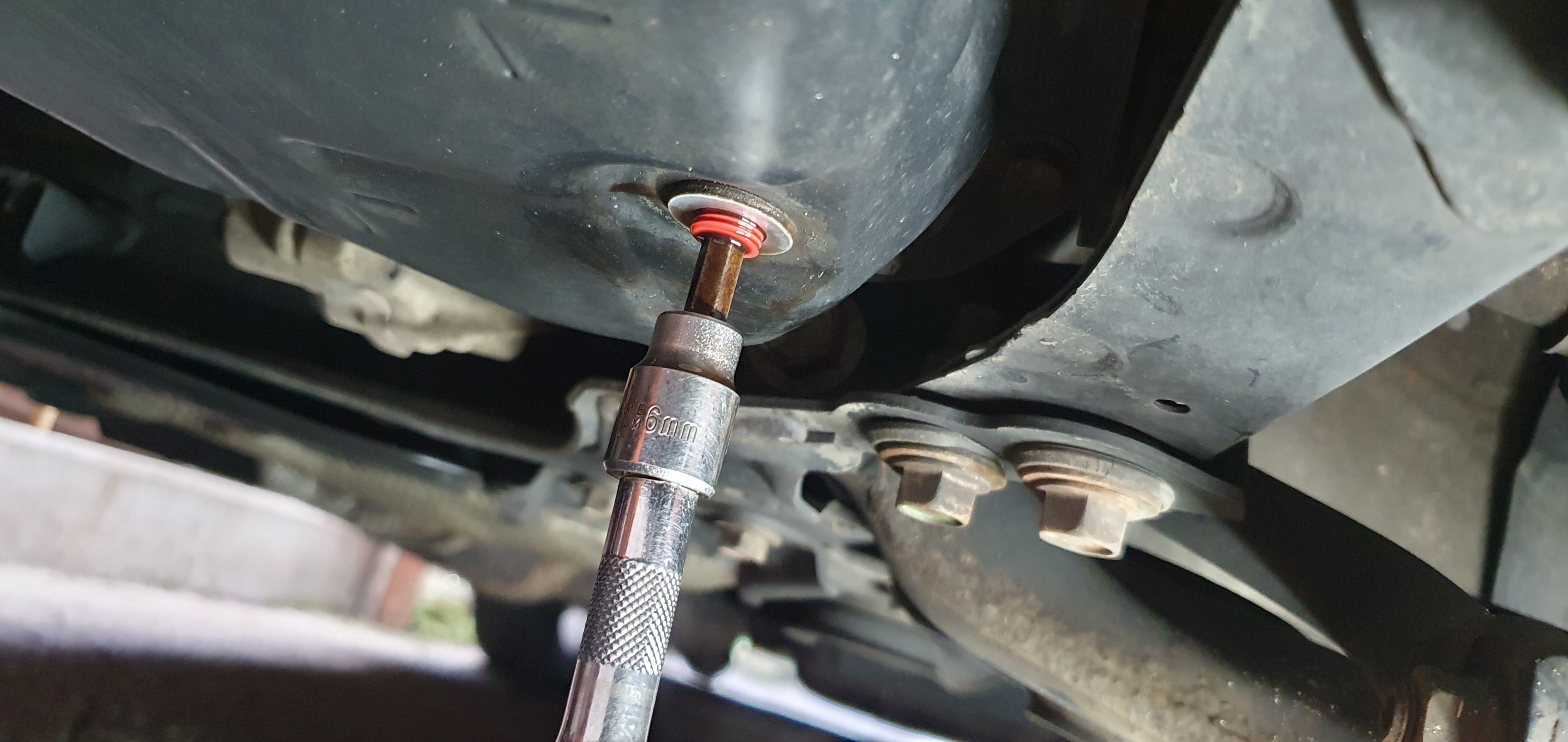

yeah I won't be flushing the whole system. As you said, it will just be drain and fill but I will remove the sump to access the filter and change this too.
