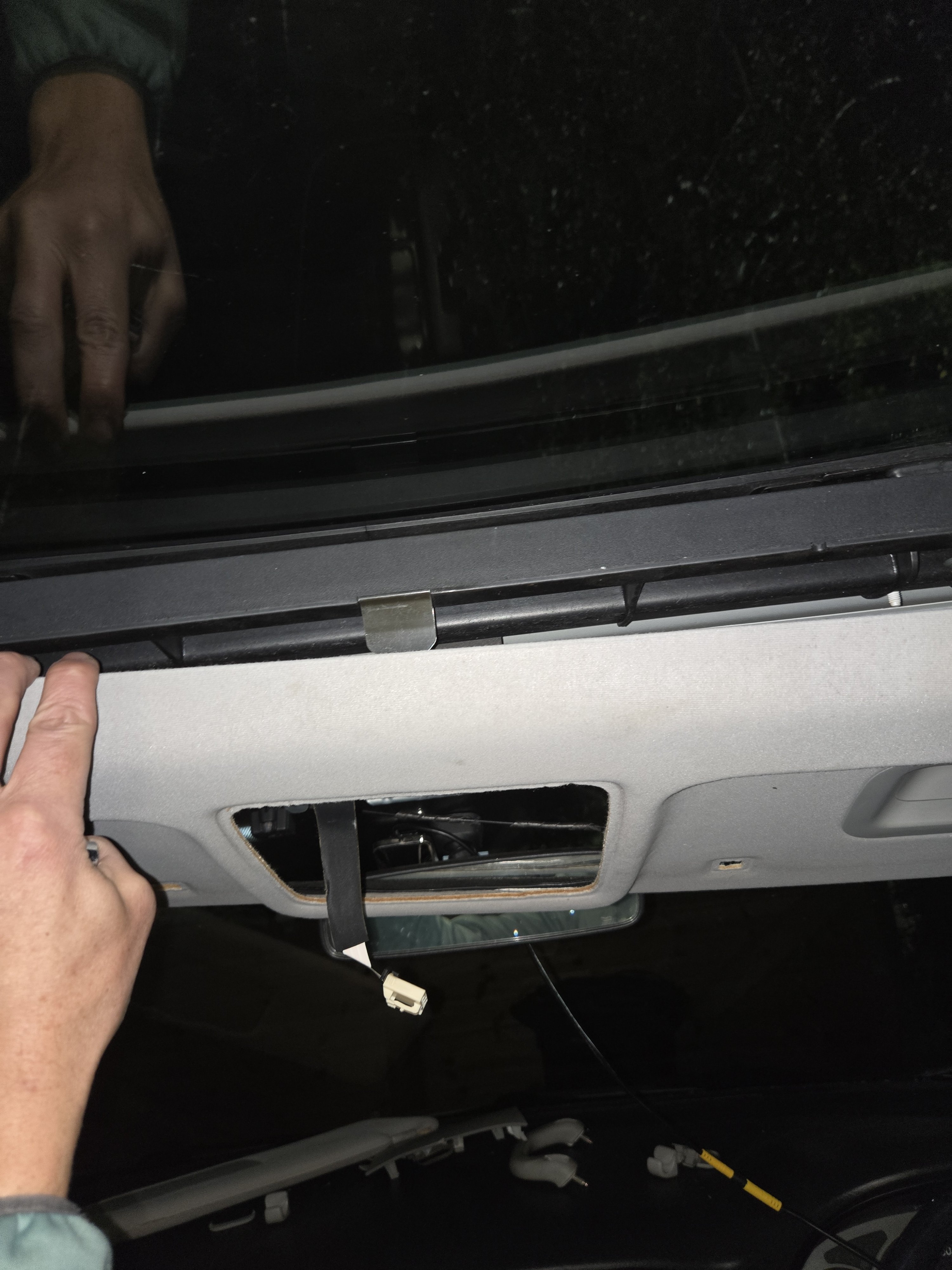

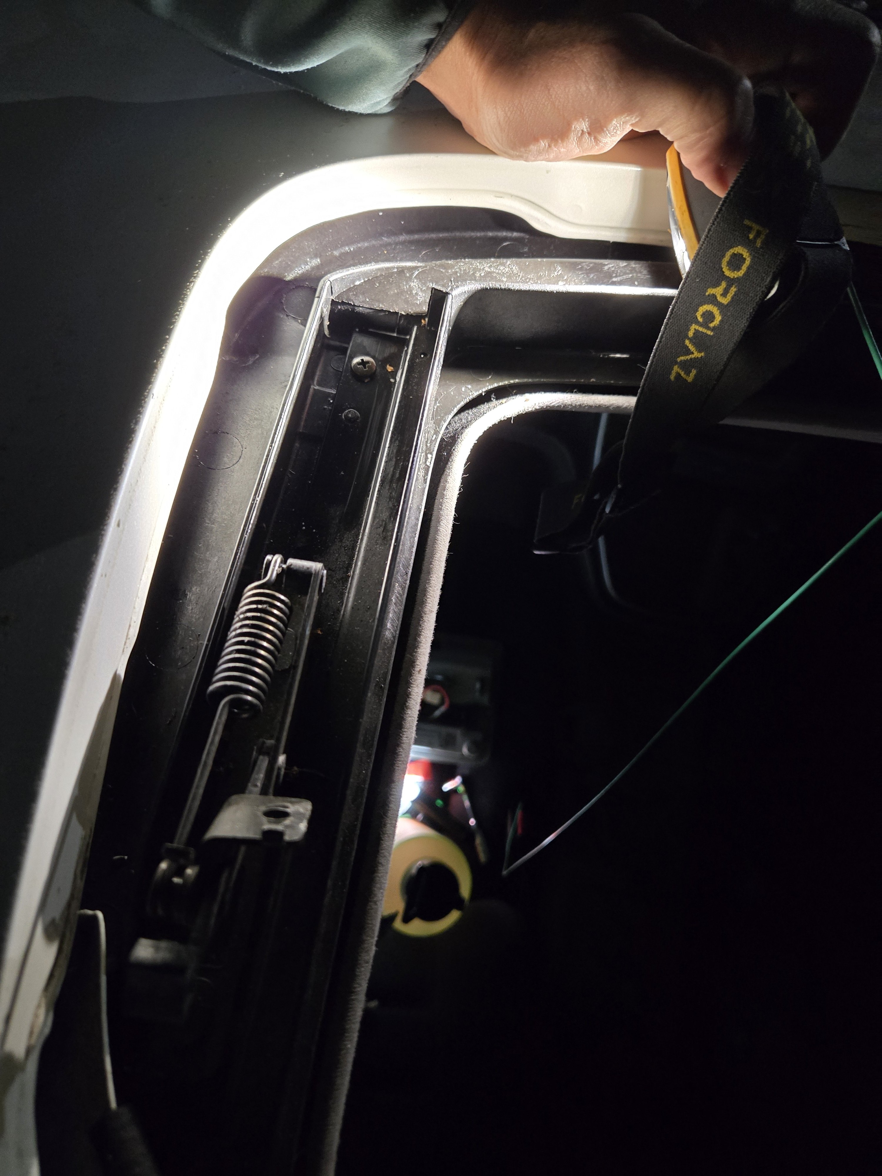

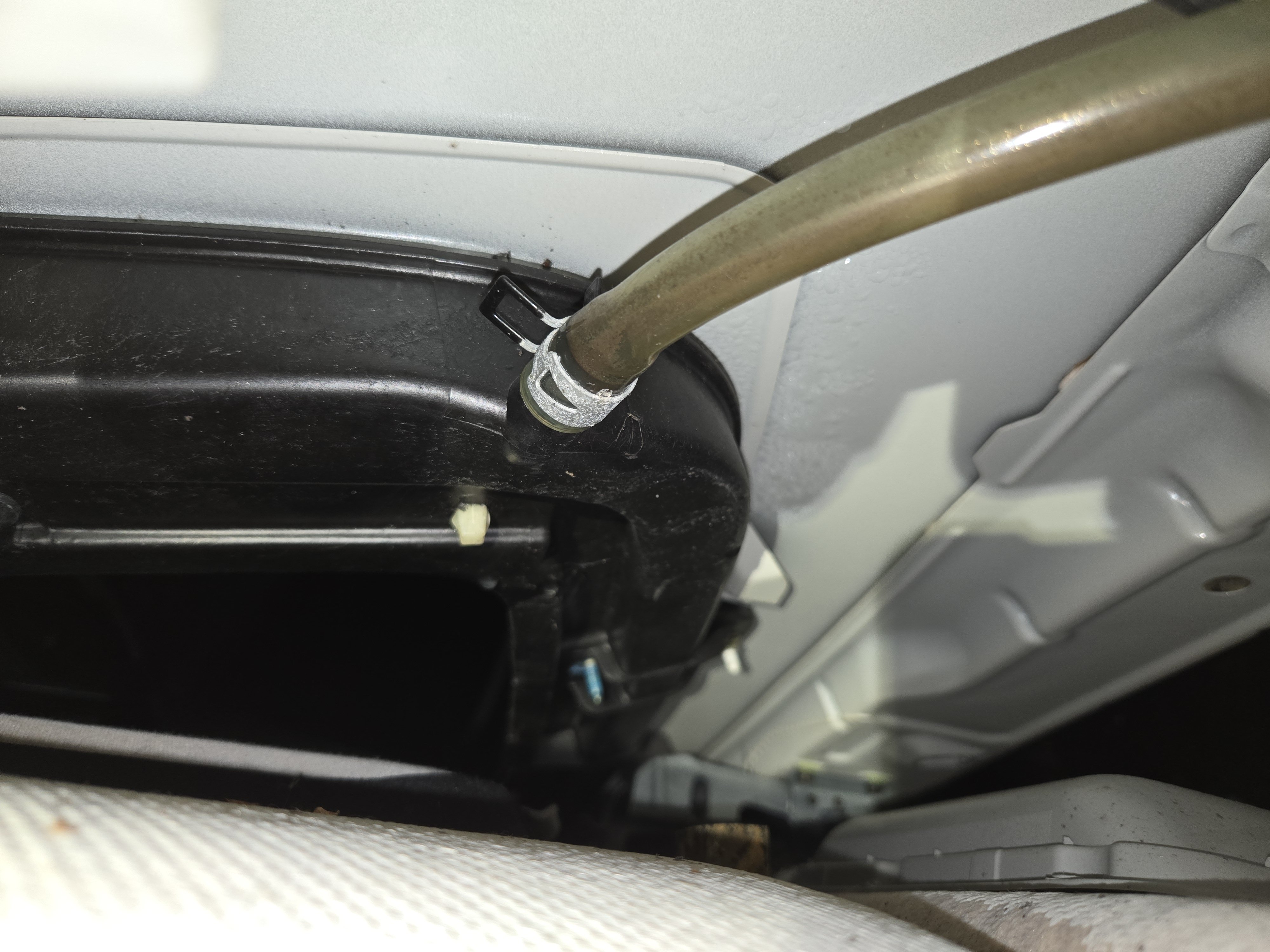

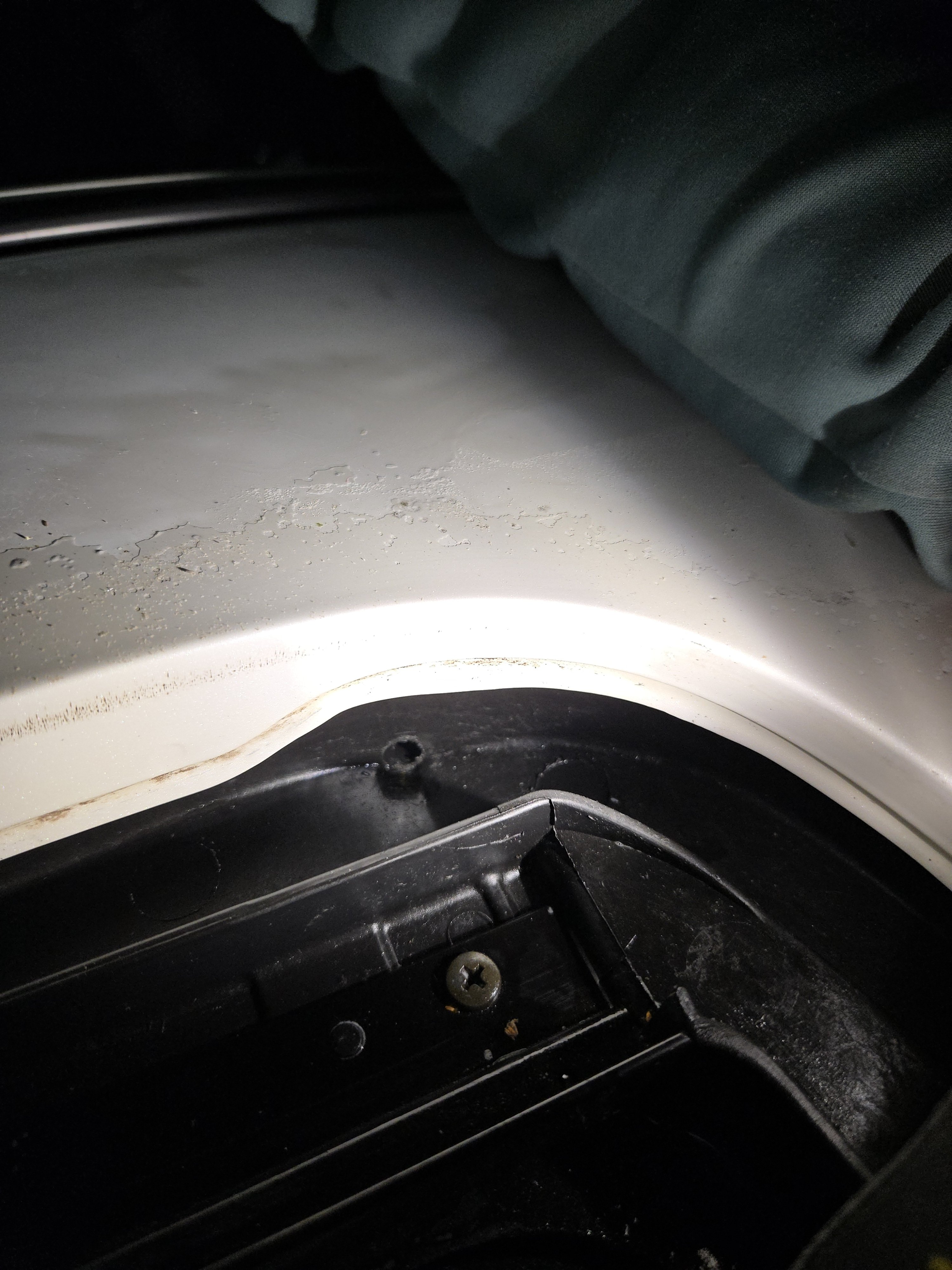

OK, I think I finally understood what you guys were suggesting. There are 2 drainage holes on front corners of the sunroof, and they were both blocked. I originally thought you were saying these were near the A-Pillar where the water was dripping down. I ended up removing the sunroof as the rubber seal and inside edge of the roof were quite dirty. It also made it much easier to clean out the drainage holes and flush water through the drainage pipes. I took some photos to show these holes and the drainage pipes. My only concern still is after cleaning and refitting the sunroof, the rubber seal doesn20251029_184555_001.thumb.jpg.e02278cc8ca74615723ae6856e75832d.jpg't seem to press enough against the roof edge. I suspect it has shrunk over time (it is 23 years old after all).
If you are concerned that the rubber seal around the sunroof isn't sealing then don't be.  The seal on the sunroof isn't designed to be water tight, hence the drain hoses. If there is a large visible gap then there could be an issue.
