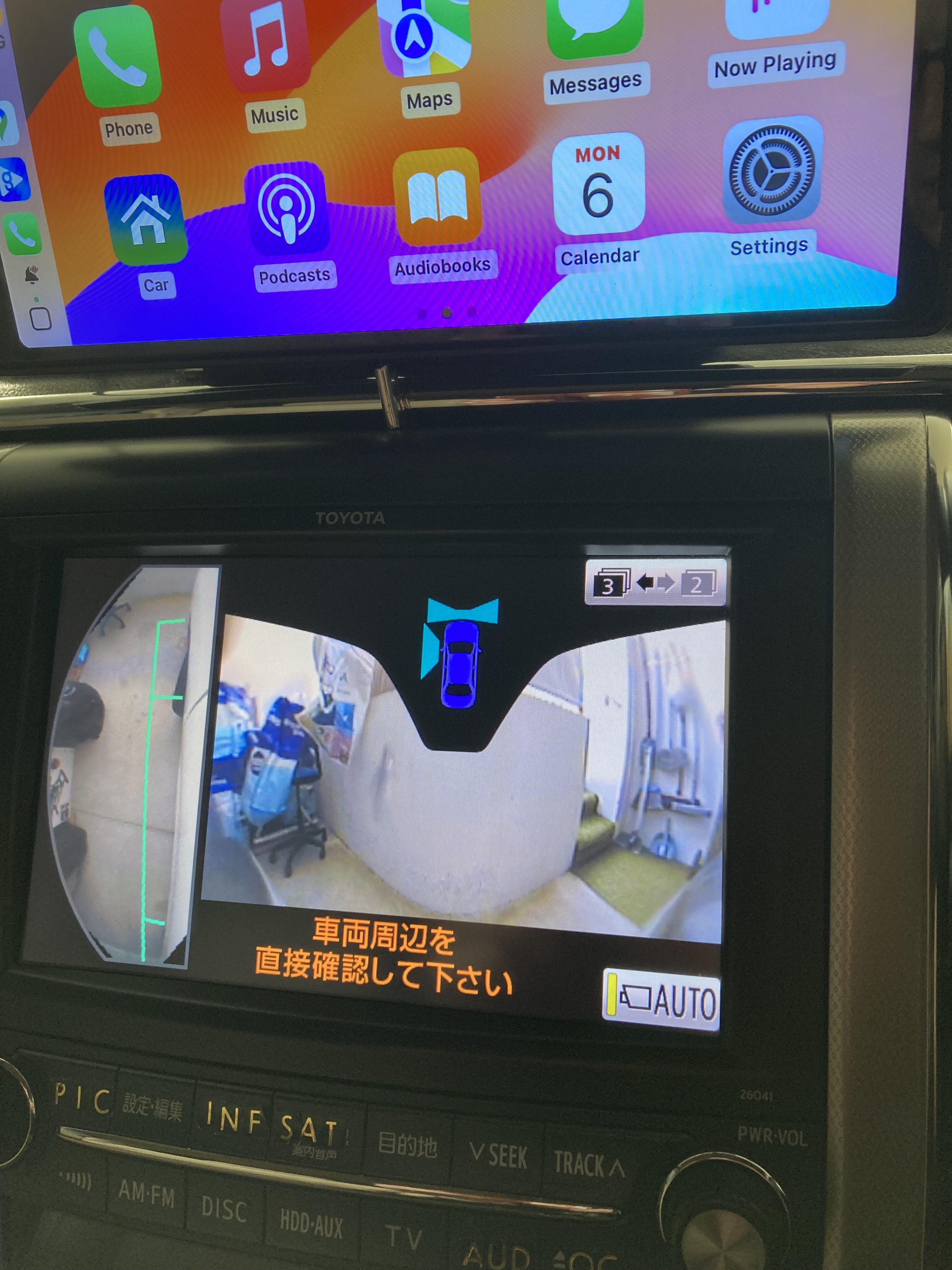

IMG_5379.thumb.jpeg.0f910a7ef07d7afb55205b54f3f77749.jpegThe button you’re referring to switches the front and side cameras on the screen when the car is in reverse pushing it again turns the rear camera on again.
i have the 2008 series 20 so I use this if your in reverse but want to see the side and front cameras handy if your reversing but want to see the side camera display.
i also have the front camera turned on auto so it displays when car slows to 4kph or less you can set this on the screen using the far right icon on bottom of screen then shows Auto.
see pictures hope this clarifies the use of that switch.
