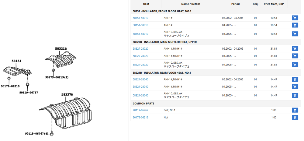

Hi All, i had a rattle near the back exhaust on breaking and reverse and on looking the heat shield was rusty and hanging down so i had to take it completely off and the rattle stopped, i am asking if anyone knows where i can get a replacement one from its a 2003 Toyota alphard 2.4 Also is it ok to drive without one and does it have to be replaced. Thanks.
Thanks for that reply i will look into it 🤗
I found it was the hole that the bolts go through that eventually break up.
I added washers to give more surface area to hold the shield in place and all is good again.
Thanks 👍

New shield from Toyota japan is £85 in case it helps anyone.

Thats for a post 2003. so no. If going on your original post.
may "fit" but you need to ideally order off the chassis number.
i suspect alot of 2003 items are NLA
