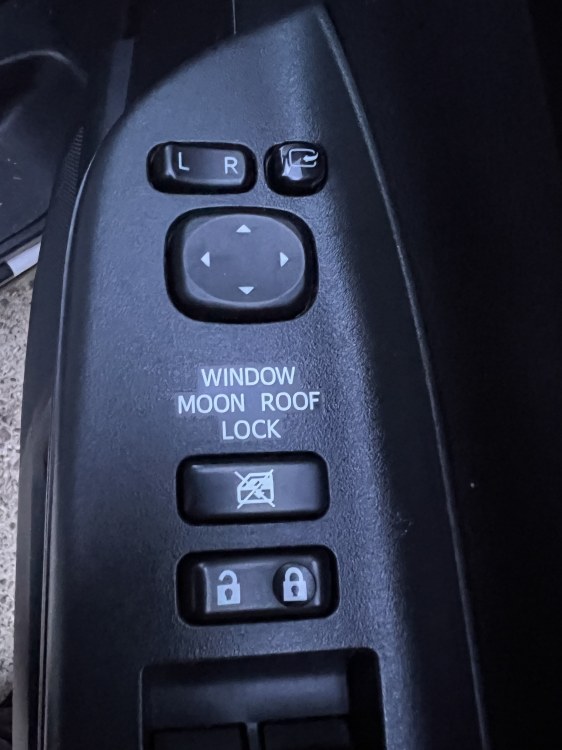

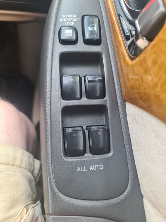

Have you checked that you haven’t accidentally hit the moon roof lock button
20240720_192724.jpg Good shout - on my facelift 2005 it looks like this but easy to find, and easy to accidentally push.
