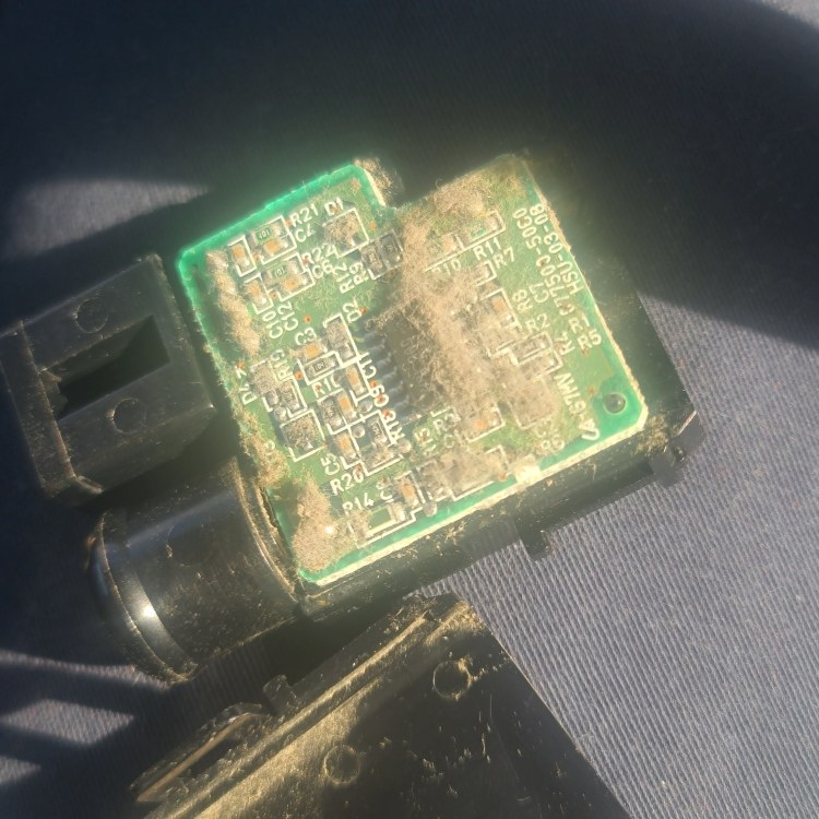

My climate control had been unable to hold a constant temperature, so along with replacing the flap actuator Servo I gave the cabin air temperature sensor a clean, and it's now working as it should.
I thought I would post a couple of pictures as I couldn't find any when I was searching. The sensor has a tube which sucks air (and dust) in, and as you can see it was well clogged up.

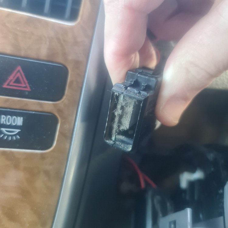

Good call - I have just done the same based on your finding. My aircon was working fine, at the front at least.
I needed a flat screwdriver on one side and a trim removal tool on the other to undo the clips
Mine was almost as fluffed up.
The plastic air tube just needs pulling off after a twist to break the decades old 'seal' that had built up.
The electricval connector was the expected 'press tab' type.
I would add that I unclipped the sides to open the unit (Denso 077500-5250 / Toyota 88625-58020) up and found the circuit board was still fluffy so cleaned that also.

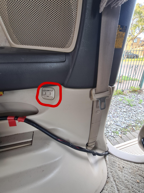

Next job will be the rear one, which I believe is this object:
I just need to empty the boot to get at it :-)
It looks like it should be removable easily enough - has anyone tried this?

I think the rear one with a pipe that sucks air through it is here, and looks a bit more complicated to access.
That sounds right
