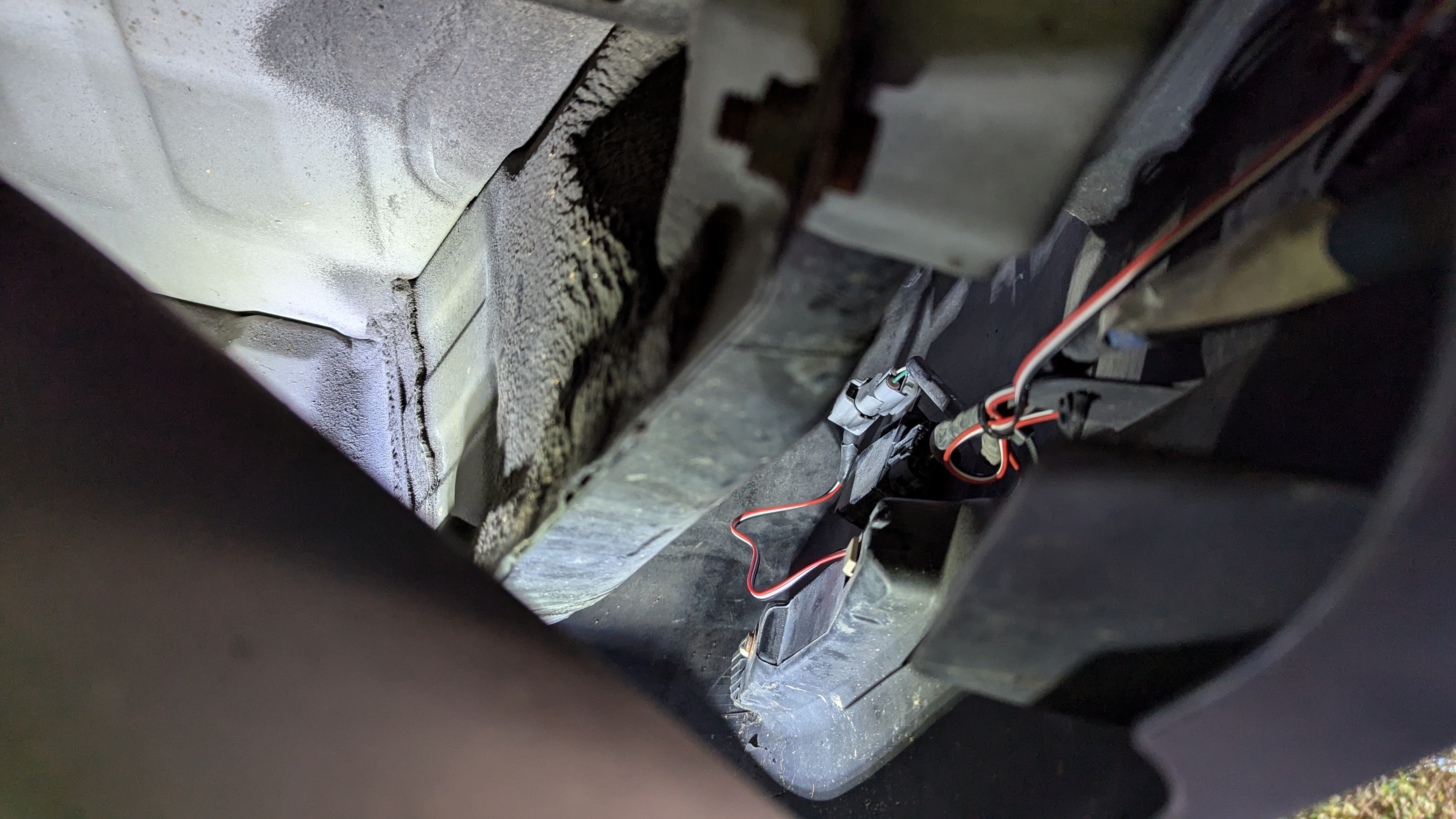

Relay needs installing in the factory socket,  passenger side footwell. Fuse is usually fitted, drivers side footwell.
You can use the existing socket located on the sonar sensor loom on the driver's side ( photos of all this is available on previous posts)
You can add two pins to the existing socket ( the side that attachs to the fog lamp, both the male and female sides were present on 3 alphards i have done, so just add two pins from summer other cheap connector from eBay)

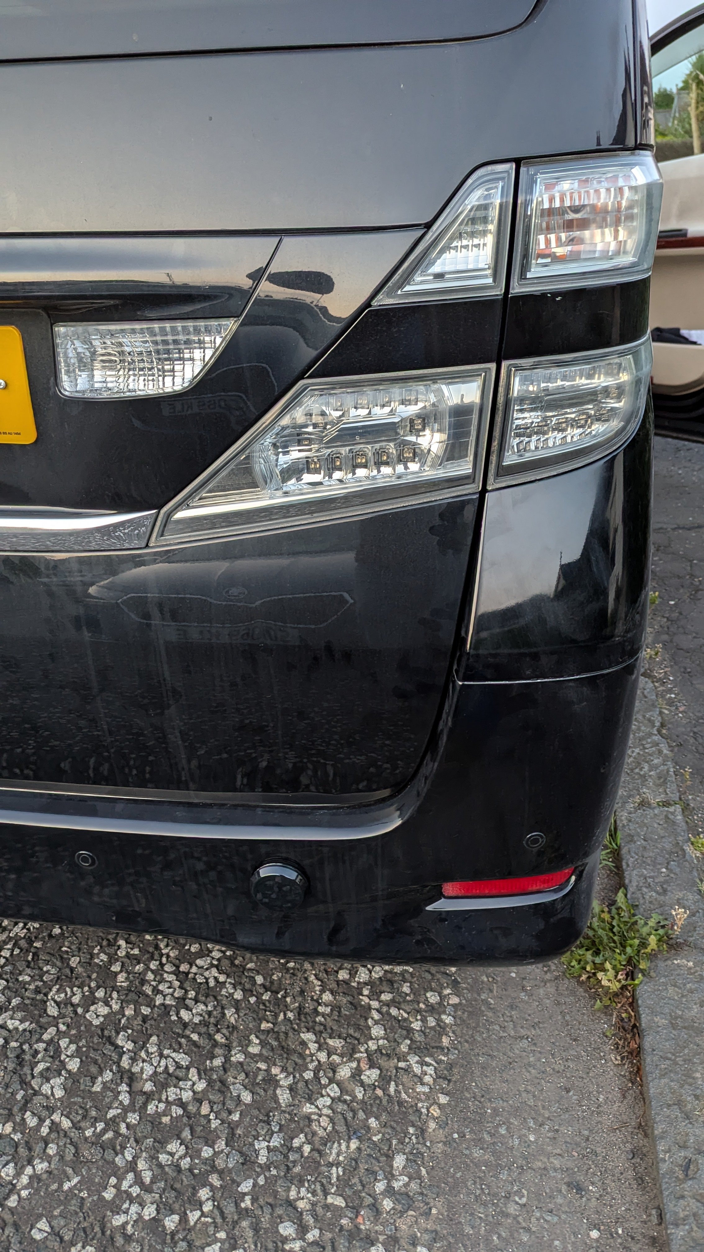

I agree, the oem rear fog looks naff, but I'm sure it's actually the entire quarter panel that attaches to the rest bumper, so it's cost will be greater than valenti.
Edit. I was wrong about the quarter panel it seems, maybe I'm mixing it up with 10 series winter kit fog
Hey Chris, thanks for the message. This is what puzzles me (and I guess I'll find out when the car arrives) because I am hearing that on 20 series relay is already there (I bought one anyway just in case). Was relay not present on your 20 series? Also, I am installing the stalk and people advise that if you're using the stalk then relay wasn't required whereas if you're adding some button in the blank space then yes, relay may need to be installed.
I am planning to use the existing socket, as seen in your picture on page 4, as it is specifically designed for OEM fog light (left blank on those vehicles that didn't opt to have it installed from factory). Do you know what connector/plug would I need to attach to this. I found the part number being 81215H and so probably this connector is right?

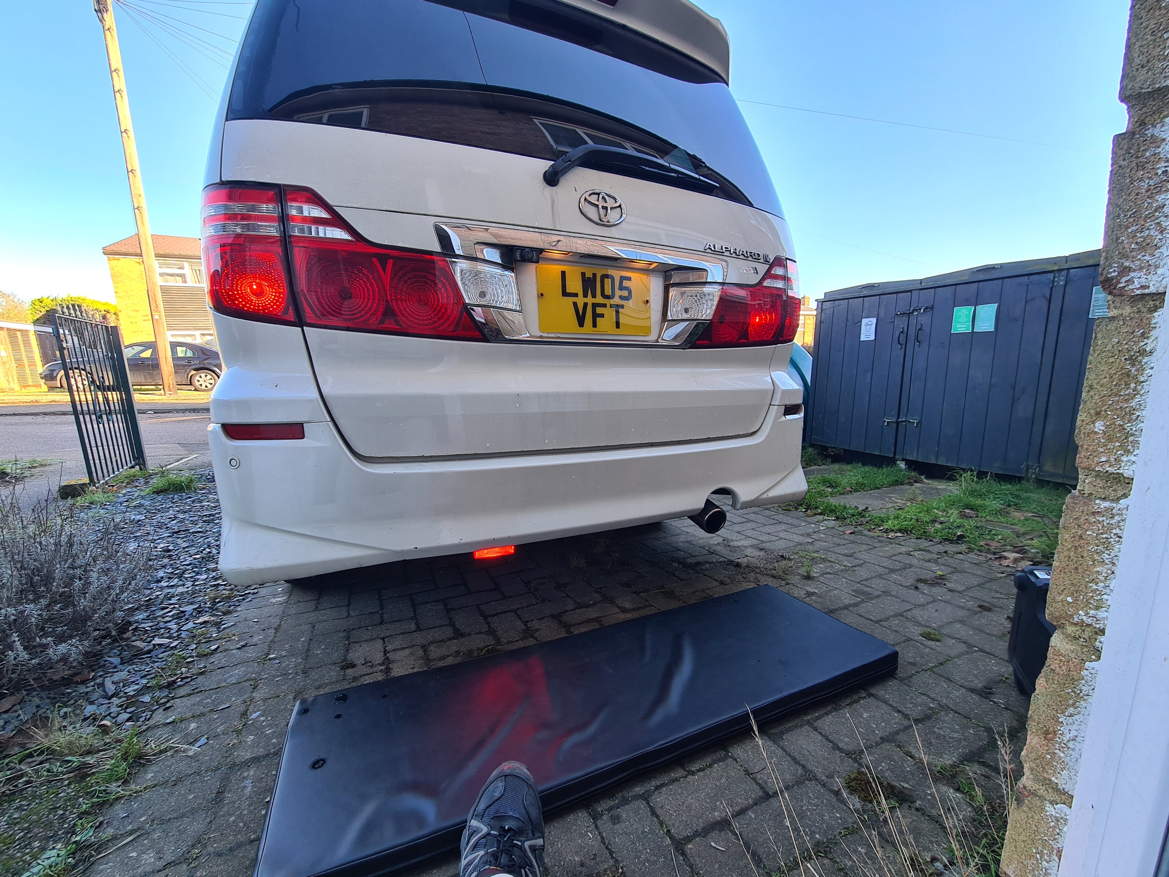

@Chris.ac You are a total legend! Fog light in, working on original loom with tell tale light in dash being illuminated. Thanks for all your help, really appreciate it.

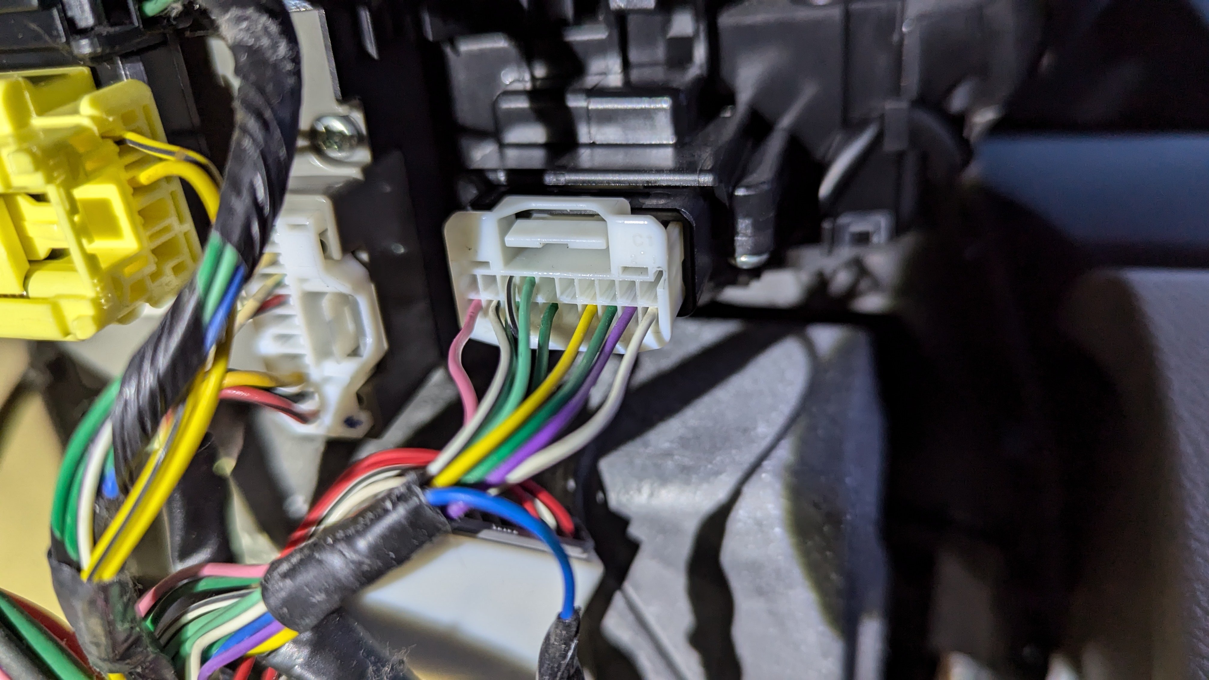

For anyone else looking to do this it's not that hard and you can do it without removing the steering wheel if you're not changing the stalks.
All that needs removing is the cowl behind the wheel so you can get access to the lighting wiring. This needs two clips releasing that you can see once the steering wheel is rotated out of the way. Then use a trim tool to pop the two sections and drop the lower part out off the way.
The lighting stalk connector has two rows of wiring, the lower row is nearly fully populated, the upper has three wires only. The rear fog one is the blue wire in that upper row nearest the steering column.PXL_20240829_193026516_MP.thumb.jpg.b21048d91e269abc8a04ec599623733c.jpg
In the picture I've already depinned that blue wire and run a lead from it to a Toyota rear fog switch fitted to one of the blanks. The other side of that switch needs to be connected to earth. I dismantled the switch to disable the latching mechanism so it became a momentary switch like the factory stalk.
Not sure why I chose that particular blank! With a relay fitted in the passenger footwell and the lights and front foglight turned on, pressing this switch makes the relay click and the tell tale light illuminated on the dash.
Final step was to access the connector behind the rear bumper. Listen to what Chris said above, it's so, so much easier to remove the bumper than it seems and taking off the wind baffle is indeed no good for access. The connector fitted has the female side plugged in for you already, all you need to add is the correct pins. I forgot to photo the actual plug but it was different from the one I bought in eBay but the pins were exactly what was needed.

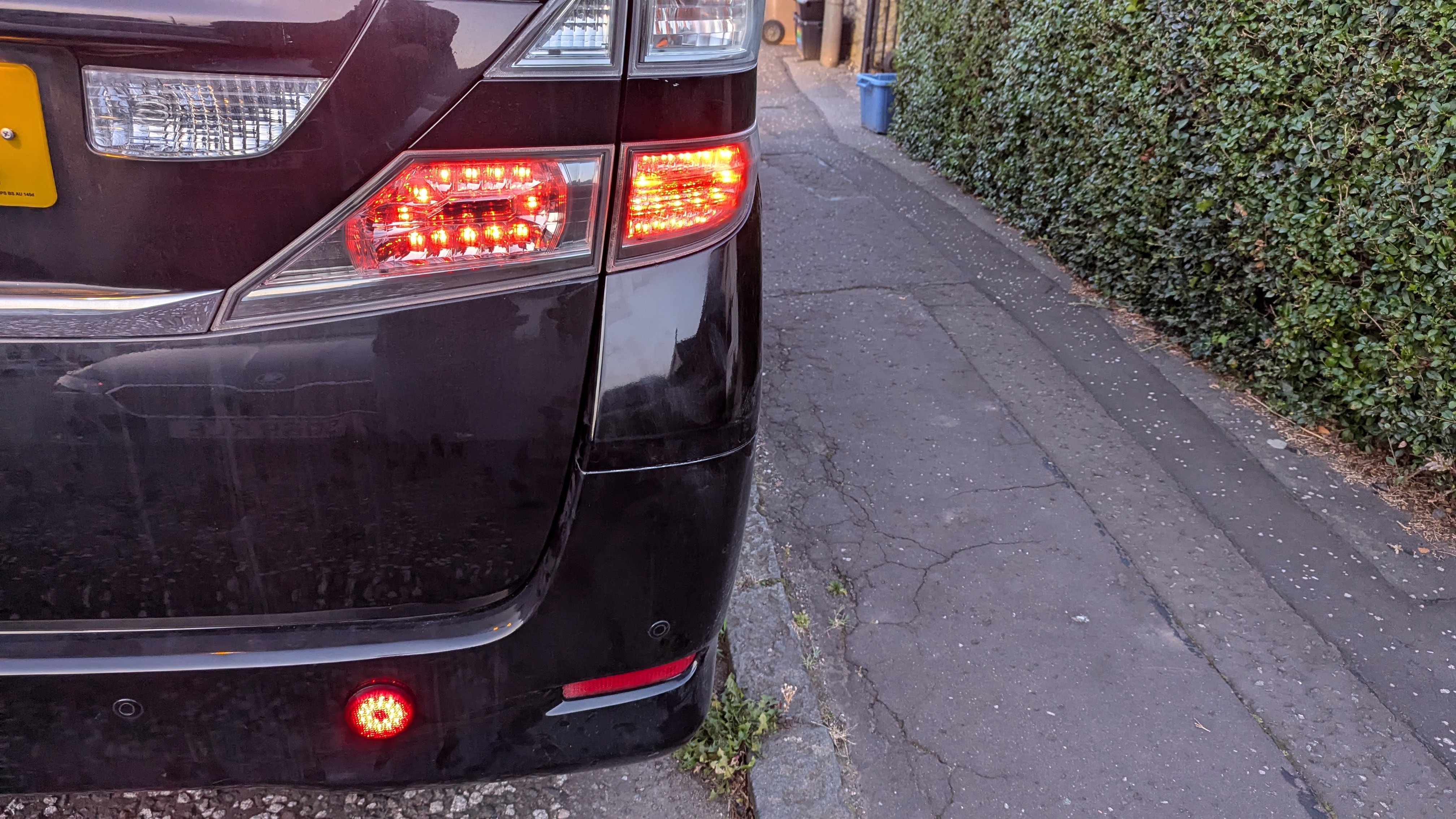

For now, to get an MOT sorted I've fitted a round smoked LED light where the towing eye cover should be as that was missing anyway. I don't think the light will last too long, but I might get a winter if I'm lucky. I'll get the proper ones from Japan next time.
Doesn't look terrible, but not the nicest.
But it does light up!
So thanks again to everyone, especially Chris.ac.

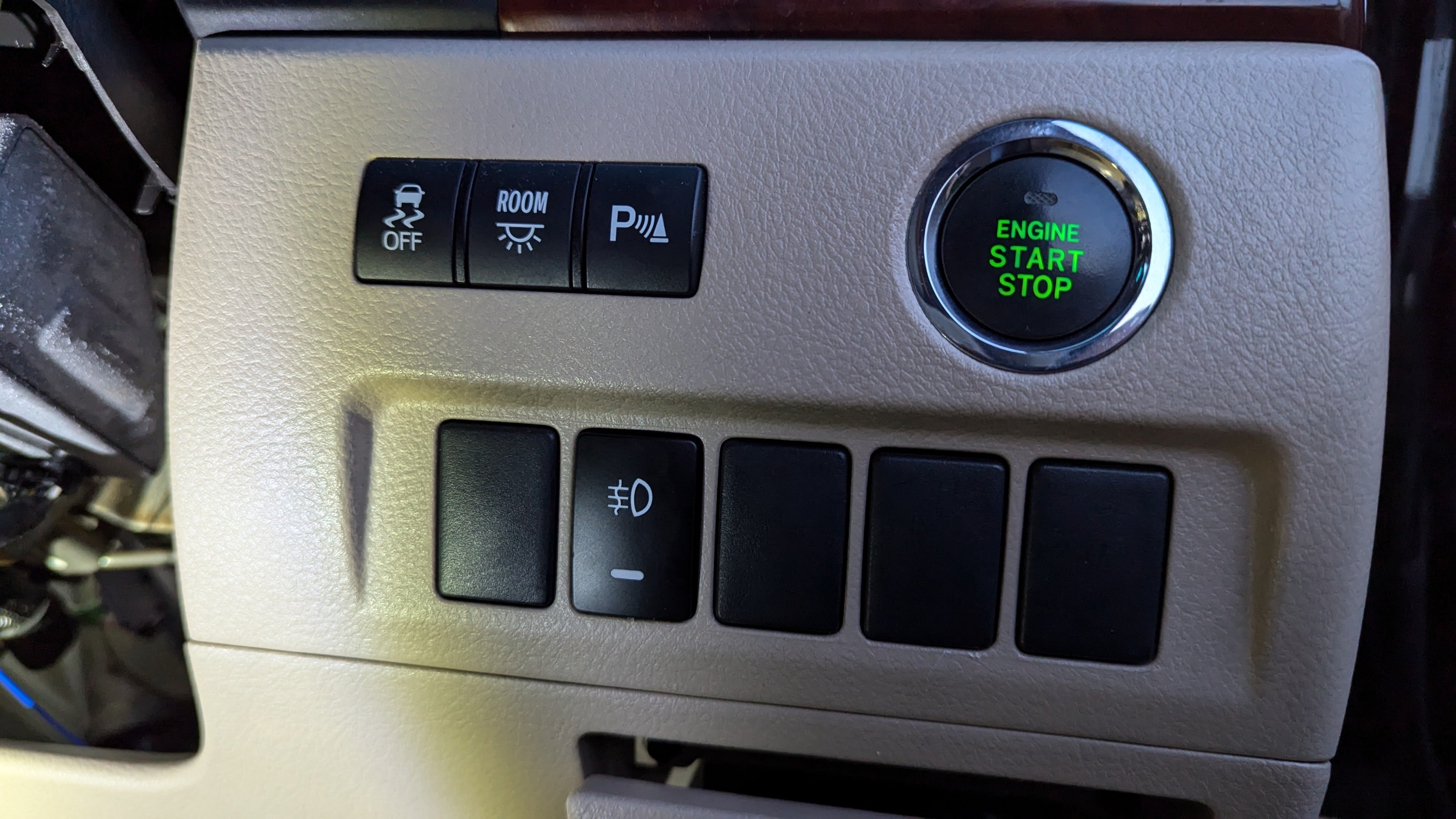

I see the switches seem to have four wires in what do you do with the other 3 and the original blue wire to red of the switch?
Edited by jonnyblagwind
Not sure if I'm understanding you correctly. Are you referring to the aftermarket fog light switch wiring or the wiring in the stalk?
Assuming you are talking about the aftermarket switch, then it needs to earth the wire I extended from the stalk connector briefly to trigger the light on or off. Most aftermarket fog light switches latch on or off, so I had to butcher mine to no longer latch so it became a momentary switch. I used a test tool to determine which off the switch wires did what. I presume they spare wires light up the switch icon when the headlights are on, something I meant to do, but have never got around to yet.
Ok interesting so essentially with the aftermarket switch I would want a 12v for light/latch and then two grounds for each the light and the blue signal cable
Sorry, thought I'd replied on my phone, but it didn't seem to submit.
Not quite. There's two LEDs in most aftermarket switches, one to illuminate the fog light symbol so you can find it in the dark and one to show that the fog light is on. As I wired mine to use the in dash tell tale, I wasn't bothered about the one in the switch and I was too lazy to sort out the illumination LED too. There could be one or more earth, depends on the switch you buy.
As I stopped mine latching the built in tell tale wouldn't work anyway, all I wired was the wire that is actually switched to the steering wheel loom and another to earth.

From various information I've pieced  together from this thread,
I should 1:
be using the blue wire from the stalk plug in the right by the steering wheel to feed the new switch
2:
For a relay of the same type as the others under the engine bay I'm the empty slot.
3:
Connect the new fog light to the spare cable in the bumper
Does that all sound correct?
