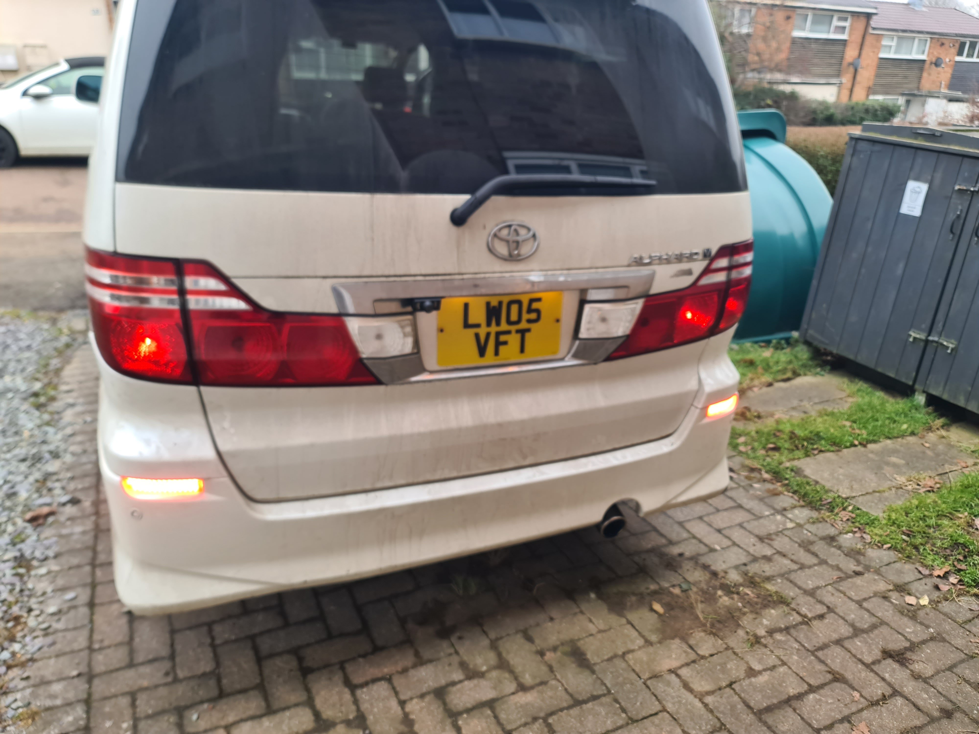

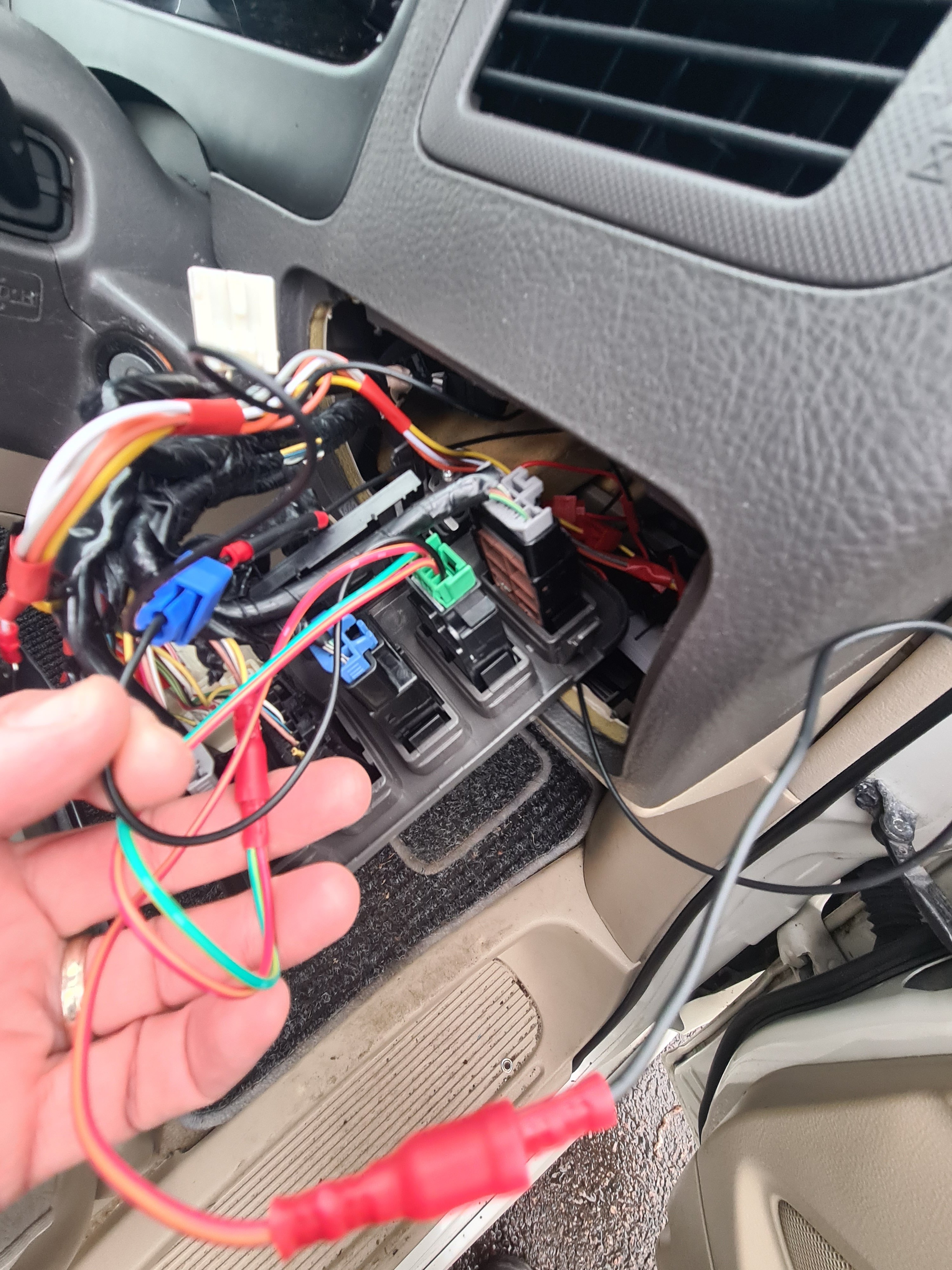

Update - having fed the wire down to the bumper area and fitting the new LED reflectors into place I now have some quite bright fog lights.
They are still fed from a simple push switch on the dashboard, which is connected to ACC rather than the headlight switch - so I am hopefully Ok for the MoT, however I would like to get a 'normal' fog light action if I can.

1) I did wire the red and white feeds to be extra bright, they are red, but the phone camera shows them more white than red.
2) I know it needs a clean
3) I know the nearside boot light is out - annoyingly it comes back on when I have the boot apart and then doesn't come on when it's all put back again.

Check this thread out, for the 10 series.
https://uk.alphardclub.com/forums/topic/1250-is-that-the-rear-fog-light/#comment-7034
Thank you Chris.ac - I am about to order the rear-fog light enabled indicator stalk (https://www.amayama.com/en/part/toyota/8414042080) would I be wasting my money?
I have already ordered the relay.
I would like to have a neat solution to turning the fog lights on and off, currently it's the stalk for the fronts and a dashboard switch for the rears.
The current fog light switch looks to have been modified already but I know it feeds the ones I have connected in the bumper - the problem is that it's fed from ACC rather than the headlight feed, so if the ignition is on the rear fogs can be as well.
Use the wiring diagrams from the thread i linked.
You could also go to the Japanese site i linked that has the full manual.
You should be able to recover the oem wiring and tap into the correct switched positive
Unfortunately, i don't have access to a 10 series to actually confirm the wiring for you.
I would suggest the enhanced light stalk would not be compatible, unless you ran new wiring, and changed or modified the clock spring too.
