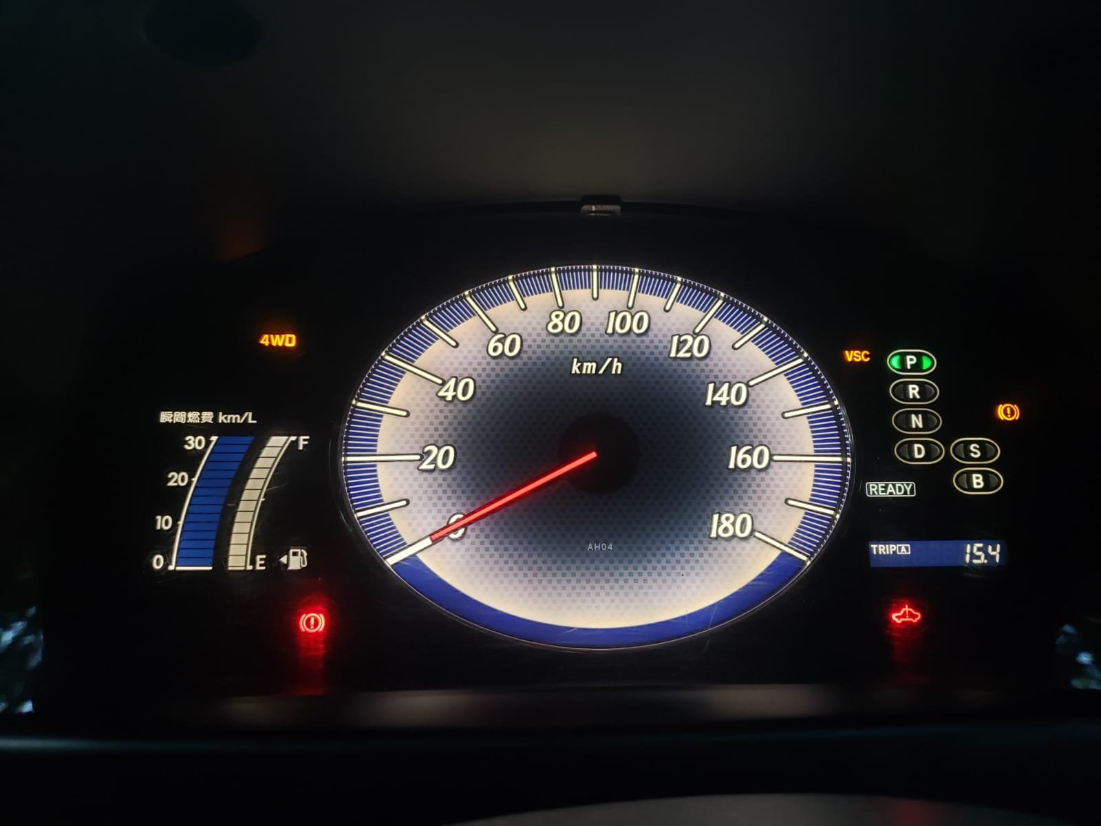

Had our hybrid 56 plate Alphard for quite a few months now and had these lights come in recently and then the hybrid system stops working.
Has anyone got any recommendation/ help

My 4 lights came on after reversing the car a bit. 4WD, VSC, ABS and the red car alert came on. The hybrid is off but the car can still be driven. The car slows down once I reach over 60kmh and accelerate again to 60. It's a Alphard 2008 ATH10 hybrid car too.
Using diag pin 4 short to pin 13 on ODB2 socket and switch on engine (without starting the car) codes revealed as follows:-
  • ABS code: 94, 95 (95 is lost com, to yaw sensor(lateral acceleration sensor) and 94 is lost com. to ABS control module.)
  • VSC code: 62, 63 (62 Abnormal battery voltage VSC sensor) (63 Malf in booster pedal force switch)
Any suggestions?

Thanks Chris. I did that before I gave up. Finally I got it fixed from a good mechanic I know and he replaced with a 2nd hand HV Inverter (ODBII read the error P3125) The 4 lights came back soon after we took it for a spin so he reseted it. The only light that remained on was the red car with the exclamation mark. Once again he took in for another check. This time he replaced the cooling pump for the HV inverter and it was gone. It's day two now and so far did another 100km drive

Finally we got fixed this mysterious issue. Here is our troubleshooting and fixing know-how for folks in the same shoes:
- the red and orange warning lights came up for us after the hybrid (traction) battery got utilized without proper cooling, i.e. the inverter overheated, because its coolant pump was weak or faulty
- we could trigger the issue with running the air conditioner at max for ~20 mins (while the car parked), or ~40 mins driving in traffic at 25°C outdoor temperature
- the inverter overheating error ultimately had shut down the car completely which if happened we opened the hood and let it cool down (~20 mins) and tried to restart it till all the orange warning lights went away. It was possible to drive the car with the red error light (car icon with explanation mark), but it ran in "gas mode" only and hybrid functions didn't work. A repairman said it doesn't damage the car, but do it in emergency only (e.g. get home in a short distance).
- BTW even after the car cooled down completely (e.g. overnight) we were able to clear the red error with restarting the car 3-4 times. Although, if we didn't clear the error and the car was completely cold the hybrid functions did work, but the display didn't show that on the power flow screen.
- we tried to acquire an original OEM inverter coolant pump (part # G9020-58012), but it wasn't possible at the local Toyota dealership here (Canada). However we could find it on the internet for $500+ CAD...
- we bought a cheap aftermarket one for ~$50 CAD from eBay (we figured we can use the original metal console, so we didn't buy the ~$200+ CAD version that contains that metal part)
- labour for changing it was ~3 hrs (~$450 CAD)
- we double-checked the operation of pump in cold state with opening the lid on the top of rights side radiator. The level of coolant fluid is pulsing (suddenly drops and raises back).
- we tested the solution with a ~300km day trip in ~28°C outdoor temperature while the air conditioner was running. Yaaaay! 😀
Hope this could help other families!
