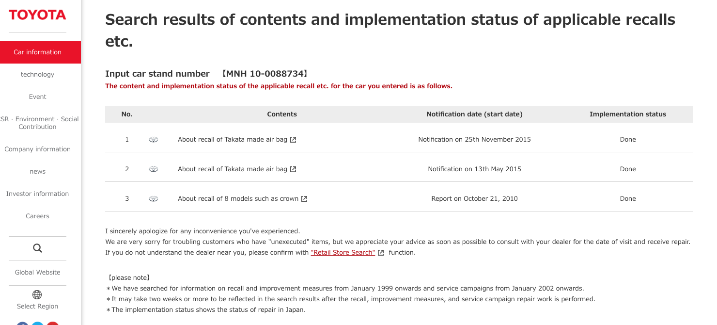

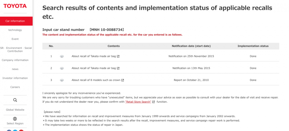

You will need your VIN in the box, the parts in red are what you need to input from your own VIN
http://www.toyota.co.jp/recall-search/dc/result?FRAME_DIV=MNH10&FRAME_NO=0088734
Frame types are something like
MNH10
MNH 15
ANH10
ANH15
ATH10
Frame numbers are 7 digits
The vehicle linked above is a vehicle that has had all the recalls done. Screenshot in english below

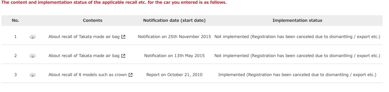

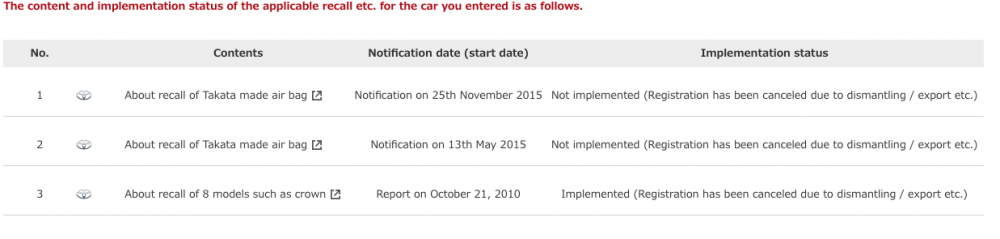

What if your Alphard is due a recall?
If your Alphard has something similar to the screenshot below then your car is due for a recall
5ad073279260b_ScreenShot2018-04-13at10_06_13.thumb.png.897c8101f335cf5175b2c73f583c297a.png
Because the car was exported then in Japan their notification to the Japanese owner ends as they do not know the new oversees owner.

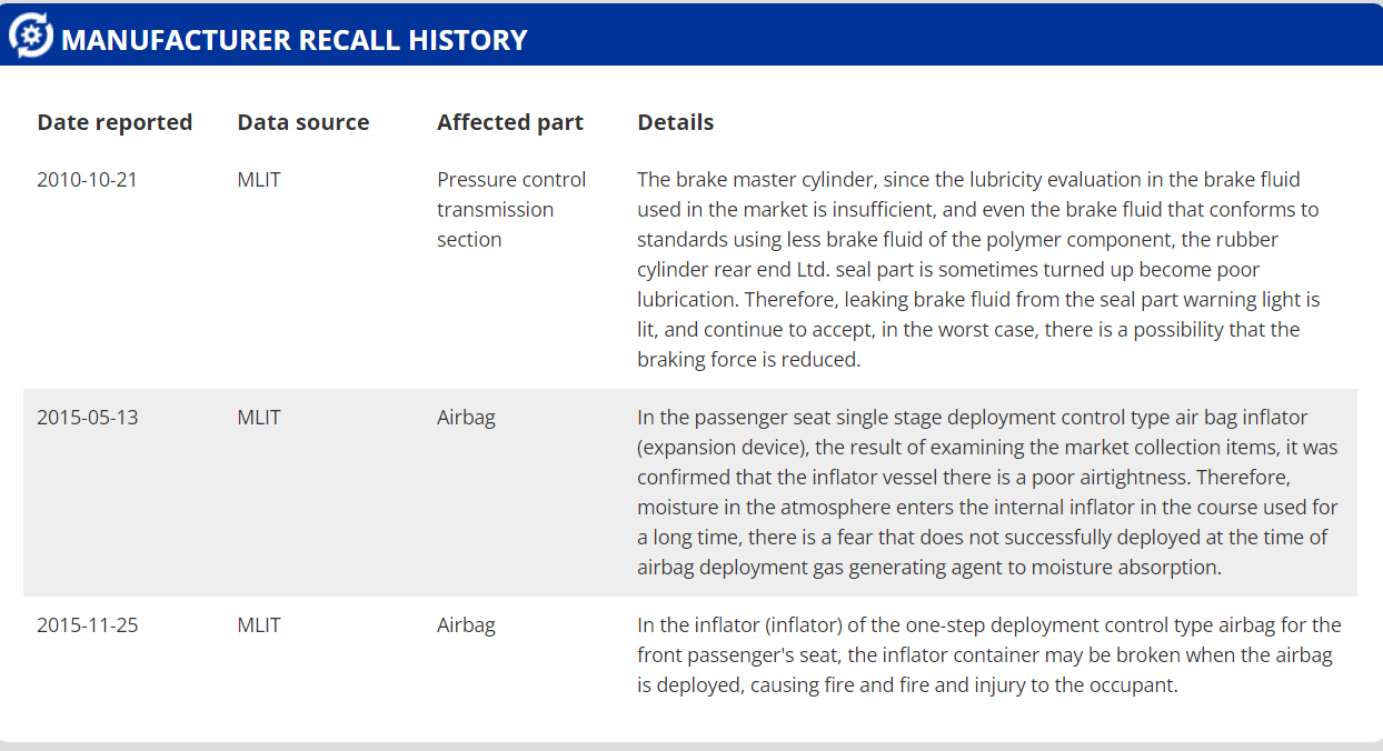

I found the link to the provider of Full Service Histories, for those of us who may want, or need, one.
I have not (yet) used this company.
https://carvx.jp/
Here is the prt.scn from CarVX.jp report what you will see regarding the recall history
