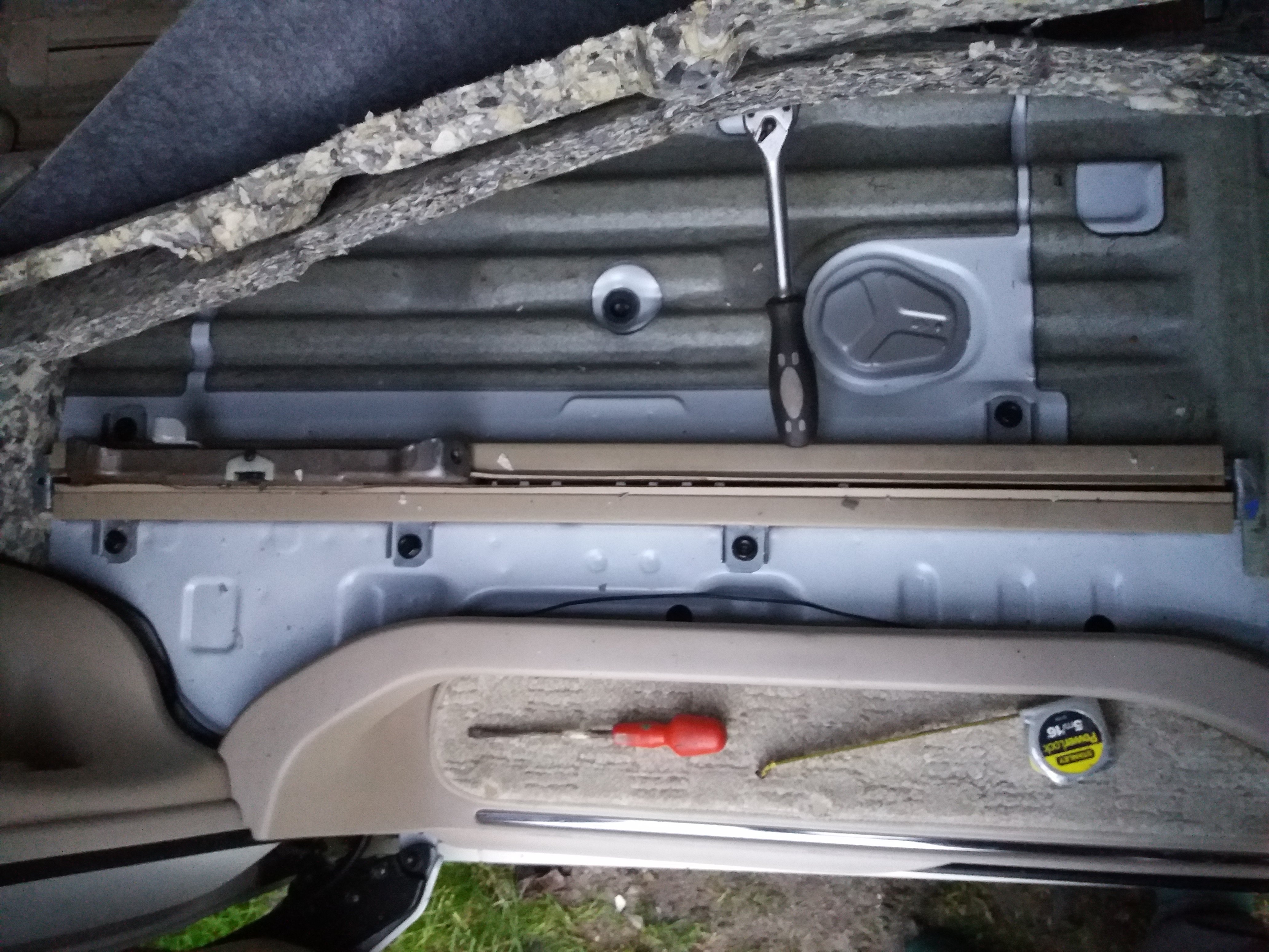

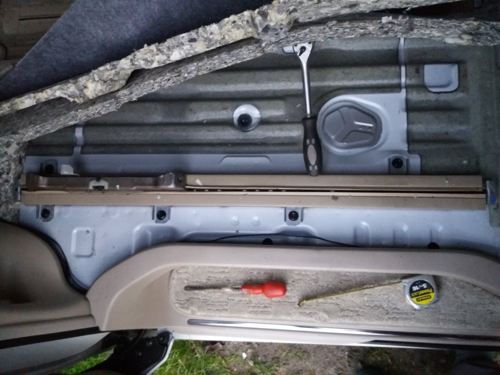

theres bolts inside the rails. you have to undo them i think it was a 10 socket or 11. however you need to pull the carpet out to get them off properly. as there are some bolts on the ends and side too.
I've just been doing it today. The bolts are either side of the rails 15mm.
One of the rails extends all the way and is shared by the middle row single seat.
I've just removed the back row seats, so had to remove the long rail and slide off both shuttles, then replace the shuttle for the middle row seat and bolt the rail back down again.
I took the short rail out completely. I did consider putting the short rail back instead of the long one but the bolt pattern is different.

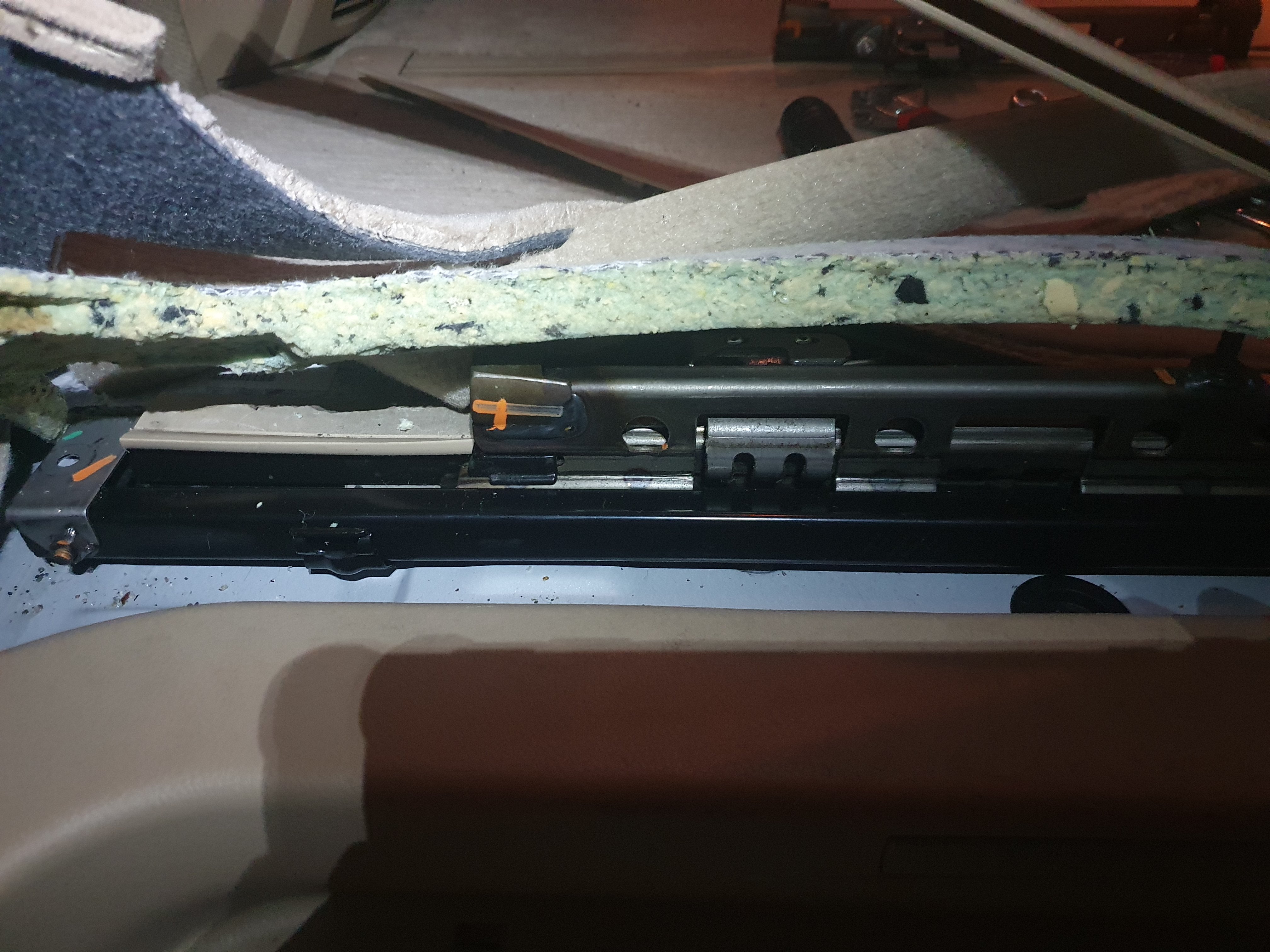

Hi there, I have removed the mid row seats but i wish to keep the rear seats in place. Is it possible to remove only the prominent bit of silver metal sticking out but leave the black rails there?
Edited by Luke Perrin
Hi Luke
I removed that prominent bit by unbolting the whole black rail and sliding the prominent bit out of the end of the black rail.
Then I refixed the rail back down.
It was a pain.
Perhaps somebody here knows a better way to do it
