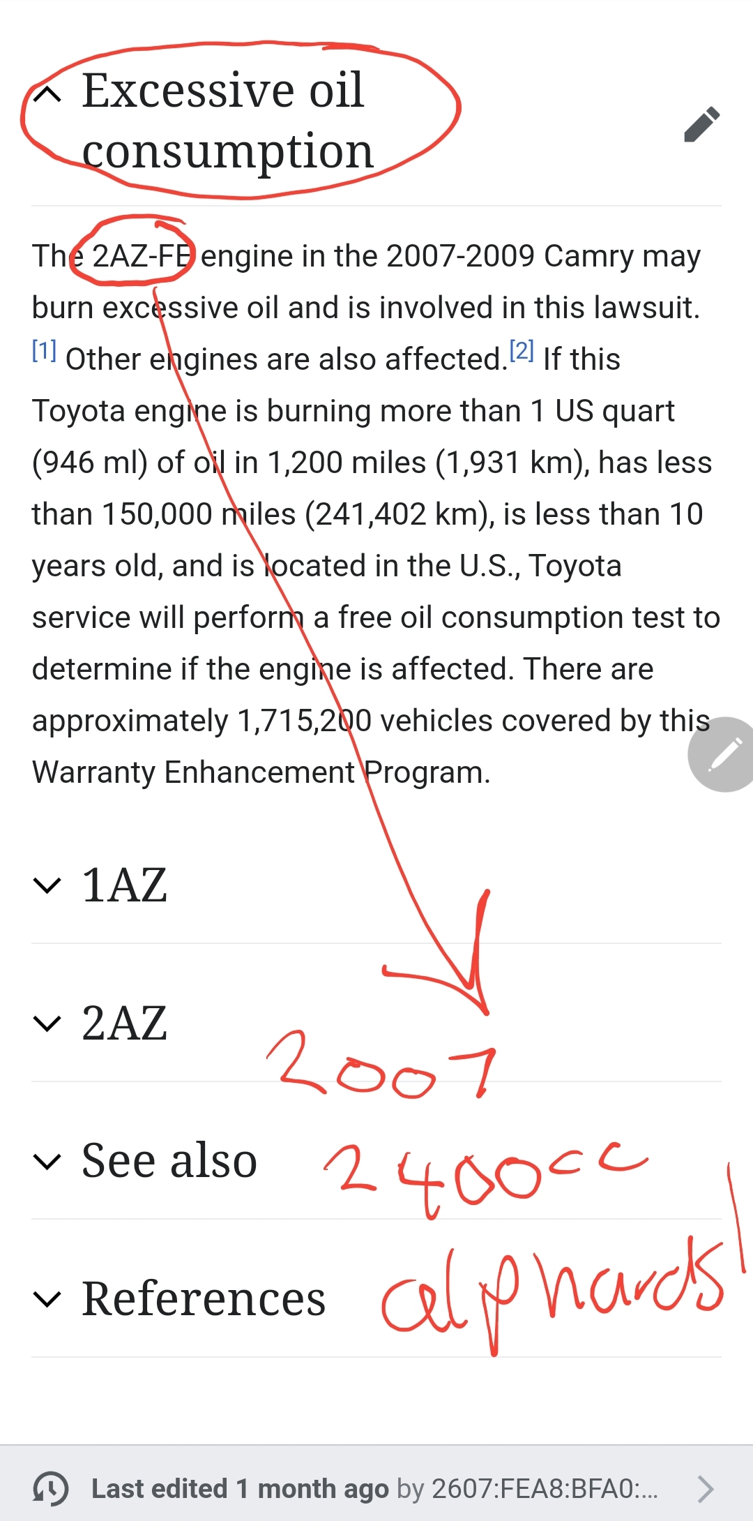

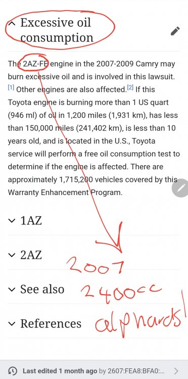

Hi Suzlize my name is Gerry mclean. I posted  about 2azfe engines recently and oil burning issues. Pleases attached Wikipedia entry about these engines.
