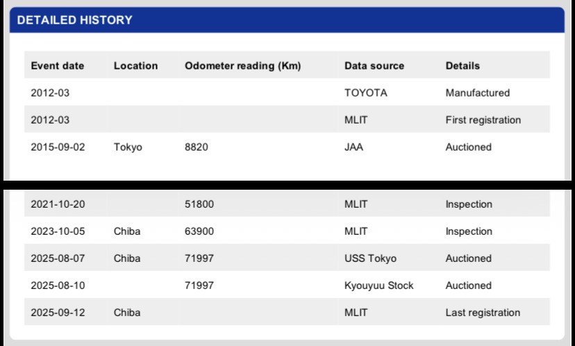

Is there any paperwork showing who the importer is? it may be worthwhile getting a CarVX (https://carvx.jp/) report.

The vx report is all good, the car is in very good condition just need the underseal.

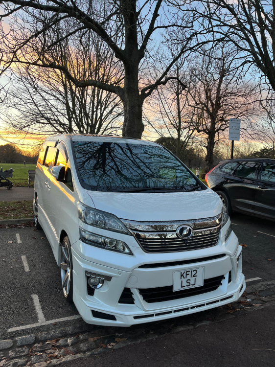

Thought I recognized the car from the aero & the wheels.

Quite a rare front bumper on yours, as the aftermarket manufacturer has stopped producing those.
This is what the report say

The car lived in and around East Tokyo. The car didnt sell at auction in August of last year. It was then put into fixed stock

Out of interest, did the importer tell you which brand of body kit in Japan that was?
The front lip he said was done by Admiration
