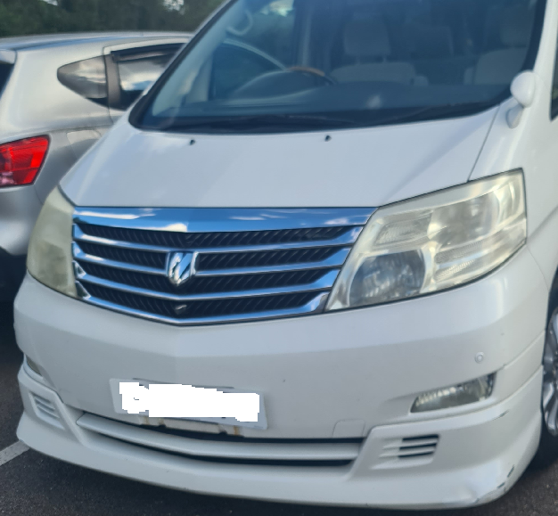

33 minutes ago, MonsterS said:
Normally bottom front ns and os bumper little black boxes...
Would I be able to see them from the front or are they hidden behind the bumper and I would need to be underneath?
I would be surprised to have the button fitted and active but the rest of the system not existing - but saying that who knows what its history is.
I can only imagine that they could be behind the holes with the two slats under the fog lights.
I checked the manual the other day. It uses the camera and the head unit. There are no sensors anywhere for the lane assist.
Cheers Richard, the next time I am crawling underneath I will take a look for the sensors that Alex mentions, but in the meantime I will assume that as the front cameras don't work on the replacement WinCE head unit then that would be why the lane monitoring system activates and then turns itself off.
