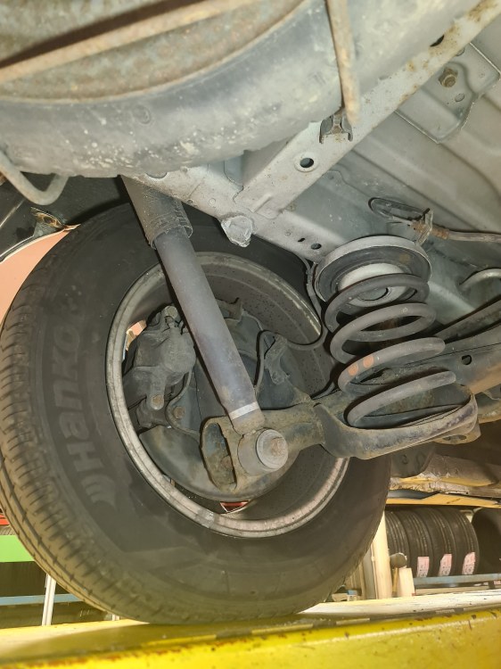

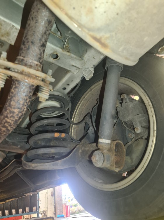

The only help I can offer are a couple of pictures I have taken of my 2005 rear suspension.
From what I can tell I would say that there is a rubber ring on the top mounting,. but not the bottom one.

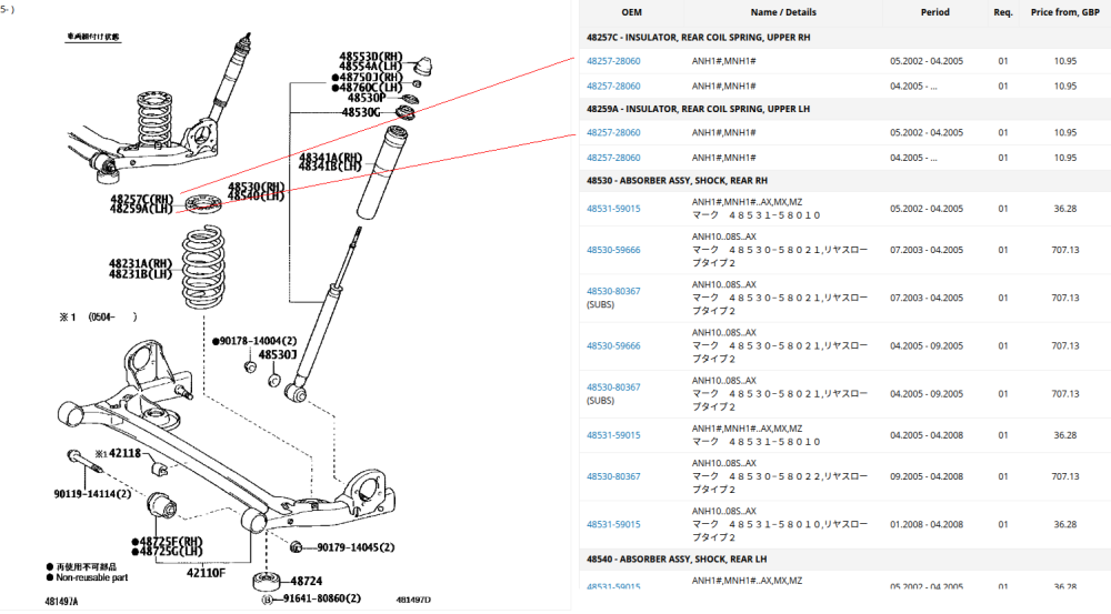

Oh and this from amayama.com:
Which confirms and gives a part number - 48257-28060 - there are several sites that seem to have this part - looking at prices amayama is cheapest if you don't mind waiting.
