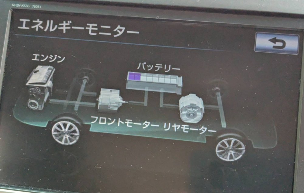

This is the screen on the display. You can see the rear motor on the right side - when it's in operation the arrows show power flow from or to the battery.
Obviously no help if you have replaced the head unit! If there is a problem with the rear motor then I would expect a 'check engine' light as the car will be down on power as only one motor is operational.
