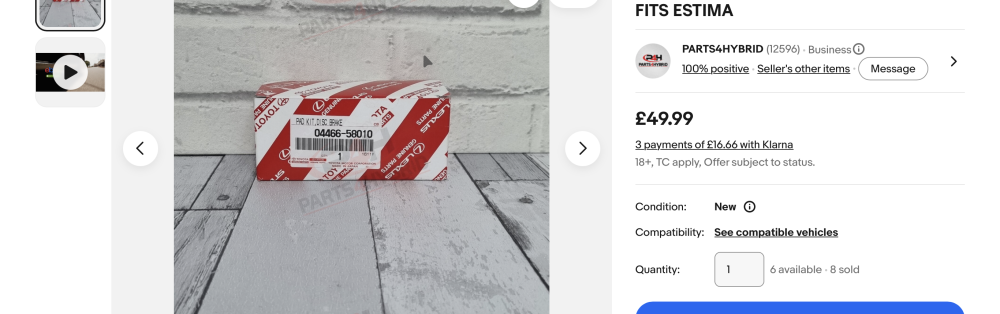

Latest set I’ve bought are these which my mechanic believes are also incorrect.

Amayama says the part number is 04466-58010 which is what's shown in your listing. Has yours perhaps had any upgraded calipers, maybe in Japan?

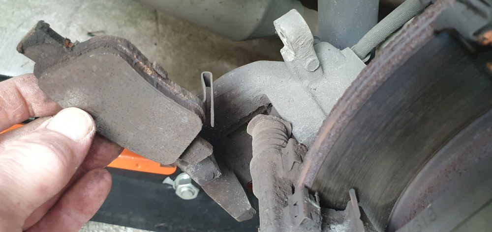

If you hold that pad next to the outside of your wheel, does it look the same size as your current pad?

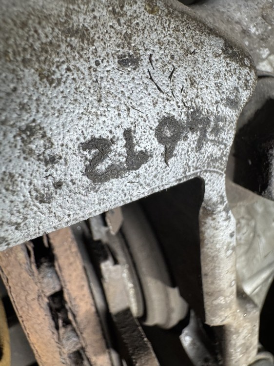

Mechanic suggests I’m gonna need to replace calliper's, carriers and disks to get this sorted which sounds crazy to me - I ll add picks soon as i get them as pads must be available.

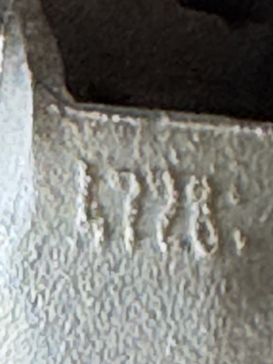

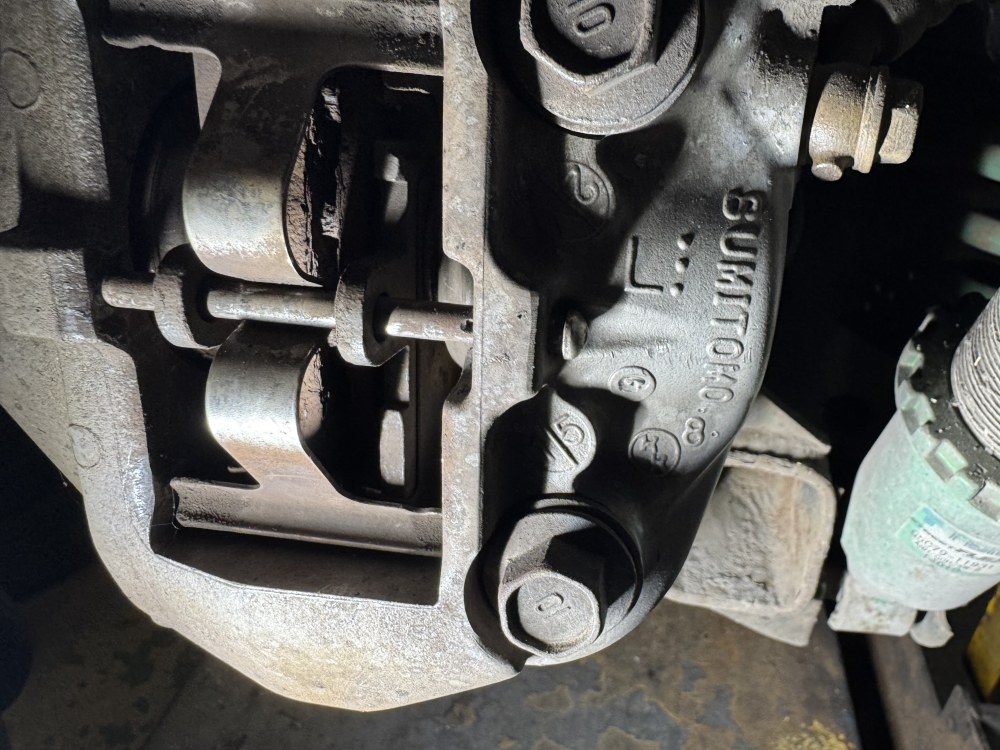

I ve dug into this more over the weekend and have discovered exactly that Gents, I have Sumitomo re callipers with a part number on the Pads that’s rubbed off.
We re gonna strip it down and again and take some measurements. Really dont want to replace everything to replace Pads as brakes work great.

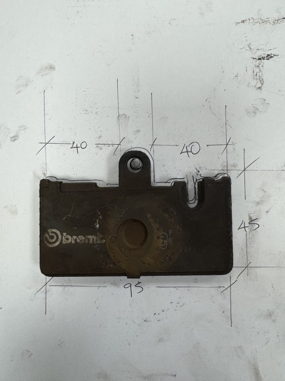

Before now, a long time ago on an import Impreza, back in 2000, I took thepads out, and drew round them, and went into the autofactors. Easily sorted for someone behind the counter assuming they can be bothered!
Yeah - plan to take Exisiting Pads out and measure them etc - Good idea outlining with a pencil 👌

At the very least measurements off the existing pad may give you something to go on.

How tall is it including the loop at the top?
https://size.name/en/catalog/brake_pads?length=96
finds some of the right shape, but they're 62mm tall. That appears to include the loop.
Searching on the Blueprint part number ADT342125 brings up a series of matches:
https://www.simplycarparts.co.uk/products/adt342125

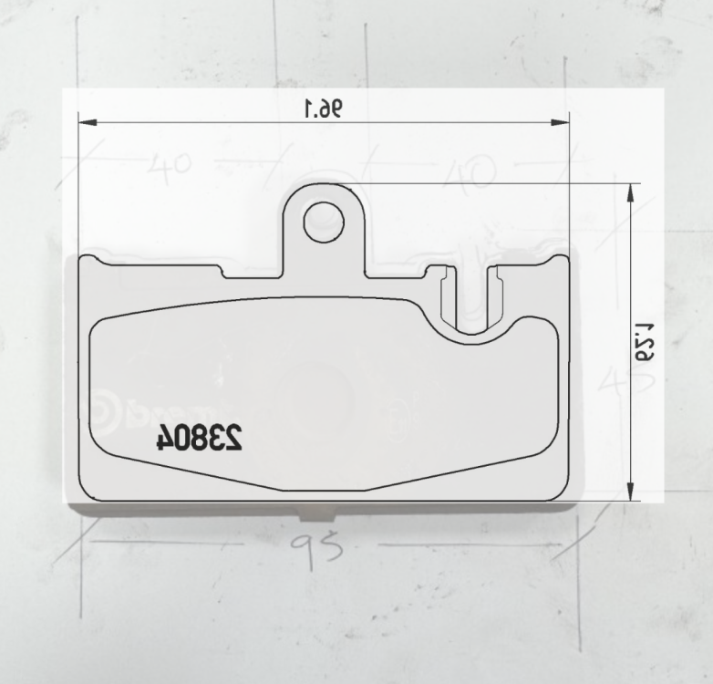

and on the Toyota part number 04466-50100 leads to the Brembo part P 83 059:
https://www.bremboparts.com/africa/en/catalogue/pad/P_83_059
which has a drawing. If I overlay that on your picture it looks a touch smaller but would maybe fit?
Anyhow, someone is selling the Blueprint part on ebay for £9, so perhaps worth a punt?

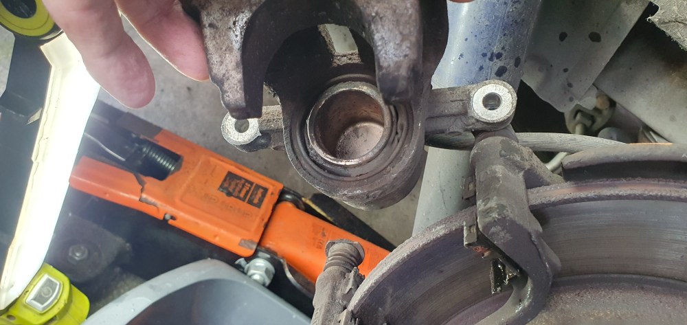

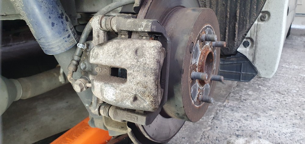

OOH!!!
Twin opposed piston solid caliper - very definitely upgraded!!
And VENTED rear discs too!!

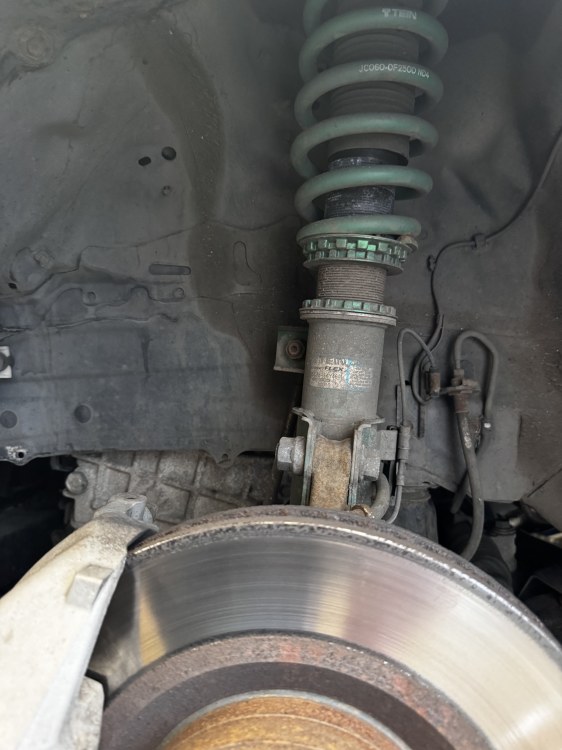

On that note, I would absolutely be looking at your front brakes - I'd bet they are not standard!! Single piston sliding caliper is the standard on the front, as well as the back!

Thanks all for your feedback back and wisdom - very much appreciated - After a lot of faff we managed to cross reference some parts and did indeed confirm the part upgrade is from Lexus LS460. Fancy. The Brembo part numbers P83059 should anyone else have the same upgrade
Front brakes are next and yes @Nev The disks are deffo vented so likely of the V8 Lexus as well.

Cracking!! Got a result, marvellous! And yeah very fancy upgrade! I hope you also managed to get the part numbers for the discs for the future!
The front discs are vented on the standard ones, but that caliper, from what little I could see of it, is definitely not!!
I guess it's a multi piston solid caliper, am I right?
