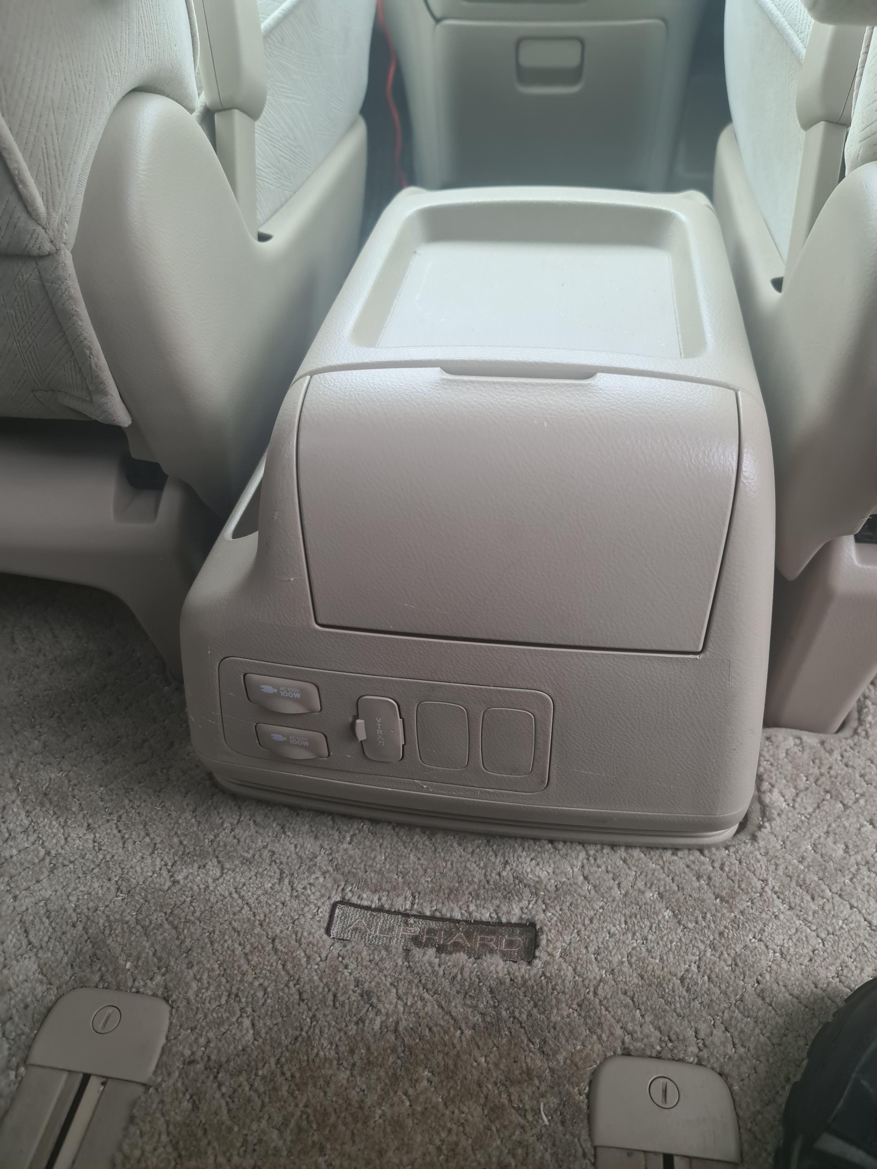

Today I removed the back panel of the centre console only to find, in true Toyota fashion, the cables for the three sockets in other models. Yippee I thought, a 12V supply that i can just tap into, but no, there is no voltage.
Does anybody know where these cables come out the other end so I can see if I can tap into them without having to remove the seat and centre console to run the cable?

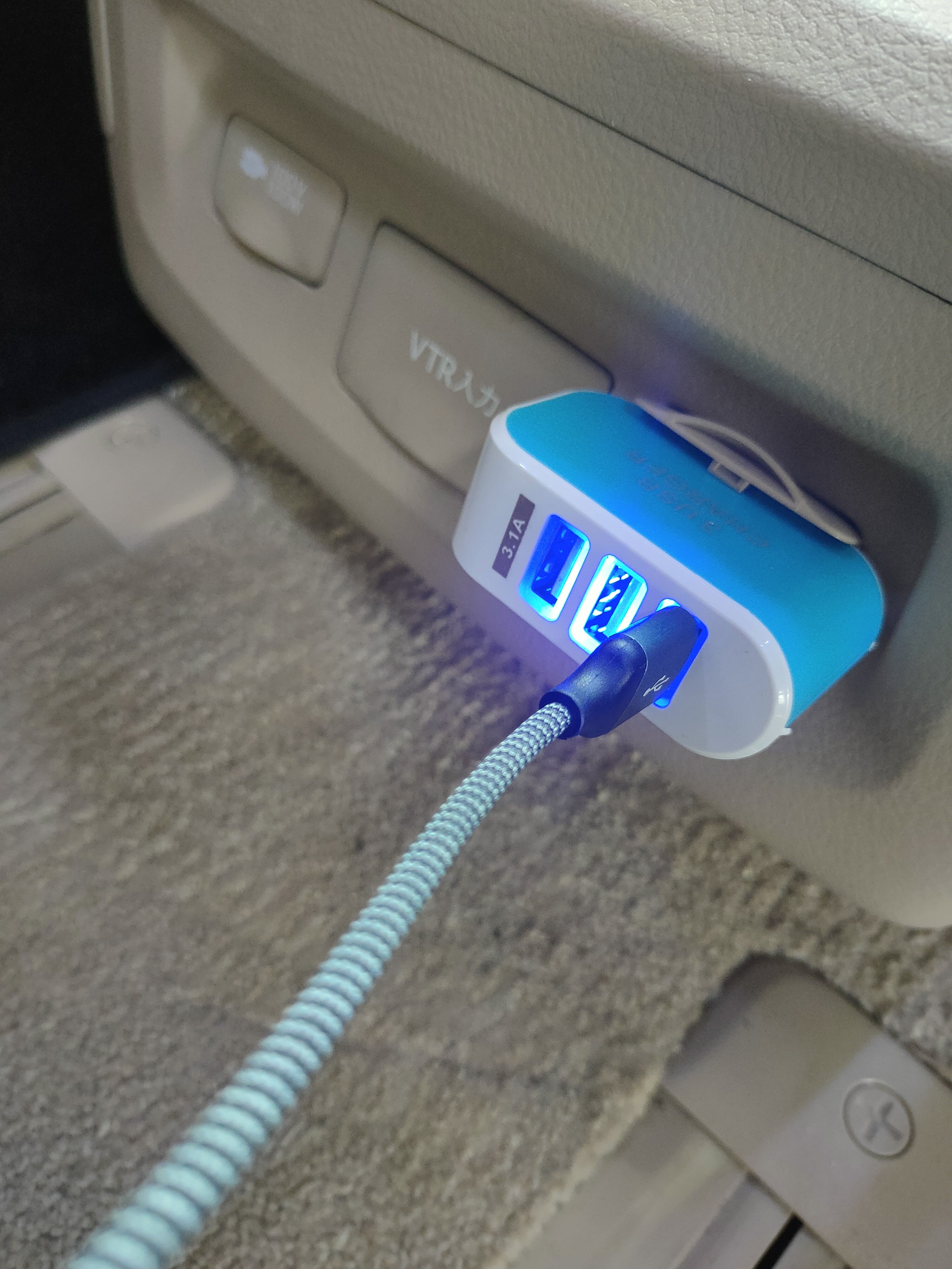

Works a treat! IMG20220908085233.thumb.jpg.b8c9ee85e46c94566e1e1ee78ee00961.jpg

That looks good, mine is a black one. I am so glad it helped with no hassle 👍

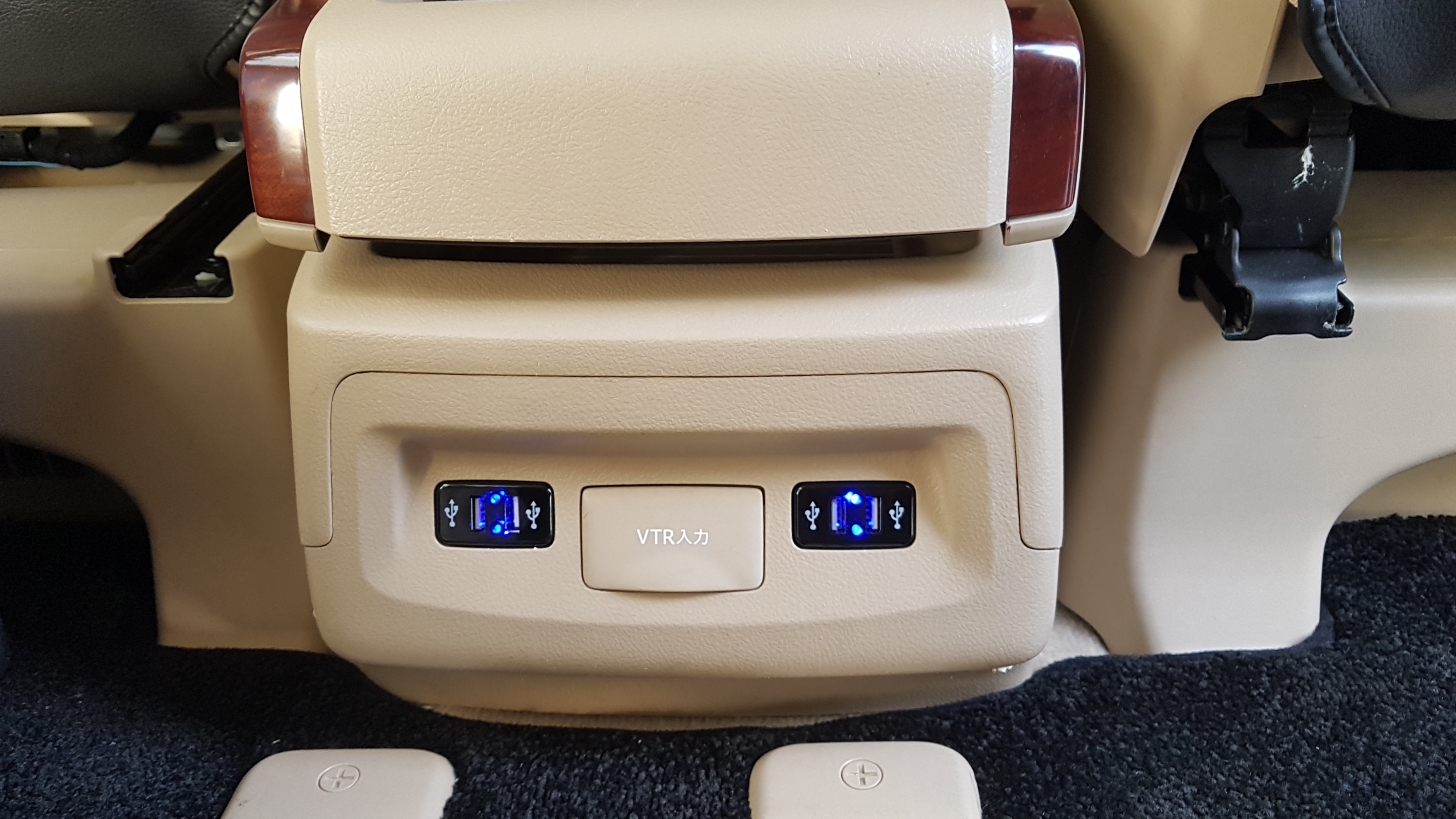

I converted all those ports by removing the converter under the center box and soldering the wires on.
Same here, the 100v Japanese power outlets were useless to me so I replaced them with 2 x dual USB outlets. They look good and most importantly, they work!
They do look really good. very professional.

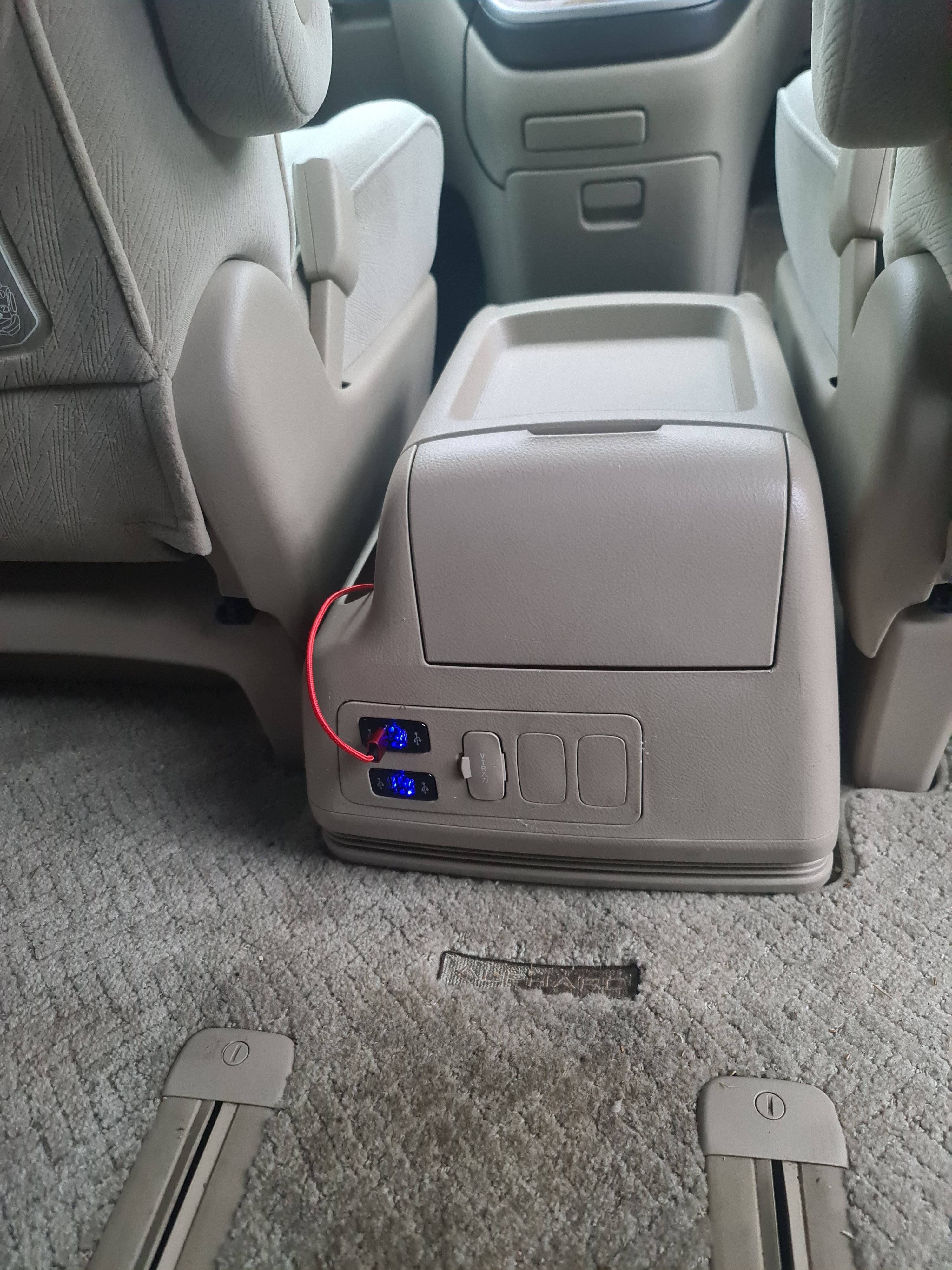

I have changed the two 110v sockets for twin USB sockets, which should come in handy. It was a bit of a pain finding ACC power but got there in the end from the parking assist socket under the passenger seat.
I tried to find the inverter for the 110v but it's not under the passenger or drivers seat.
I have also added a GPS speedo for MPH and a dashcam.
