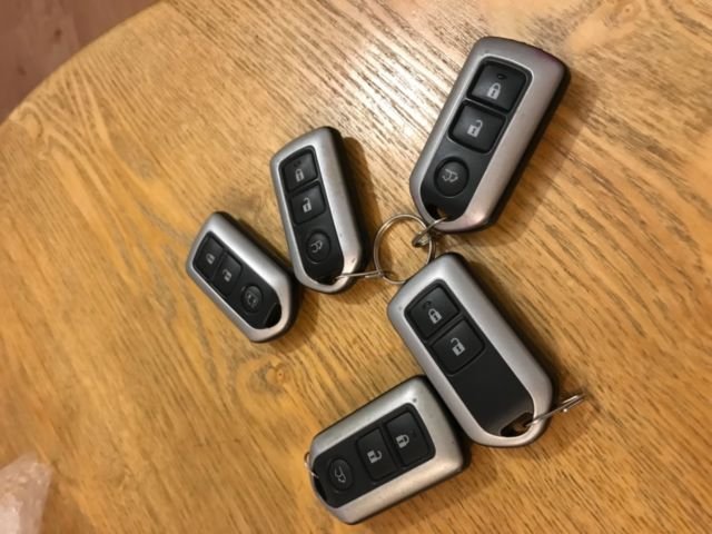

Hi,
Does anyone know how to programme these smart fobs? My Alphard came with 2 of these and remote engine start fob.  They don't work and I don't think are for my car but need to reprogramme them to work.

Awesome thank you so much 🙂 I have fixed it now just needed new battery 🙈 however my actual key is very worn so need to buy new one from eBay and reprogrammed it so hoping the above also works for the chip key
