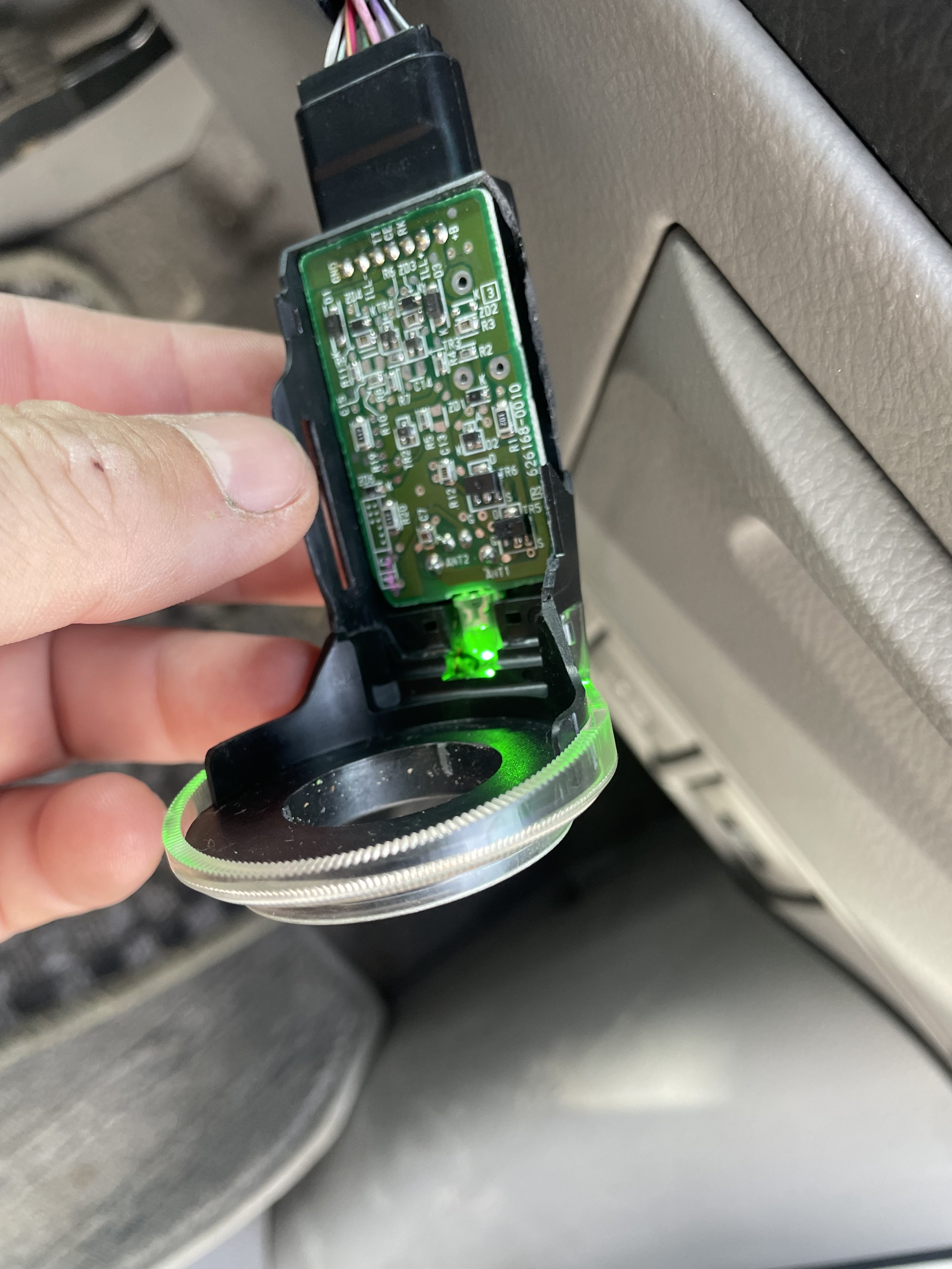

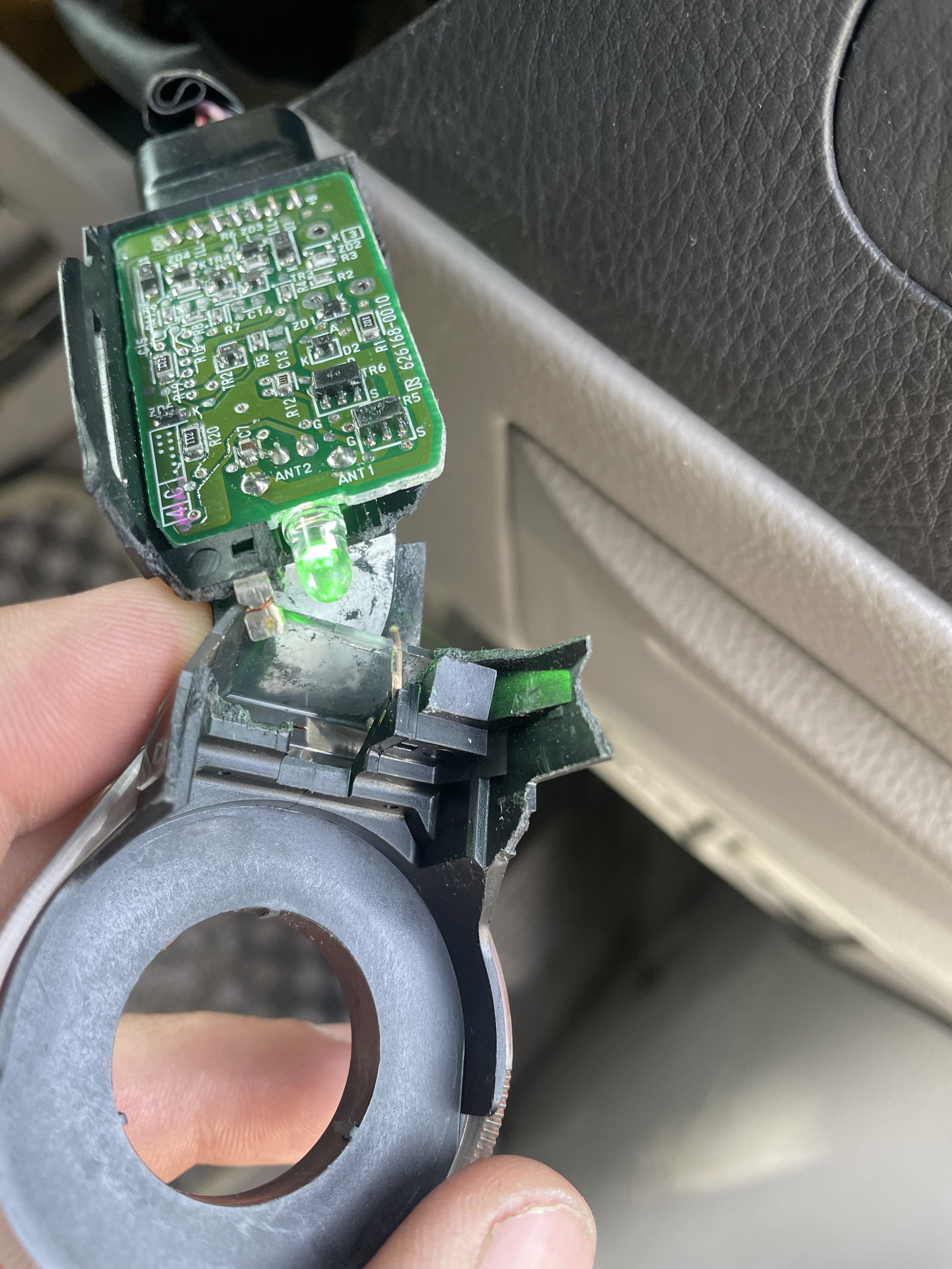

thanks. Didn’t realise this was my 1st post, been on here a while. Turns out I’ve somehow locked the immobiliser, it won’t turn off after putting the key in.
the ring round the key hole fell apart when I took the trim off. There’s a small circuit board with the green led. Is that immobiliser related? Looks like 2 connections are broken.
weirdly I don’t think the immobiliser has ever worked, never seen the flashing key light on the dash.
is there a way to sort it?
