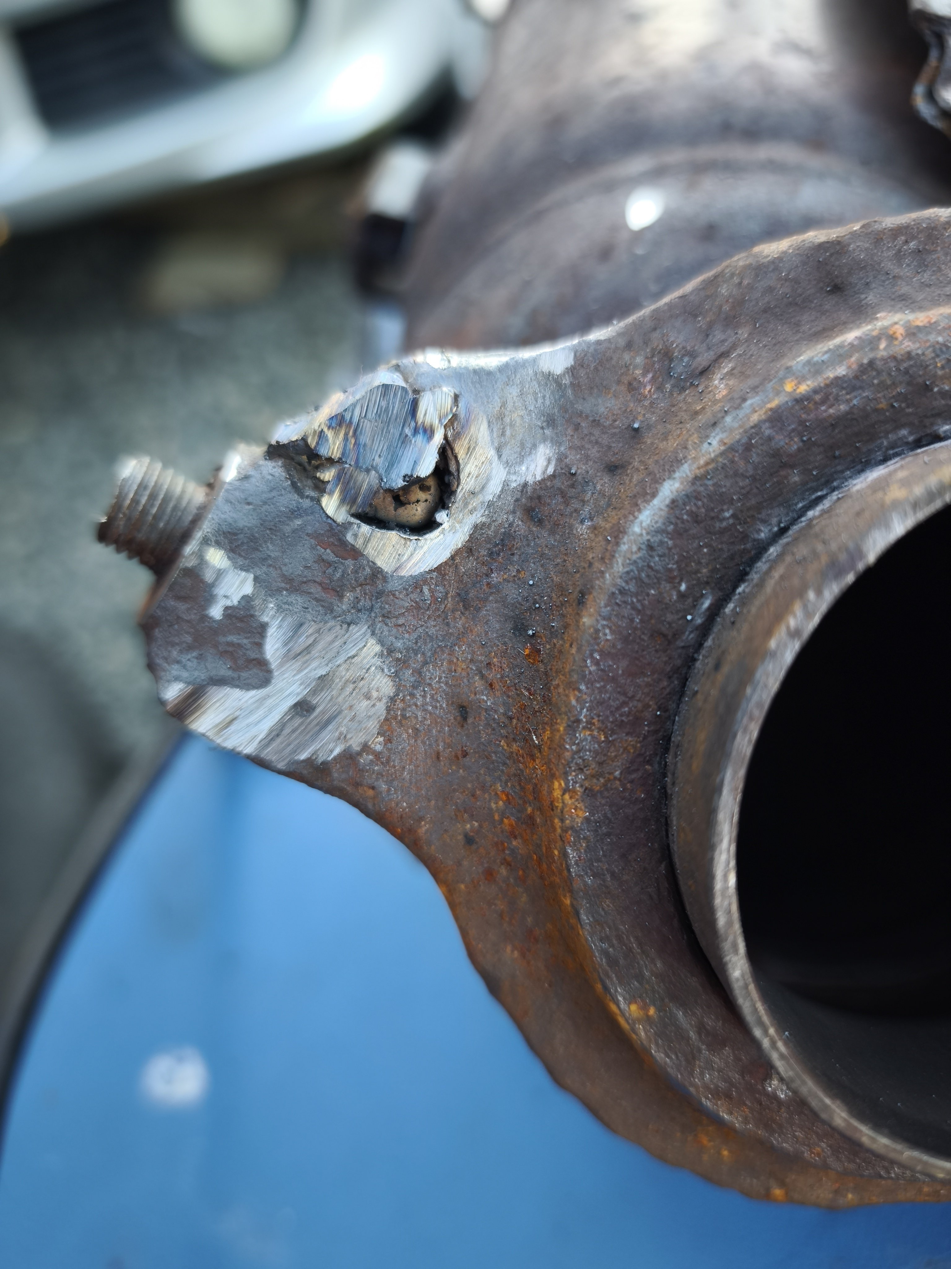

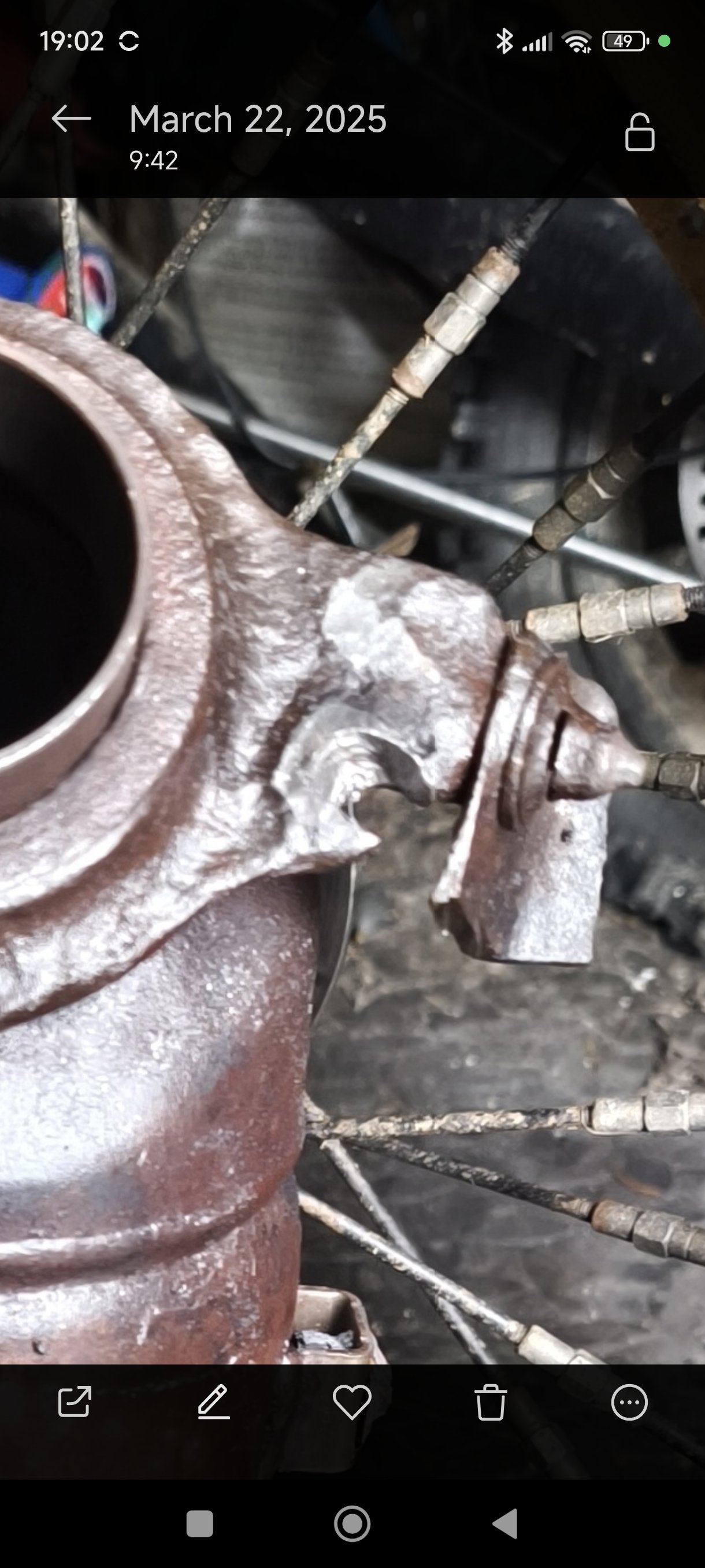

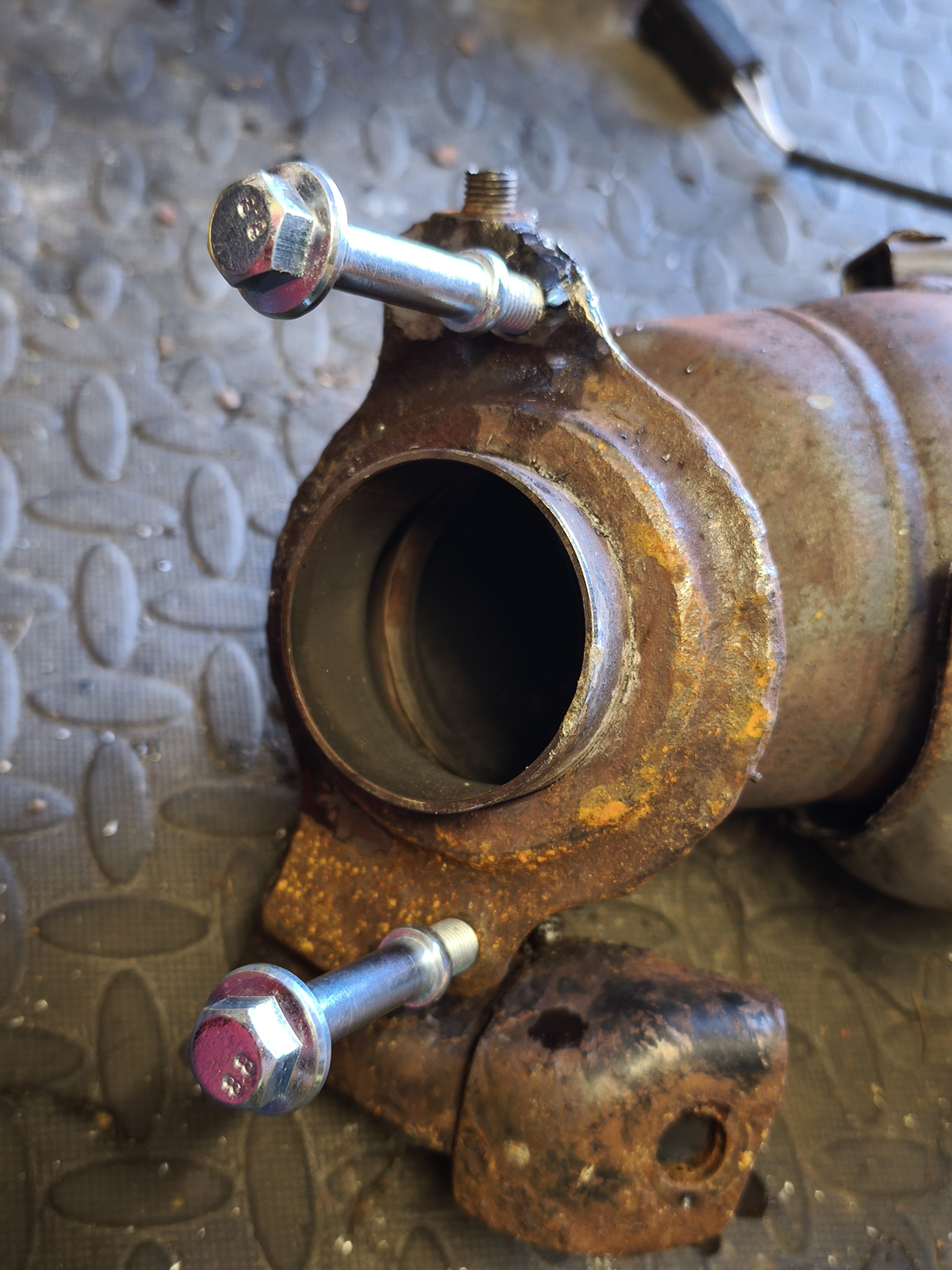

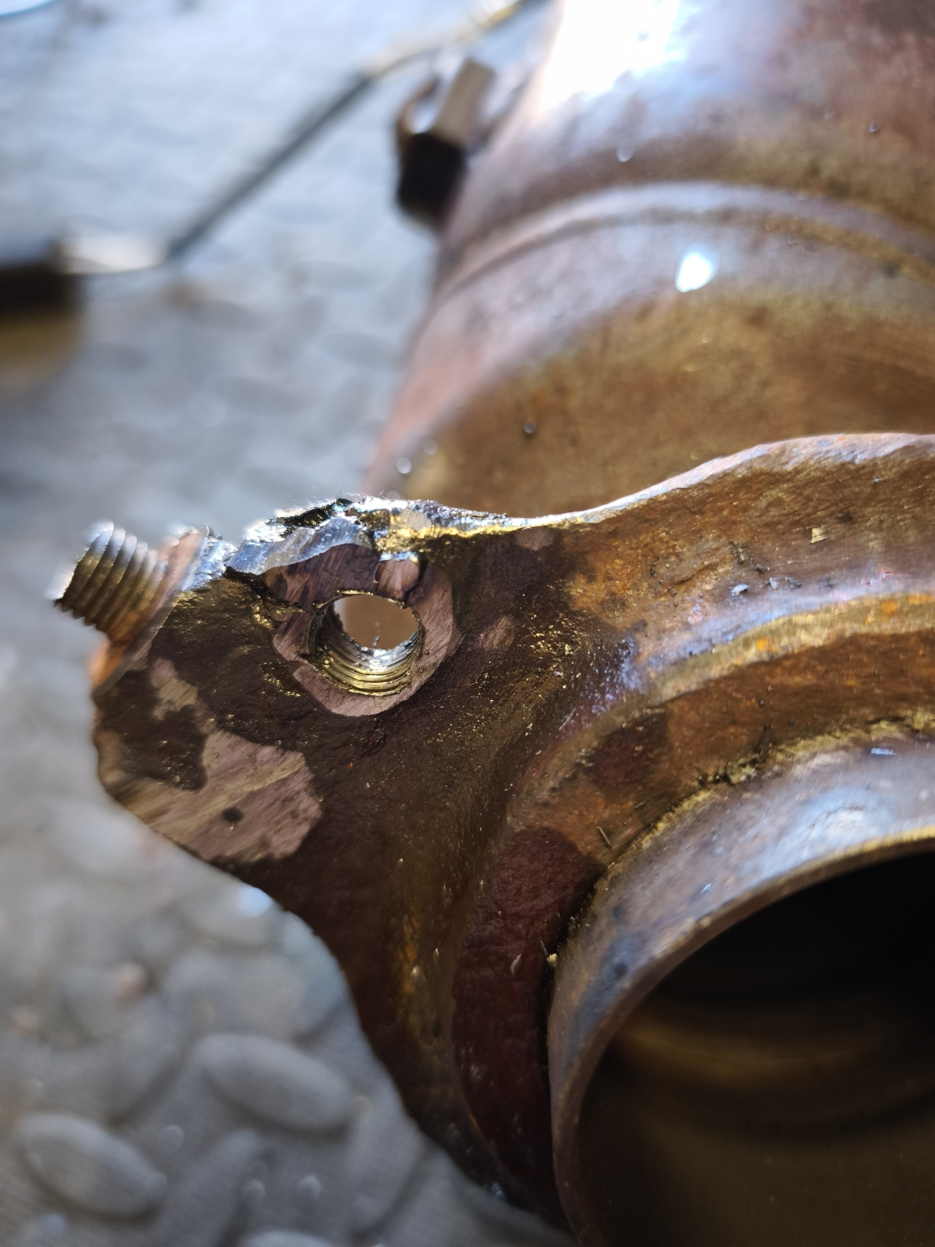

Day 20
3 hours
I'd decided to order a new exhaust manifold as I'd damaged a bolt hole on mine. It arrived today and it was the wrong one. It seems the 2005 2.4 is a different manifold from my 2002 2.4.
Mostly the same apart from a slightly different angle where it joins the exhaust and those two bolts are in a slightly different place.
So I was forced to repair my own.
I filled the hole with weld. Then drilled and tapped a new thread. Actually went quite smoothly.

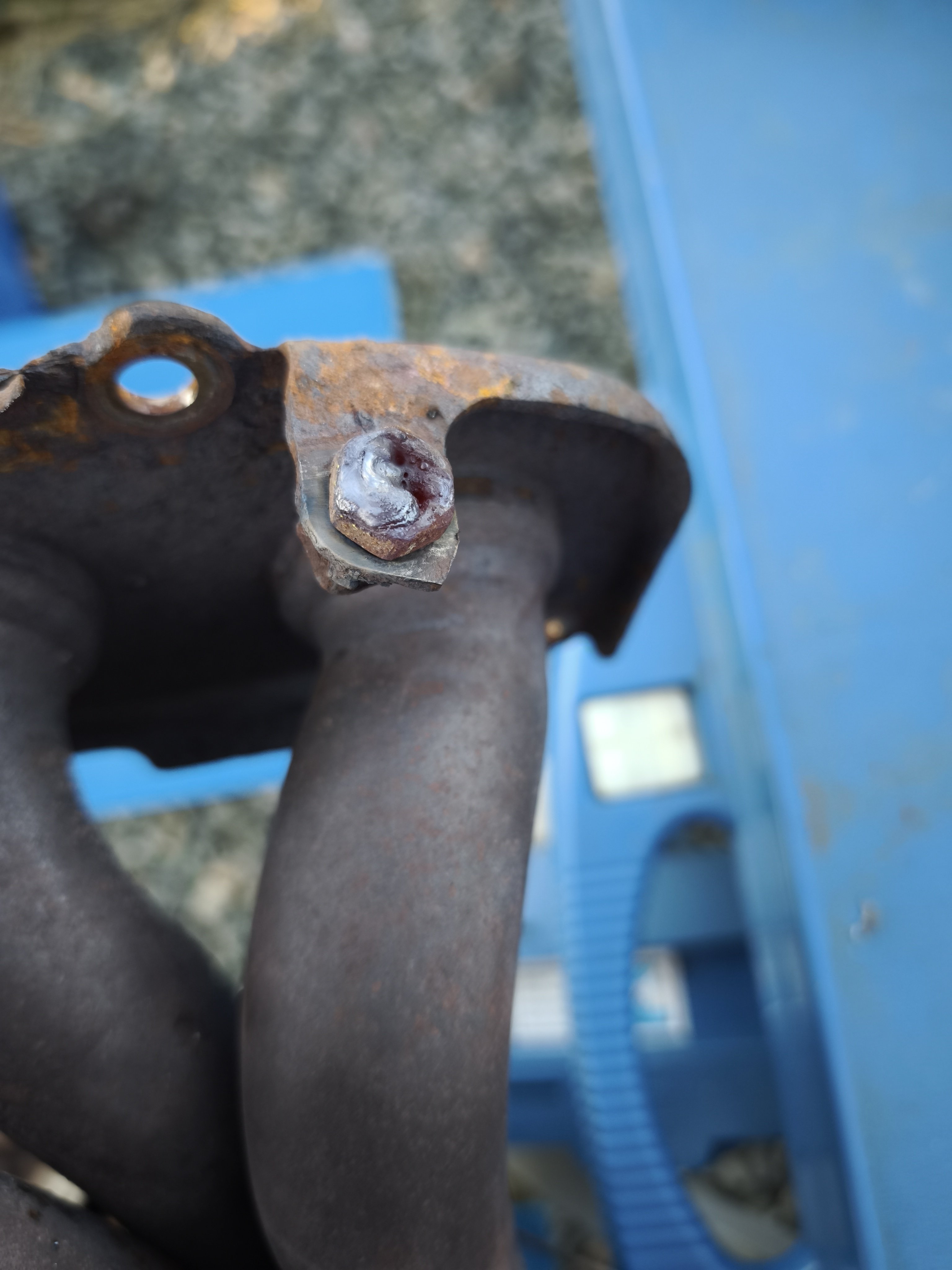

I then had to remove 3 cut off bolts from the heat shield. 2 removed and that will need to do🤣.
Installed the manifold
Filled with oil
Filled with water.
Installed battery.
I'd planned on turning over with the fuel pump disconnected but I was too lazy to find the fuse.
She started on 3 quick key turn. Hunted for about 5 seconds and then purred like a kitten.
Let it get to temperature and fans kick in. Kept checking the water.
Turned her off and checked all the levels half an hour later.
Took her for a spin and she is driving like she hasn't been off the road.
I'll add up the hours and my final thoughts in a couple of days🤣
