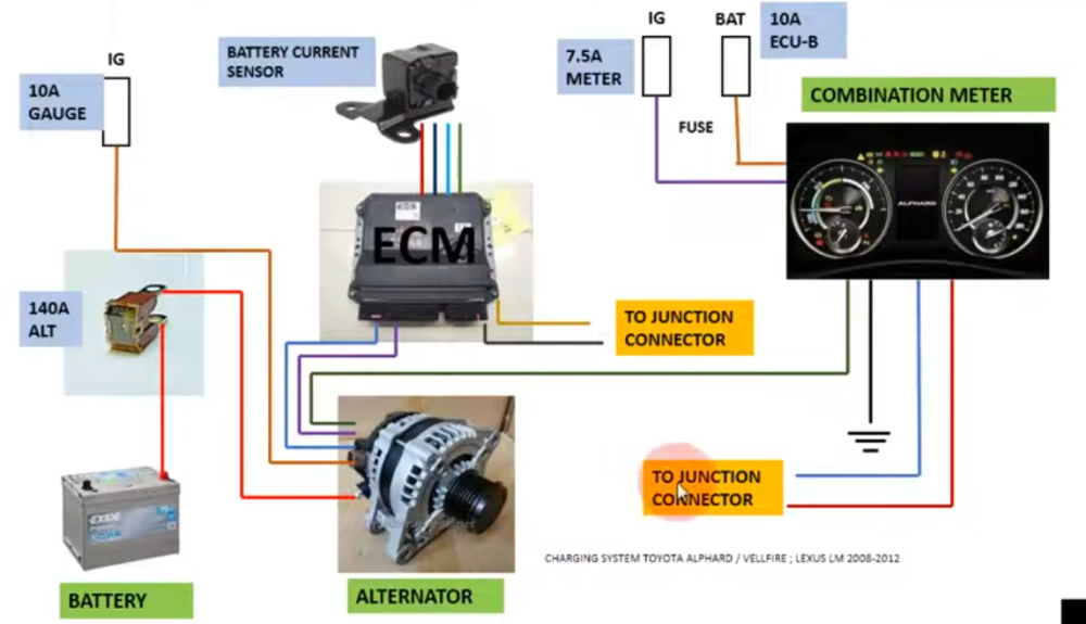

I have found this picture that goes through the connections on a 2008 - I don't know how relevant that might be to yours though. I'm sure there are better diagrams around.
